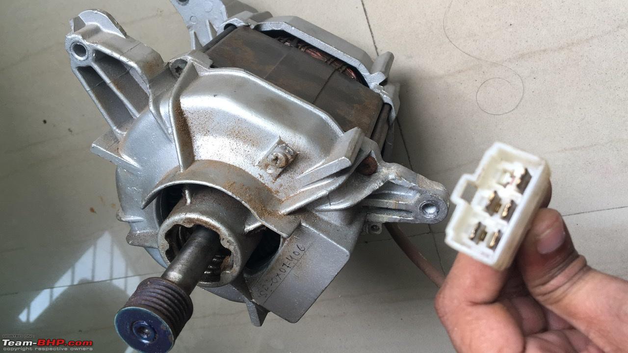

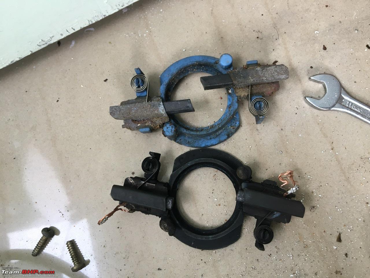

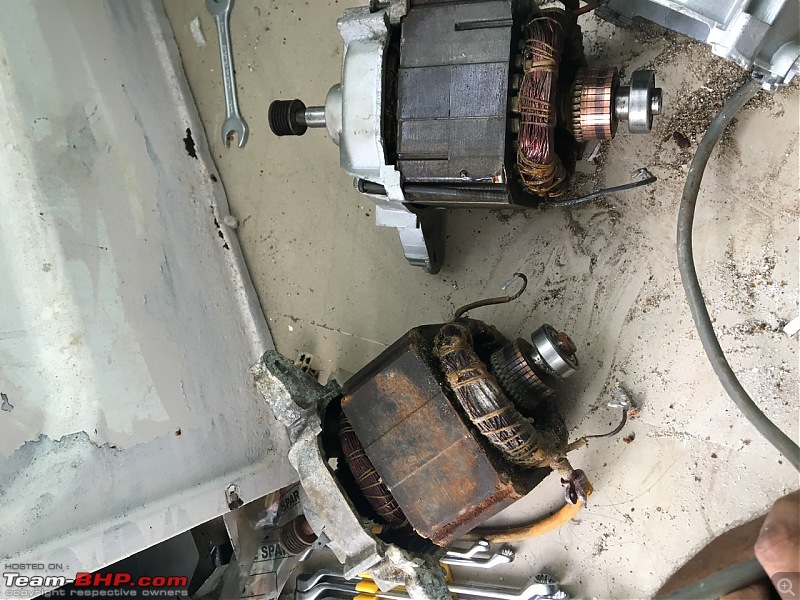

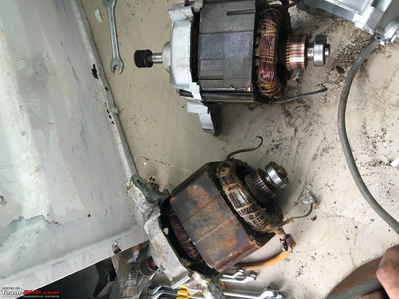

Guys, finally my IFB Washer is back in action after being in rest for almost 10 months. Just a recap, there was an issue in the motor for which the IFB service Suggested a change of motor for about 4.5K. But being a 21 year old model, they couldn’t procure the part. In the meanwhile, we got a new Bosch front loader and this machine was lying neglected in the balcony. This lockdown gave me an opportunity to take a look into the issue myself and I took the motor out. After checking it, found that all coils are fine, it was just the carbon brush that had worn down. I gave the motor to a nearby shop to replace the brushes but had a pretty bad experience. They charged me 300 bucks in name of servicing the motor. When I connected it back, there were still arcs of electricity and the state was like before only. I decided to open the motor and found that there was nothing they had actually done except for cleaning the commuter. Chasing those 300 bucks was fruitless and hence I let that be.
Thankfully, I had an old identical motor lying around with the brushes in very good condition. That became my donor. Fitted everything back and the machine is back in perfect action. The machine is now doing the duties since past 3-4 days and every cycle is working perfectly like before.
Check the photos:

Awesome job! Am envious that you did this and how did you happen to have a spare motor? I have a dish washer and a front loader washing machine waiting to be scrapped and was contemplating taking out such parts for future projects. Was thinking of a gate opener or something like that.
Thank you! The older motor happened to be replaced consequent to damage during a short transit without the transit bolts secured. It was replaced about 14 years ago by IFB service and it was kept in a bag all these years.
The front loader and the dishwasher will have a lot of parts that you may salvage. If you don’t plan to repair them, go for a tear down and salvage all electronics, controllers and motors. I recently did the same to my old microwave oven.
