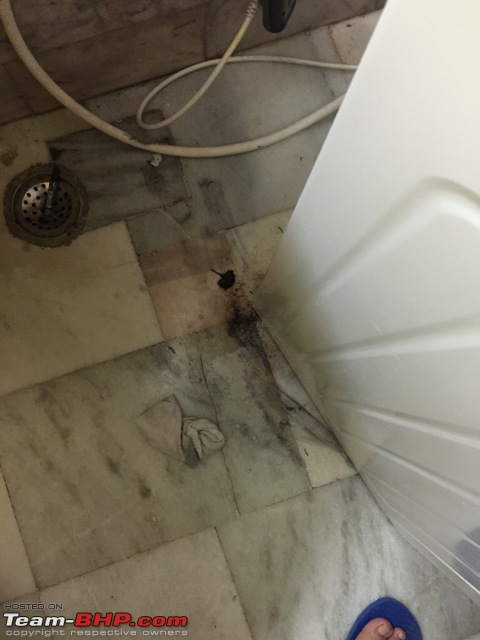

Our 5 year old Samsung front load washing machine has started walking during the spin cycle. This has not happened before. I haven't checked the alignment and notice that the walking may have worn out the bottom shoes but it started because of my wife using an extra spin cycle due to the rains. She was trying to get some extra dampness out of the clothes due to the inability to dry the clothes outside.
Do not confuse correlation with causation!
I'm betting that the locknuts on the feet may have come loose, or that the feet may have worn. It just happens to have happened now, or maybe using a faster spin speed might have helped either of those along.
Check the condition of the feet. Get the spirit level and make sure the machine is level. do the locknuts up tight, and check the level again. Try machine

thanks, I used the spirit level, tilted the machine and adjusted one of the lock nuts on the front. It seems steady and have just asked the missus to load it up. Hopefully it should be okay!

Spoke too soon, the machine has shifted and I suppose will need to look at all the 4 lock nuts little better.
However the violent vibrations have stopped as the machine seems to have found a stable position for itself on the floor. It just ran a spin and it was not rocking from side to side like it was doing yesterday.
At times an imbalanced load inside the machine may cause violent vibrations. Used to happen once in a while in our IFB. In LG WM, they have load balancing cycle before each spin which ensures practically zero vibrations during spin.

It may be different mechanism for a front-load (the drum is balanced differently with weights and stuff), but my Samsung top-load developed the same problem a couple year ago, and the issue was narrowed down to the rubber end-bushes used with the suspension springs the drum hangs by. One of the four corner ones had stuck out of position hindering the suspension spring's (vertical) movement, causing it to bump violently against the outer body during rinse/spin cycles.
The technician said these bushes have been removed from newer models altogether as this is a recurring issue, and I've never had the problem since. I also use a move-able stand for my machine as my rented house's floor isn't the flattest surface in the world, and we don't have a permanent spot for the machine either.

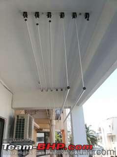

With the rains in full swing in Chennai am looking for a clothes line that I can install in my service area to lower and lift so the clothes can be out of the way. We do have an indoor drying rack but the wet clothes are piling up.
I found something like http://www.theclotheslinestore.com.a...ceiling-airer/ but seems pricey. Is there anything in our market? Will continue my search but thought will ask.
We've used 'PullnDry' - bulky contraption. You can google it. There are similar companies in every city (cost is approx 2000/- depends on the rod length etc).
Don't go for the cradle type (heavy, old type). Go for individual rods that are lowered and lifted individually (smoother, lighter).
