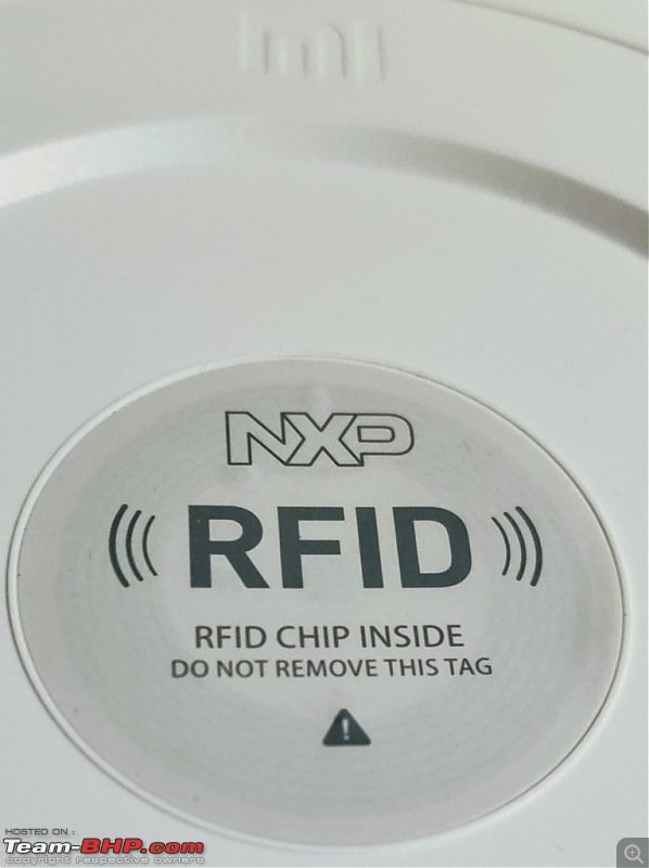

The Home Air Purifier Thread : Reviews & Comparisons-img_20201024_0136312765x1024.jpg
I guess this RFID means you can’t purchase cheap replacements or use this one forever! Xiaomi will force a new filter on you!

Interesting comparison. I was planning get Xiaomi to reduce hay fever effects but that RFID thingie has made me think. Counting hours is a terrible idea as even my car's air filter looks cleaner than an air purifier filter in Delhi. Does it not work if you re-install the filter or it gives a warning and you can make it work? What if you were to take out the RFID tag? Its headed for landfill anyway.
extreme_torque is offline   (1) Thanks

3. MI is to be avoided at all cost. I don't see the necessity of having hard plastic non biodegradable filter. This is very strange as all standard air filters used the interwoven fiber based structure . The RFID concept is ridiculous. Mi is like having a car that just wont start when it time for servicing.
One of the newly launched Mi purifiers (Mi 2C) doesn't need any RFID.
It is the bare basic model without and smart features. It only has red, orange & green LED's. I've verified the readings with second purifier and they seem quite accurate (+-20 difference).
I've seen online that you can continue to use filters as the app shows a warning if filters time out(haven't personally tested it though).
If we look at these machines, they are basically a filter + fan combination to throw clean air out.
What only matters is that the filters must be of good quality.
I find Mi to be the best value for money. They are powerful compared to competition.
I've one Mi 2S from last 3 years and is doing good. It is on the same filter that it came with. I use a pre filter so larger dust doesn't get inside. I use it only on days when levels are > 200 outside. This is approximately 1.5 months of total 'on' time every year (Oct- Jan).
