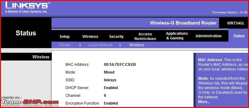

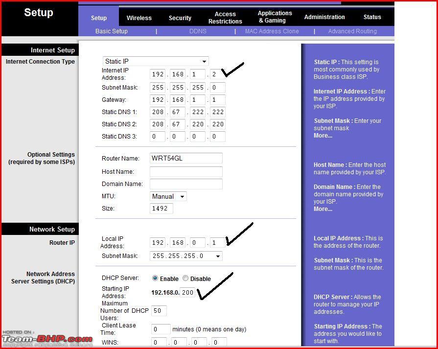

Here are the steps
1. First connect laptop directly to ADSL modem, and see everything is working fine. This connection will be done through ethernet cable, and after you connect, double click on local area network. I presume your connection is the type where when you switch on the modem, you go online, no need of dialing anything from the PC, right?
Remember the gateway address here. In my case it says assigned by DHCP. I think it will be same in your case
2. You are able to connect to your wireless router from your computer, right, so we won't bother about that, we will worry about how to connect your router to your modem
3. Forget all about advance setup. Don't touch anything, just go to basic setup.
4.Go to Page 3 of your router manual, and select Internet connection type -> Automatic configuration(DHCP)
There you are done.
Since you can connect to the router from your laptop(you can do that, because if you could not, how would be setup the router ), with automatic configuration your router is not connected to the ADSL modem.
Now suppose things are not working, then there could be only one fault. Your ADSL modem does not have DHCP on.
No worries then. Just go to Internet section on Page 4 and select "Static IP"
In the internet IP address put in the IP Adress which is in the "first screenshot"
In the gateway put the "Default Gateway address".
Thats it, you are on and live. In the DNS servers put in the DNS servers I gave you. Simple

One thing I forgot.
If ADSL modem gateway address is 192.168.1.1 then set the router gateway address is 192.168.0.1 and vice a versa.
Now how do you set your router IP address to 192.168.0.1?
Well simple, open Page 6 of your user manual, on th left you will see Network setup.
Just set router IP to 192.168.0.1
Enable DHCP server and set
Starting IP address is 192.179.0.2
tsk1979 is offline

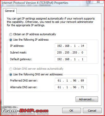

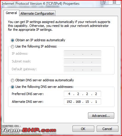

Hello Gents,
I am having some issues with my home network and I hope that you can help me out here.
Let me explain to you my setup first.
BSNL is my ISP and I use the DataOne 2MBPS Unlimited Connection.
As you can see, I have hard coded my modem so I can use multiple connections in the house without having to dial individually from each computer.
I have one Win XP desktop which is connected via USB which is right next to the modem in Room 1
I have 3 Vista laptops that are wireless and can also be connected to the Linksys Router in Room 2
In order to use the Huawaie wireless modem, I need to assign the laptops with the default BSNL IP. When I do this, I can get the laptops to 'talk' to the wireless router in Room 1 succesfully. My Linksys router has also been configured with the static IP and auto DHCP so it can talk to the laptops. Here are my problems:
1) I cannot access certain websites such as IMDB.com / Citibank.co.in and Cleartrip.com etc. This is strange because I can access other sites such as TeamBHP / Google etc. at the same time. Is this a setting issue somewhere or is BSNL blocking these sites? It just goes from "Waiting to Website to respond to Windows live Search."
2) My linksys wireless router connects to the BSNL modem fine for about 10 to 15 minutes and I can go online, but after that, it just drops the net connection (But still connected to the router) and I get the "Connected with limited access" message. The same happens when connected via ethernet to the router. Also the linksys is setup to handle Vonage VOIP and I get my US dial tone for a few minutes and then it drops. Reset the linksys and I can then use both the Internet and US phone for a few minutes.
3) Since I have two wireless hotspots and routers, I need to have two different IP's configured in my laptops.
This is the one to connect to BSNL
and this is the one to connect to Linksys
As much as I have tried, I cannot store both the IP's on the same laptop and have to reconfigure them everytime I need to connect to either router.
So any soultions to these 3 problems of mine?

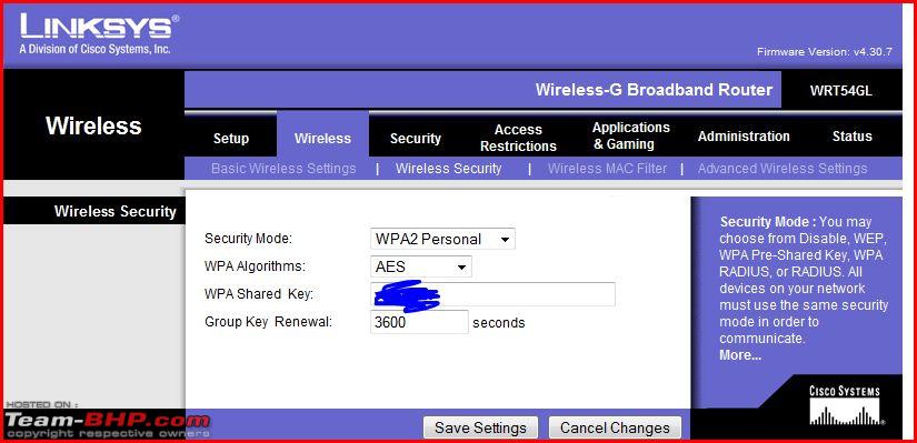

Just take screenshots of all config screens so that if you have a "reset moment" you can just go back without issues.
Apart from two screen shots in my last post,rest are below.

Originally Posted by vcash View Post
1) I cannot access certain websites such as IMDB.com / Citibank.co.in and Cleartrip.com etc. ...
2) My linksys wireless router connects to the BSNL modem fine for about 10 to 15 minutes and I can go online, but after that, it just drops the net connection (But still connected to the router) ... Reset the linksys and I can then use both the Internet and US phone for a few minutes.
3) Since I have two wireless hotspots and routers, I need to have two different IP's configured in my laptops. ... As much as I have tried, I cannot store both the IP's on the same laptop and have to reconfigure them everytime I need to connect to either router.
1. Is it that you can't access these AT ANY TIME?
2. Could possibly be a "noisy" phone line which is causing intermittence. Should be possible to check the noise level via the Admin screen of the modem
3. You see the "Alternate configuration" tab in your last pic? That's where you set the second IP address (but this would be used in the either/or fashion, I think, i.e. use the second if the first one is not available). Or, click 'Advanced' and add the second IP address. 'ipconfig /all' on the command line should list all the addresses set.
You should preferably use two different series associated with the 2 sources, e.g. 192.168.1.xx for one, and 192.168.2.xx for the other. This way there will never be a confusion. Each PC/laptop can have more than 1 IP address; the individual routers figure out how to handle traffic on the same physical LAN.
Originally Posted by tifosikrishna View Post
... in spite of giving the SSID and passkey, my laptop fails to recognize my network. ...
This is *really* intriguing. I think a good network admin guy should look at your setup physically.
Try this: Right click on the wireless network icon in the System Tray and select 'View Available Wireless Networks'. Under 'Related Tasks' in this screen, select 'Change advanced settings'. In the resulting window, select the 'Wireless Networks' tab.
* Check the box "Use Windows to configure my wireless network settings"
* If your wireless network SSID does not appear in under 'Preferred networks', add it
* Under 'Advanced', check the box "Any available network (access point preferred)"
* Under Properties of your preferred network >> Association
- Check "Connect even if this network is not broadcasting"
- 'Network Authentication': Open, 'Data encryption': WEP
- 'The key is provided for me automatically': unchecked
- Your WEP key entered in the 'Network key' (and 'Confirm network key')
- Key index: 1 (I hope the Wireless router does not have an automatic Key index cycling feature. Could you please check?)
* Under Connection tab, 'Connect when this network is in range' should be checked
Fingers crossed - try maadi! From the Mac, perhaps you could glance through the settings on the Wireless Router to see if there is anything that is inimical to the Windoze box settings.
