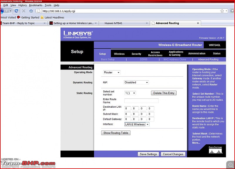

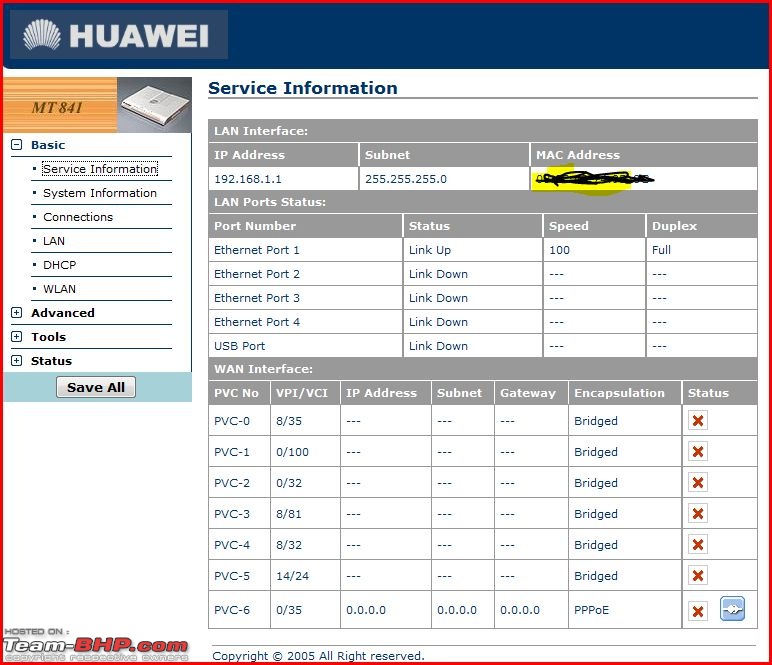

Doc, when you connect your laptop to the BSNL modem, do you "dial in" from your PC to connect to the internet, or do you just switch on modem and you are "online"?
I just switch on the ADSL modem(Linksys router before this problem) & wifi switch on laptop and i am "online".
Originally Posted by DerAlte View Post
Your first pic shows "Access: Local only"! This should mean you have told the router not to connect to the Internet.
Unless you are trying to connect on-demand ONLY, Internet access should be achieved by simply setting the Gateway setting of the computer (under IP settings) to the IP address of the Linksys box, usually "192.168.0.1" or "192.168.1.1".
Are you able to see the admin page of the router in the browser (not via the program that runs off the CD)?
yes,i can open the admin page when i connect router to modem+laptop(wired) and i can turn turn on DHCP and some some other changes like MTU.
Originally Posted by greenhorn View Post
a bit OT : you bought a WRT54GL and you're running it on stock Firmware
I have heard some great things about DD-WRT but router is doing such a nice job with its stock firmware that i dint want to take any "panga".I have never had any trouble with either BSNL,ADSL modem or Linksys router so far and speeds are just great.

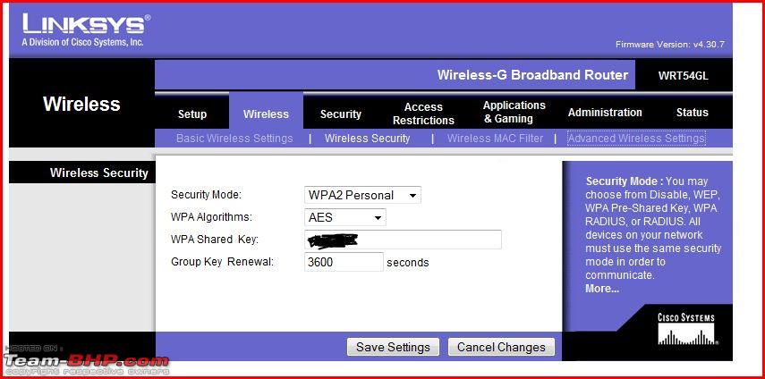

1.BTW as you can from pictures,both router and modem has same IP address i.e. 192.168.1.1.Could this be the problem?If yes which one to change and how?
2.I am confused between security key,paraphrase,password which are asked many times while settings wirless connection.Can someone help me here as well.
I have done many hard resets and still problem is same except today when i was able to get congratulation message window of linksys CD wizard as you can from the pic.
I have posted the pics acc. to time taken while doing all this all over again.

Since your Huawai modem is connecting to the internet you have to select "router mode" and not gateway mode.
the connection will be as follow
ADSL modem(huawai) will connect to internet
Linksys will connect to Huwai at one end and your PC through wireless.
Wireless connection is working, somehow Linksys to Huawai is not working.
Also set these DNS servers in your wireless connection
208.67.222.222 208.67.220.220

All you need to do is connect your Wireless LAN router to Modem Router without using PPP-OE
As far as I understand you want to use both Wifi and USB port on Huaweii Modem- Router with out any additional investment in installing a PCI ethernet card in your Old PC , It is quite possible
Actually your Huawei Modem is Modem + Router with two ports one USB and one Ethernet port. So it can accommodate 2 connections at a time.
Also this modem router has DHCP server with table size of 64 built in so in case you connect a hub to the ethernet port you can serve up to 64 Computers.
In order to use a wifi Router This is what you need to Do.
1. Login to settings of your Huawei modem ( http://192.168.1.1 ) and set up DHCP in your Huawai Modem / ROuter and select the range of IP
as some number say 192.168.1.2 - 192.168.1.11
This is the range of IPs from which router built in your modem will allocate IPs.
2. Enable DHCP client in WiFi ROuter as well and choose another range of IP address
example
192.168.2.1 - 192.168.2.XXX
3 Make sure that Wifi router setting is not in PPPOE mode but in normal mode
( default setting on most routers)
3. Take a CAT cable and plug in your ethernet cable out from Modem Router to WiFi Router WAN port
Now this configuration is equivalent to two routers connected back to back , you can connect your Old PC with USB to modem router and it will get one available
IP from Modem routers DHCP table that is in the range of 192.168.1.2 - 192.168.1.11
and connect your laptop to your home WiFi network and it will get an IP from DHCP of WiFI ROuter that is in range 192.168.2.1 - 192.168.2.XXX
Also Please make sure that you enable WPA or WEP security in your WiFi network. May be MAC filtering for your devices as well.
Recently terrorists used an unsecured WiFi network of an Amrican national living in Navi Mumbai to send e-mail and he was in soup.
Regards
Amit

* I need to check what I did on my D-Link WiFi box, maybe I set 192.168.1.254 to keep it safely out of the way. Allow the Huawei to be the "master", i.e. DHCP server, et al, and have 192.168.1.1 as it's address
* You will need to set 2 things on the Linksys for your wireless network: the "name" of your network, and the password / WEP key that any WiFi client must provide for access to be granted. Do it via the Admin screen of the Linksys box in a browser. WRITE IT DOWN SOMEWHERE (if possible in the manual itself) so that you don't forget it. (When you connect to "name" from your laptop, you will be asked to provide the password / WEP key. This needs to be done only once, I think - it is possible to declare it as a "preferred" network)
Since your Huawai modem is connecting to the internet you have to select "router mode" and not gateway mode IN THE LINKSYS BOX.
Linksys will connect to Huwai at one end (via LAN cable) and your PC through wireless.
Also set these DNS servers in your wireless connection 208.67.222.222 208.67.220.220
^^^ Not in the Linksys, but in the Huawei box which is the DHCP server, so that the DNS is set in the laptop when IP address is granted.

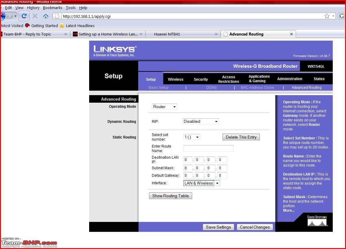

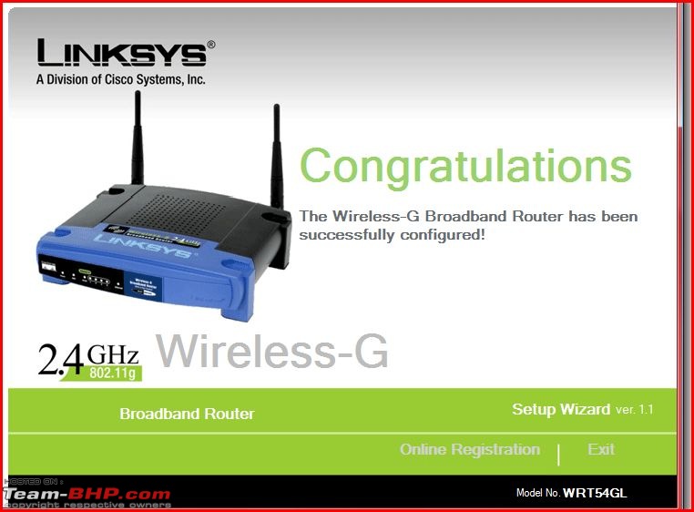

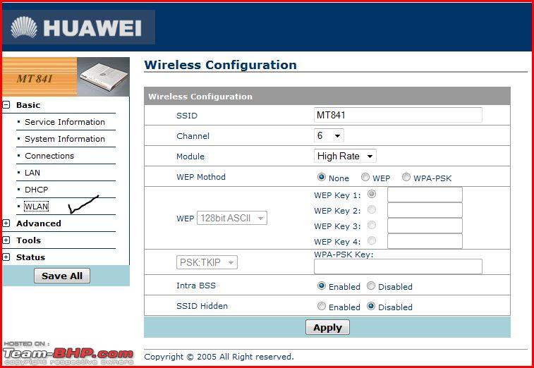

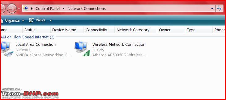

I am still not able to resolve the problem and almost every time problem is same IMO.
Can someone please guide me how to do it from scratch step by step.
BTW i am posting few pics of my numerous attempts of amking my router work.
