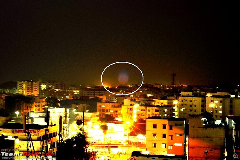

One quick question for the more experienced people here, I recently bought a Nikon D90 and a Nikkor 50mm f/1.8D. I have been experimenting a lot with them. recently I noticed a kind of blurr that comes up when I am pointing the lens towards (not directly, slightly offset) a light source like a tube-light, sun, street lamp. What could be the reason for the same. I have cleaned the front and rear of the lens with no success. On enhancing the color and contrast this blurr looks like a heptagon/septagon, is it something like a refraction from the internal lens blades because this lens has 7 diaphragm blades This blurr appears almost exactly in the middle of the frame
I am attaching the picture with the blurr in white circle, please help.

It is the "lens flare" you are talking about. This happens when the lens face a bright light source.
In the below shown pic, it is happening due to that light source I've circled
You've got one of the best camera body and a wonderful lens in hand, so there's nothing to complain about its capability.
So you can stop cleaning the lens

Is it seen even in snaps taken in day light too? if yes, then get it checked at Authorized Nikon Service station in Hyd.

This is lens flare from a bright light source , You see the lens flare in Heptagon / septagon shape becuase that is the number of blades your lens aperture has ( A cheaper lens will cause pentagon if it has 5 blades). This flare is caused due to internal reflections with in the lens.
One method to reduce flare from the light rays entering from side is to use lens hood but in the case of picture you have provided there is no obvious method as lens hood can not cut the light source , It is night image and polarizer filter is of no use either.
Multi coating on the lenses is done to cut the internal reflections and thus flare. One method to cut flare is to use more expensive lens with more number of blades in aperture and better coatings.
If you have seen my last post of another discussion on Nikkor lens , there are few 30-40 year old lenses which sells for more then cost of a new lens today and this is exactly the kind of scenario where they score. So thanks for posting this image sample
Photoshop / GIMP is the best bet to remove it without breaking the bank.

Asif Bhai....who is complaining about the capability of the body/lens??? this was a question from a person new to the DSLR world..simple

I didn't notice anything in day light pics, but yes, at a certain angle it does come up if I click with Sun light falling from an angle
