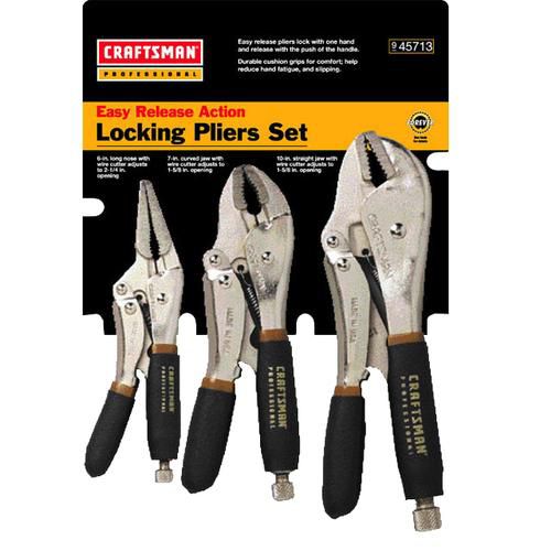

@Omishra - you got me confused initially, but then I Googled to get the right spelling.
How about using a Lock Grip Plier to unscrew the stubborn screws/bolts? I don't know about its real usage & hence seeking an opinion. Any information on this is highly appreciated.

I started off with 8mm wrench, moved to plier & finally got into this rounded stage. I even took it to local garage & they used up this locking plier without any success. So using anything more will shave off the metal more.
Originally Posted by DerAlte
Better would be if you have locking pliers
I tried this even at a mech workshop using locking pliers, but they couldn't & they gave up since they were afraid if they might break up
