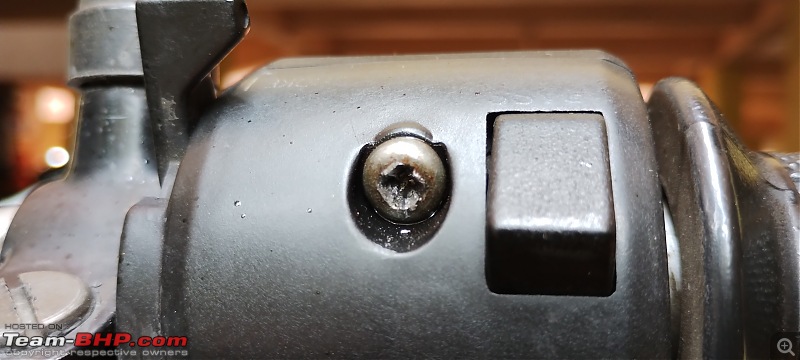

Last night I failed to open a screw of my Pulsar and in the process have made it all bald. I guess impact drivers are the way forward.
Will an impact driver actually help here?
Can you post a photograph?
I had visited the local servicing guys earlier today and requested them to try and remove the screw. I guess the screw is more screwed now. I have been suggested to break the panel as there is no way (per them) to open this philips head.
Firstly I do not want to part pieces from my beloved and secondly, even if I have to, I have to first ensure if a brand new LH switch panel of such an old model will be available.
On a lighter note, the last week I replaced the shock absorbers and a few cables, and nothing came from Bajaj. In fact the choke cable is from a company I have never come across, but this had to be replaced and it's this particular one whose fitting is now stuck at the panel end
I have tried the superglue method, and that worked for me. There are many ways. Use the search term "how to remove a stripped screw"
https://www.ifixit.com/Guide/How+to+...ed+Screw/13213

Here are steps
Procure screw extractor of the correct size
https://www.amazon.in/3mm-Screw-Extr.../dp/B079N3YCYM
. Choose the right size and drill a hole in the screw.
. Now screw in the extractor (counter clockwise)
The extractor will grip the damaged screw and slowly unscrew it.
https://www.amazon.in/YADAV-3-10mm-D...strial&sr=1-39
This one has 2mm for smaller sizes
