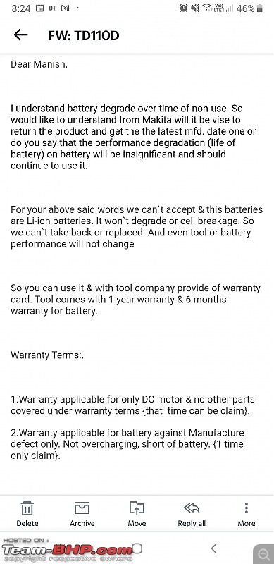

Makita TD110 was available for 7200 ruppes on amazon but 2 times I got Feb 2019 manufactured ones so Battery is for sure gone (correct me if I am wrong).
I asked Makita and they gave very dumb reply as below -
I am not sure what you mean by gone for sure. Do you mean unusable? A key parameter for Li Ion battery is number of charge cycles. This parameter would be fine if the product is new. I bought a DeWalt in 2017 but did not really start doing big DIY projects till the pandemic. I see no noticeable difference in the battery performance.
That said, it is a good idea to have a third bigger battery. Buy a larger battery separately (with remaining charge indicator). If you are going to work on a big project all day, it sucks to have to stop to charge. For this bigger battery, you can look for a more recent date of manufacture.
I too would prefer a battery manufactured within the last year, but if I cant find it, I would be fine with the one from 2019 (- if it means that I can start on my project immediately).
No the battery and the tool is working fine, but battery do degrade over time and 2 years is a lot of time. I do not know exactly how much would be % drop in useable life but it will certainly be there and with my kind of intermittent usage it will only worsen the battery life.
Also most starter packs come with 2 batteries and for my kind of use will suffice for the moment but yes we can purchase bigger ones later.
