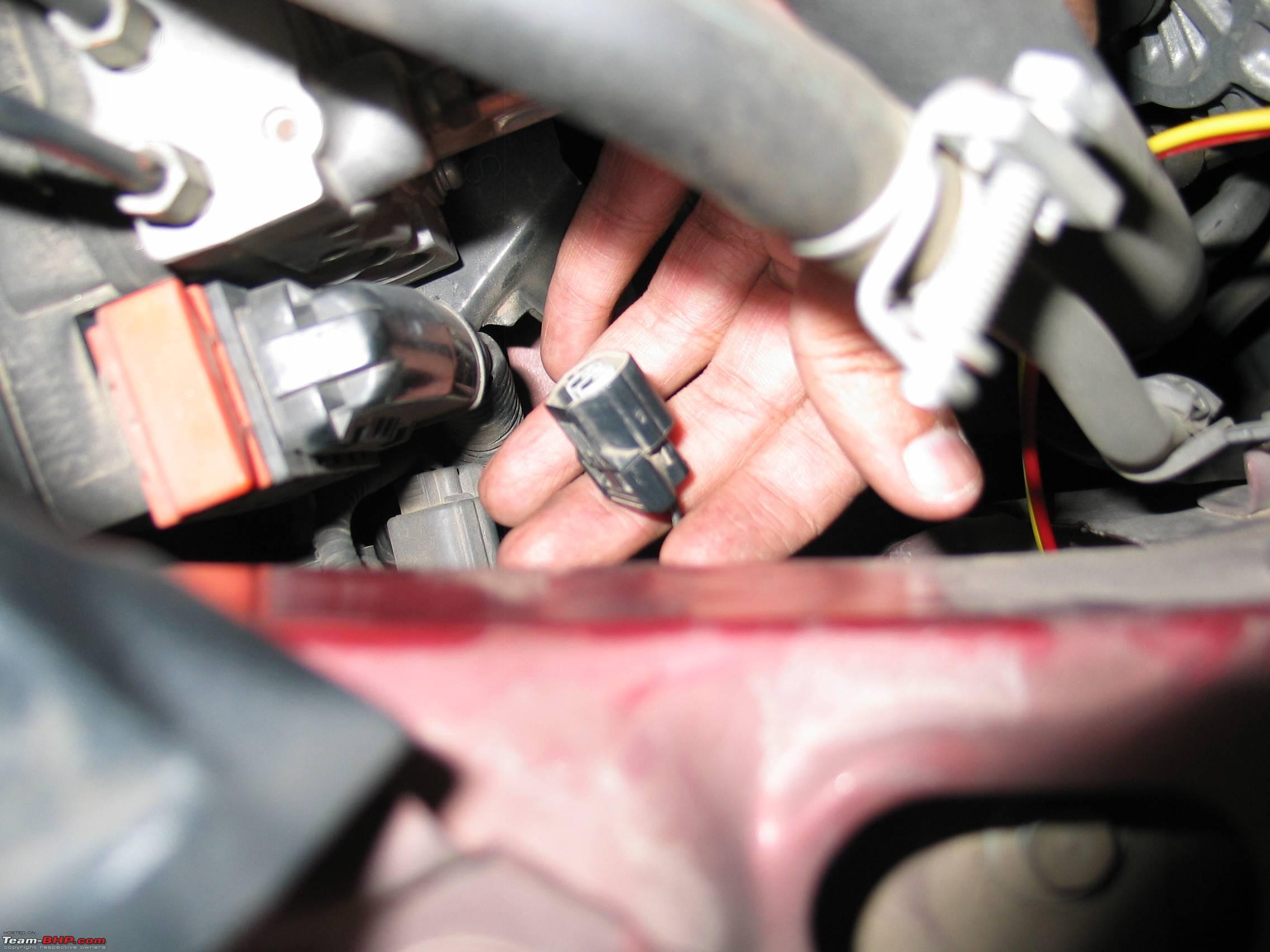

Finally managed to complete this DIY in 4 hrs flat today. Had purchased the LED strips from Ebay. There was bit of heartburn to cut the original wire of my Civic - I tapped the power from the parking lights so that it comes on when the park lights are switched on. Decided to fix the strip as an L shape on the lower side of the fog lamp. Used good quality Finolex wires and used connectors for connecting the wires. Overall I'm satisfied with the end result. Have a look at the photos

Thanks, total cost
LED Strip 2 Nos - Rs 350
Wiring, connectors, insul tape etc - Rs 50
4 hrs time - whatever I'm worth

First, congratulations on a well executed job. The results are fab.
But I guess you are better off solderring the wires and shrink wrapping them rather than using open wire connectors. Please do consider weather-proofing the connections. Over time the connectors will gather dust and grime which is the ideal recepe for a short circuit. If you are lucky you'd just escape with a blown fuse but things could get relly nasty.
