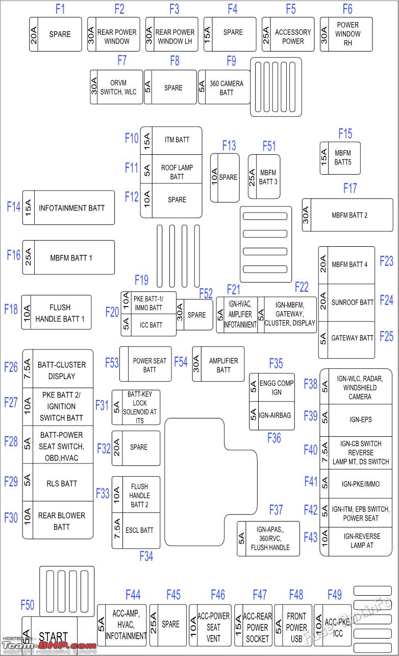

e. The final and most crucial step would be figuring out the fuse-box. There is very limited information available online on the XUV700 fuse-box. Nearly every tutorial seems to recommend using an existing fuse and piggy-backing the dashcam wiring on one of them. They recommend to use the "less critical" fuses that will likely only damage minor functions of the vehicle in case of a malfunction. No prizes for guessing that I had a MAJOR problem with this approach. This car is infamous for having way more tech than it can handle and is often maligned for its unreliable electronics. Did I want to add more masala to this piri-piri eye-wash? No sir. I did not want to touch the existing fuses if I could avoid it. Let sleeping dragons sleep.
Funnily enough, in the owner's manual, Mahindra has very helpfully marked many fuse slots with the word "spare" but somehow none of the installation guides recommend using one of these. Logic dictates that if it's a spare, it's not connected to any essential system, and is just an empty power source begging to be used! I have a kink for logical things, so I was willing to pursue this further. Unfortunately, Mahindra does not mark these spare fuse slots with BATT or ACC - to differentiate between which ones were permanently powered vs those that were only powered with the car turned on respectively. I would have to figure this out myself.
DIY: Hardwired Dual-Channel Dashcam installation, with 24-hour surveillance (XUV700)-mahindraxuv70020212023_in1fuseboxdiagram.png
A basic Multimeter from Amazon, 25 odd minutes of "how to use a multimeter" on Google, and some testing on random household electronics (that didn't cost Rs 30 lakhs) convinced me that I had enough basic knowledge to take on the challenge.

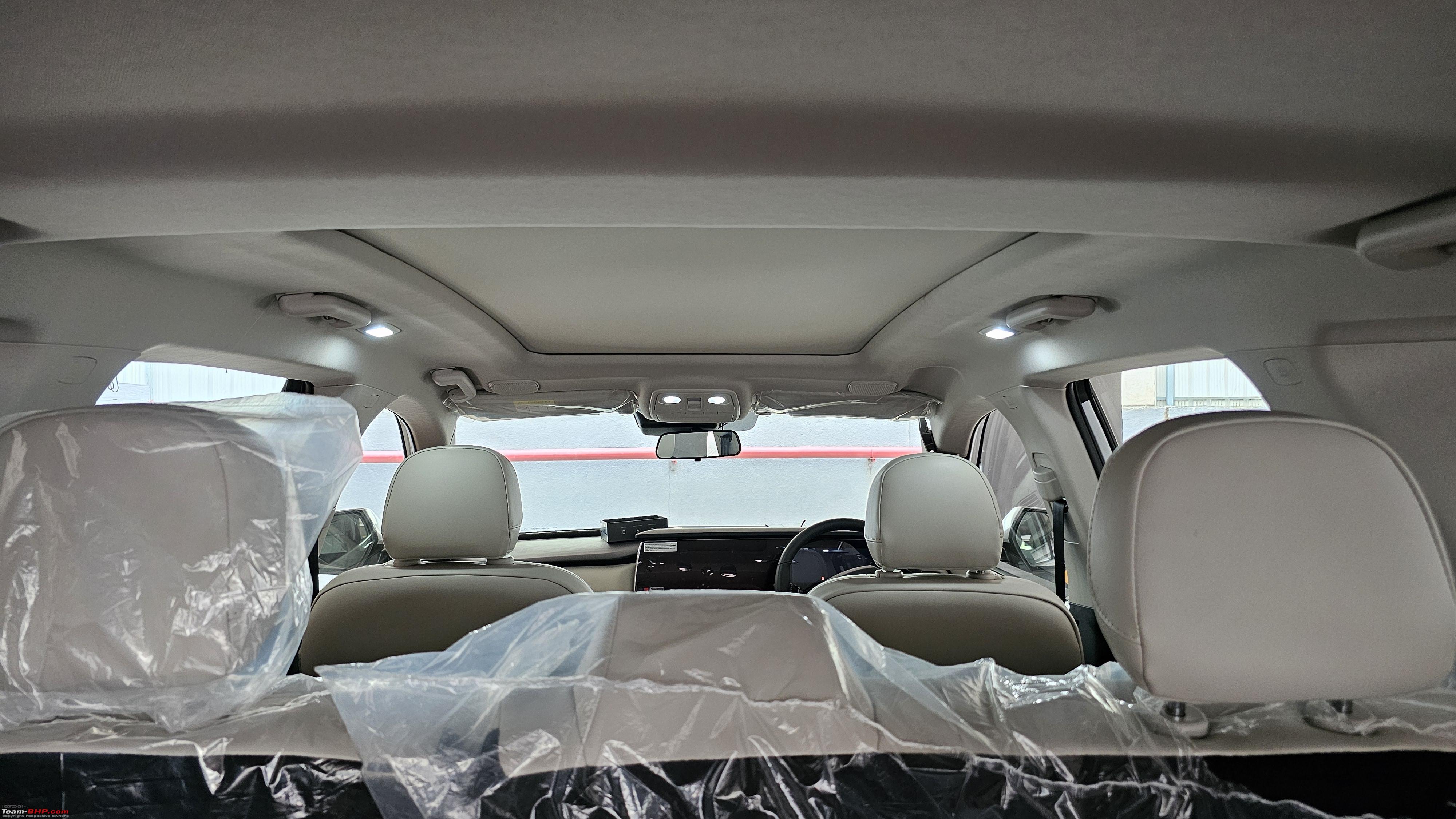

1. Installing the front dashcam:
I wanted to install mine right behind the IRVM - where it didn't intrude into my vision while I was driving. Unfortunately, this is exactly where the dealership had stuck the FasTag! - dead center on the windshield, right below the ADAS camera module.
DIY: Hardwired Dual-Channel Dashcam installation, with 24-hour surveillance (XUV700)-20240911_222659.jpg
In my opinion, this is the best location for the front dashcam. It is out of sight of the driver (behind the IRVM) and perfectly centered on the car, so that the video captured is symmetrical from one edge of the hood to the other. Second best position would be to install the dashcam below the existing FasTag. But that would encroach into the my peripheral vision and would be an eyesore on an otherwise beautiful, large windshield. Third choice would be to place it on either side of the FasTag. This would cause the camera footage to be off center. You can choose which kind of irritation you can live with and decide for yourself.
Naturally, I went with the most painful option of ripping out the existing FasTag in order to place the camera in my preferred location. Perfection exacts a toll (*wink *pun).
For those thinking I'm a lunatic, fret not - I had already procured a replacement FasTag that I ordered on the day after vehicle delivery (Yes, I did put a lot of planning into this).
I spent the next 10 mins furiously cleaning the glue residue from the old FasTag with IPA, a blade and some microfiber cloth. Once the glass was squeaky clean, I placed the provided electrostatic sticker as instructed in the dashcam manual and stuck the camera onto it. So far, so good.

6. Fuse-box installation:
This was the only harrowing part of the entire project, because I was going to be mucking around inside the high ampere bay of a 2-day old car I had never worked on in my life. However, if you want to avoid any stress and don't want to go through the entire process of testing every fuse with a multimeter, you can choose to just use the fuses that I ended up selecting - it's up to you, not everyone enjoys pain.
The first step is to get access to the fuse box. This involves removing a panel located in the side on the driver’s side. It's a pull-away panel and very sturdy - you are unlikely to break it (but who am I to underestimate you?). Still, just be a little careful, okay? Peeling away the rubber beading running over the panel helps in its removal. Once you yank the panel away, it will reveal two screws holding the fuse-box cover in place. There are two more screws on the bottom of the panel that need to be removed (at least on the AX7L) before the panel can be partially pulled away to expose the fuse-box. Mind you, this panel has switches connected by wires leading into the ECU so don't pull away too hard. All the work involved can be completed without disconnecting these wires. Detailed instructions of how to access the fuse-box as well as the fuse diagram are very helpfully provided by Mahindra in your owner’s manual (Yes sir, I read all 400+ pages).
DIY: Hardwired Dual-Channel Dashcam installation, with 24-hour surveillance (XUV700)-mahindraxuv70020212023_in1_locfuseboxlocation.jpg
DIY: Hardwired Dual-Channel Dashcam installation, with 24-hour surveillance (XUV700)-20240908_070001-1.jpg
DIY: Hardwired Dual-Channel Dashcam installation, with 24-hour surveillance (XUV700)-20240908_083310-1.jpg
Next, I pulled out my shiny new multimeter, set it to DC Voltage mode and selected 20V (next higher setting than what voltage you're looking for) as I was looking for 12V DC. Since I have already explained I did not want to touch existing fuses, I only went after the spare slots. There are multiple spare fuses on the board: F1, F4, F8, F12, F13, F32, F45 and F52 rated for different amperes.
For dashcam purposes, 5 amps is sufficient (and that's the fuse that comes with the hard-wiring kit), so we can use any of the 15A or 20A rated slots, leaving the higher rated slots for future projects (*wink, *wink). Make sure the car ignition is off at this point. Touch the black probe to any nearby bare-metal point on the car chassis (ground) and the red probe to the metal contact in the fuse slot that you want to test. Each slot has two recessed metal contacts inside. These are the points that the fuse comes in contact with once it is inserted. One of the points is connected to power source and the other is an air-gapped contact terminal intended to hold the other end of the fuse, and is usually connected to the target device. Once the fuse is inserted, current flows from the source contact across the fuse into the other terminal and eventually to the connected device (dashcam in this case). If the flowing current exceeds the fuse rating, it melts (blows) the fuse to break the circuit and disconnects the device, preventing damage. This current flow is uni-directional, so you have to test both contact points in the slot to figure out the direction of current flow. One of the contacts should read 12V and the other should read 0V. Upon inserting fuse, both will read 12V as they are now connected with a fuse and the current is free to flow across. You have to ensure that the hardwiring kit is installed such that the prong at the end of the fuse cable (away from the wire) is touching the source pin. If you reverse it and insert, the current will bypass the fuse and flow directly into the wire and its connected device, thereby affording no protection to the car or the accessory. This is dangerous - you will practically be forcing a direct connection between the car battery and the dashcam without any safety, so understand this properly before proceeding. I hope this also explains the basic principles of a fuse.
On slots that are connected directly to battery (VCC), the multimeter will show ~ 12V reading on the source terminal even when the car ignition is turned off. This is your VCC slot. This will be used for low power actions like parking surveillance. Write it down, and also note which is the source pin, to determine direction of flow of current. Some spare slots will show 0V on both contact points when tested with the multimeter. These are not VCC slots and may either be ACC slots or a just a dummy slot.
Once you have identified the VCC fuses, focus your attention on the spare slots which were showing 0V at both contacts when car was turned off. Now turn on the ignition and re-test these slots. You will see that suddenly one of the contacts on these starts reading ~12V and the other reads 0V. Note the fuse number and direction of current flow. On turning off the engine, power will drop back to 0V on both the contacts in a few seconds. This is an ACC slot. This will be used to power the dashcam during running of the car. Congratulations! you have now identified your ACC and VCC fuse slots.
I have used F4 for ACC and F32 for VCC.

Dashcams are a must nowadays, the minimum one should have is the front windshield camera. Couple of years back, I too installed a dashcam on my own and few points in addition to above which I would like to highlight:
1. In case the vehicle is equipped with side air bags, take extra care while hiding the dashcam wire in the A pillar. Ensure that the wire doesn't hinder with the operations of the airbag and is tucked in behind the flow of the airbag.
2. The placement of the camera is very important so as to have maximum coverage, therefore, before pasting the camera, do check on the app the view one gets and then make the final pasting.
3. If possible, use antiglare screen on camera which is at times useful to remove the unnecessary haze especially during the bright outdoors or at night. Check the footage and then make appropriate decision.
With so much of necessity around having dashcams, shouldn't OEMs consider this as a standard fitment in days to come?

Originally Posted by OrthodocX View Post
This is where my installation deviates from most tutorials I have seen online. While some people recommend just taking the wire across the A-pillar where the plastic pillar housing meets the head-liner and then continue down into the fuse-box, I think that's a really dumb thing to do if your car has side airbags.
Doing this essentially stretches your wire across an explosive device (the airbag is a pyrotechnic marvel - basically a gas bomb) and I don't want anything running across it if it ever decides to deploy during an accident. My solution? Partially detach the A-pillar so you can see the airbag, and route the camera cable
This is really easy - just do what you did with the front camera cable, but once you're across the A-pillar (behind the airbag) instead of going down the pillar, continue horizontally in a straight line beneath the rubber weather strips and tuck the wire into the head-liner
Super clean installation. I agree the approach you have taken is the correct way to do it. I have done that and the wires must be secured with zip ties or cable management.
For the rear camera, the most perfect way to route is not via the headliner. That is the easier part. The best way is to route it down below to the sides of the carpet and then bring it back up to the boot door. Obviously, that involves removing panels etc. and is more involved, but that is a more perfect installation than going via the headliner.
sudeepg is offline   (1) Thanks
