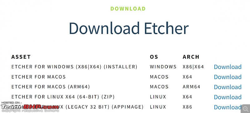

Download and install BalenaEtcher. It's a tool that will help you flash the image to the SD card.

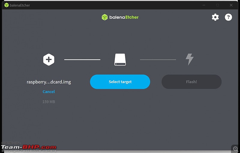

Connect the SD card to your PC using an SD card reader.

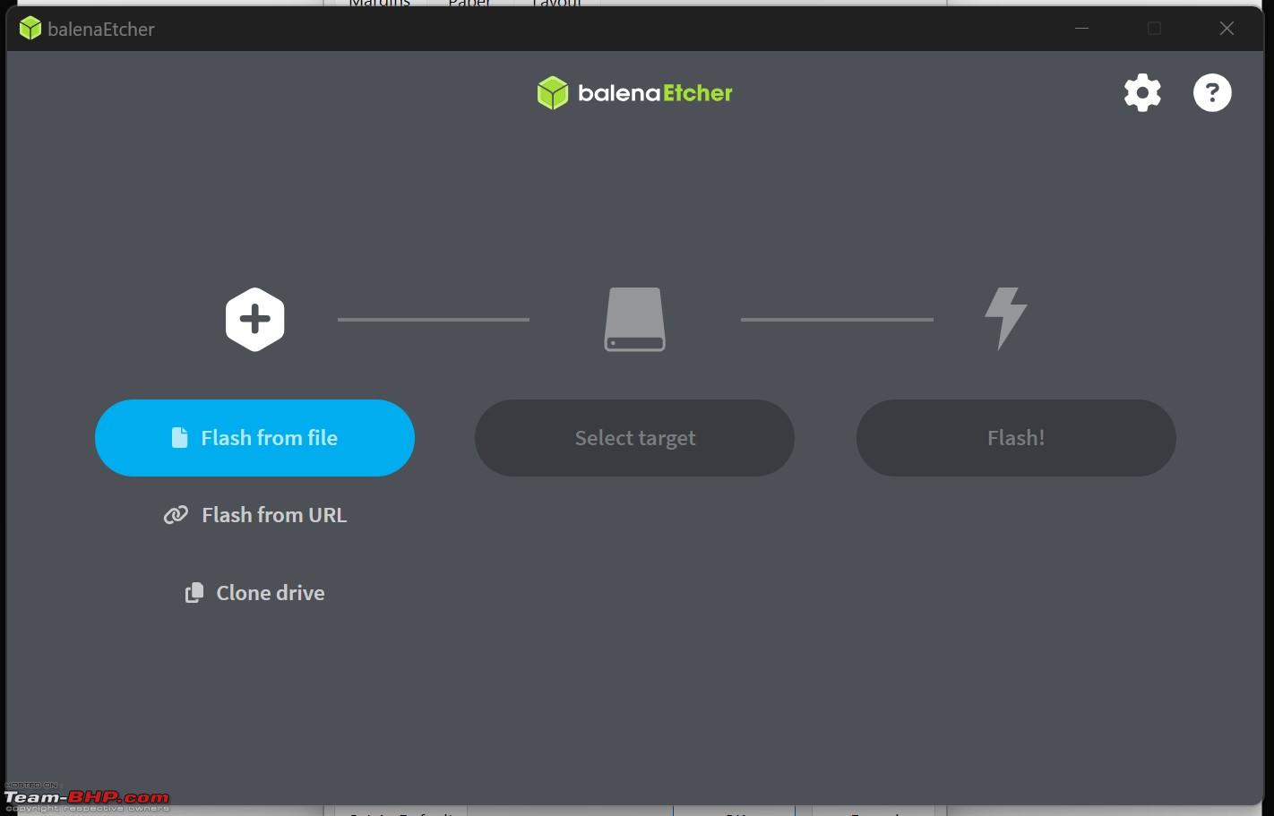

Launch BalenaEtcher and select the 'Flash from File' option. Choose the downloaded image file.
Wireless Android Auto Dongle for Your Car Using Raspberry Pi Zero W-screenshot-20240823-233904.jpg

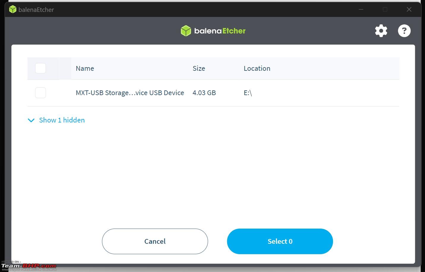

Now select the SD card from the list and hit 'Flash'.

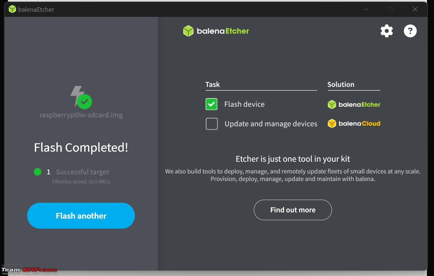

Click on "Flash!" to start loading the image onto the SD card. The process will take a maximum of one to two minutes.
Wireless Android Auto Dongle for Your Car Using Raspberry Pi Zero W-screenshot-20240823-234046.jpg
Once it has finished flashing, unplug the SD card, and then plug it into the Raspberry Pi board.
Wireless Android Auto Dongle for Your Car Using Raspberry Pi Zero W-screenshot-20240823-234218.jpg

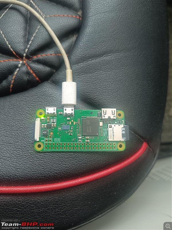

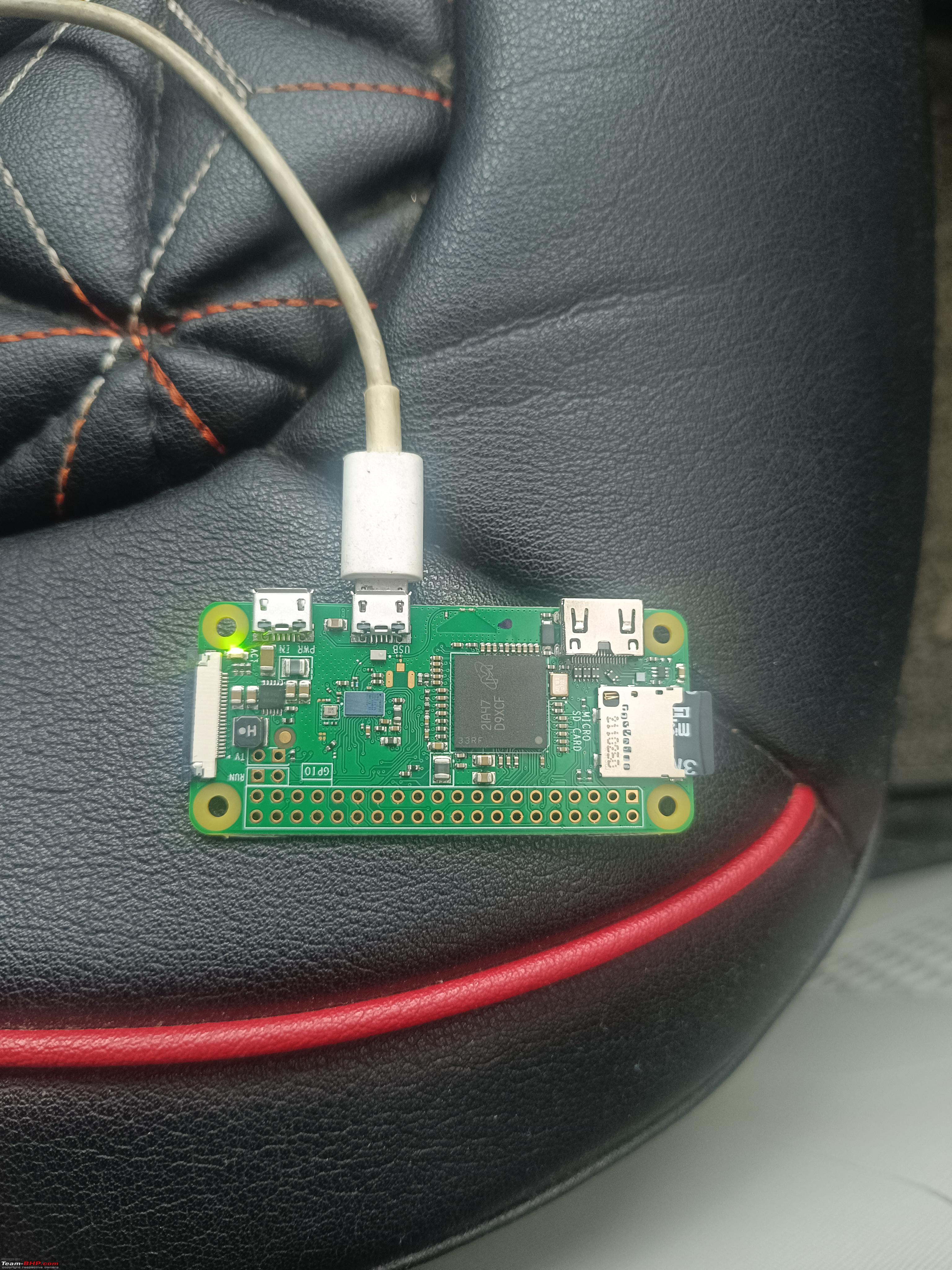

Connect the Raspberry Pi board to the car's head unit using the USB cable. Make sure that the SD card flashed is inserted properly on the Raspberry Pi Zero W board itself.
Wireless Android Auto Dongle for Your Car Using Raspberry Pi Zero W-img_20240824_090613.jpg
Wait for around 10-20 seconds for the green LED on the board to glow.

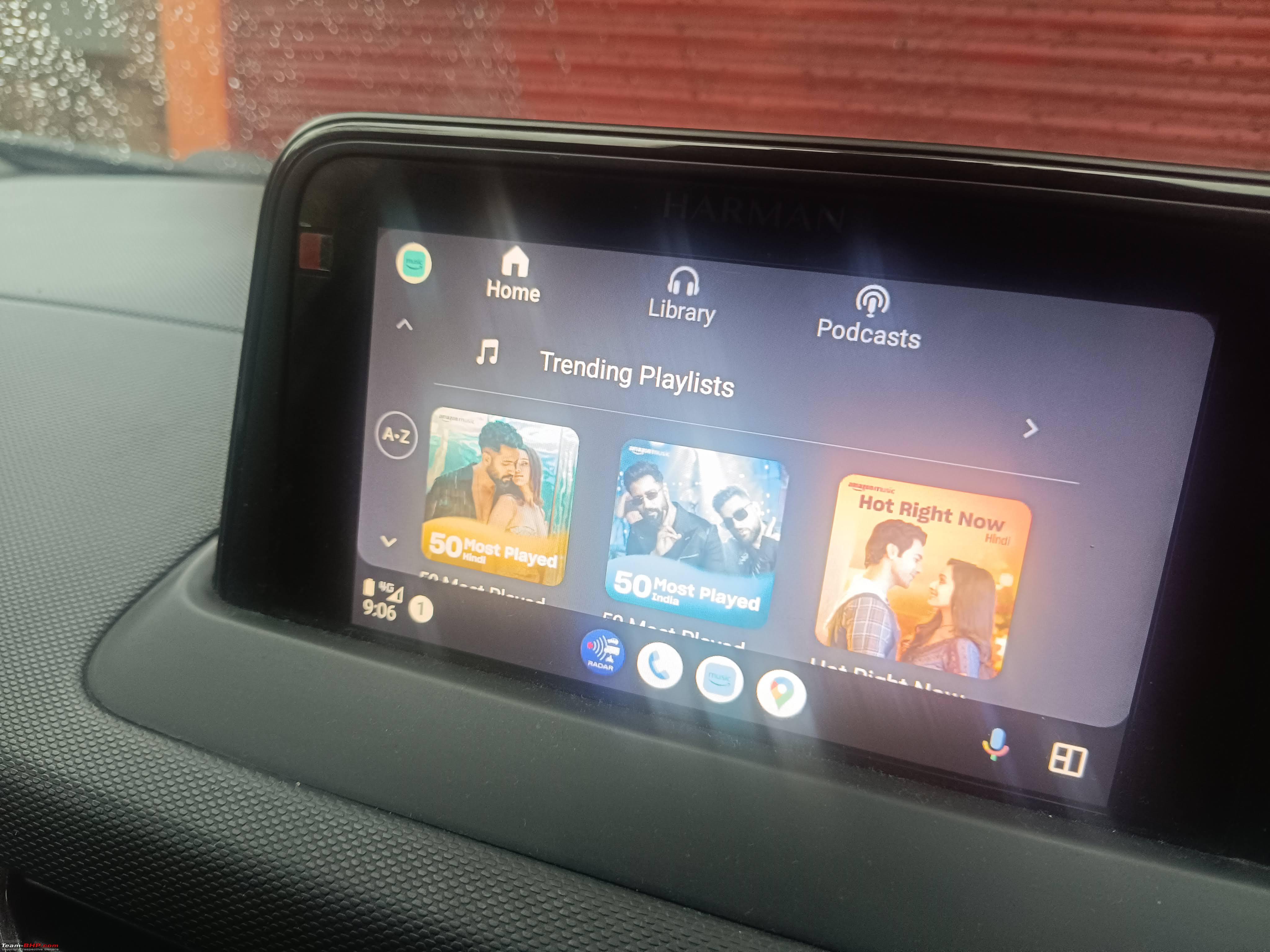

Android Auto should appear wirelessly on your car screen.
Wireless Android Auto Dongle for Your Car Using Raspberry Pi Zero W-img_20240824_090638.jpg
Technically, this setup worked flawlessly for my Raspberry Pi Zero W. I got absolutely all the features of the Android Auto on my Nexon. I have not tested it in another car yet, but it should work as long as the head unit supports wired Android Auto.
