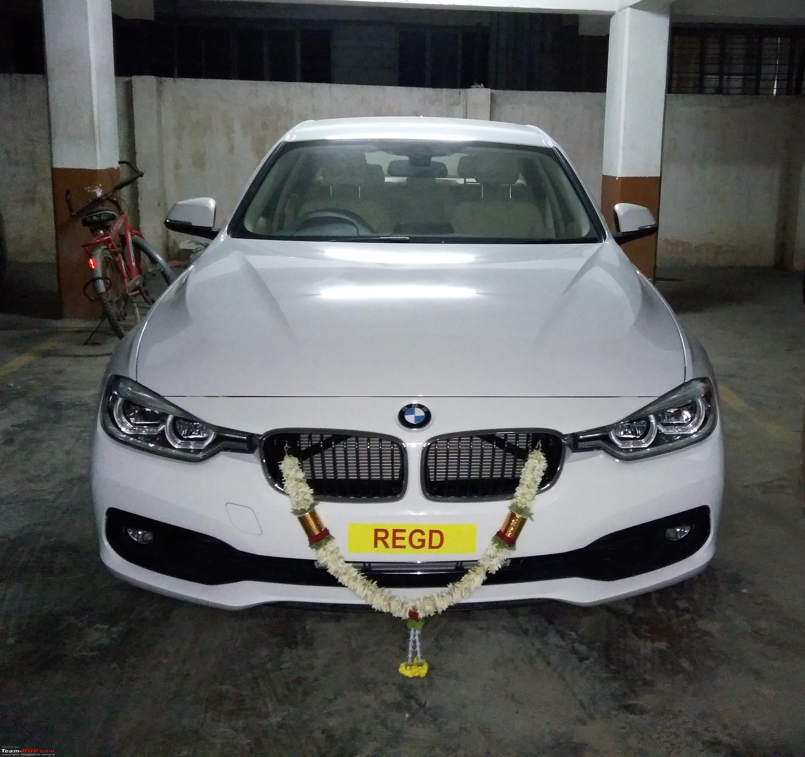

BMW 320d Prestige 2017
My BMW 320d | 7 Year Review | DIY Mods | Highlights | Lowlights-photo_20170331_203943.jpg

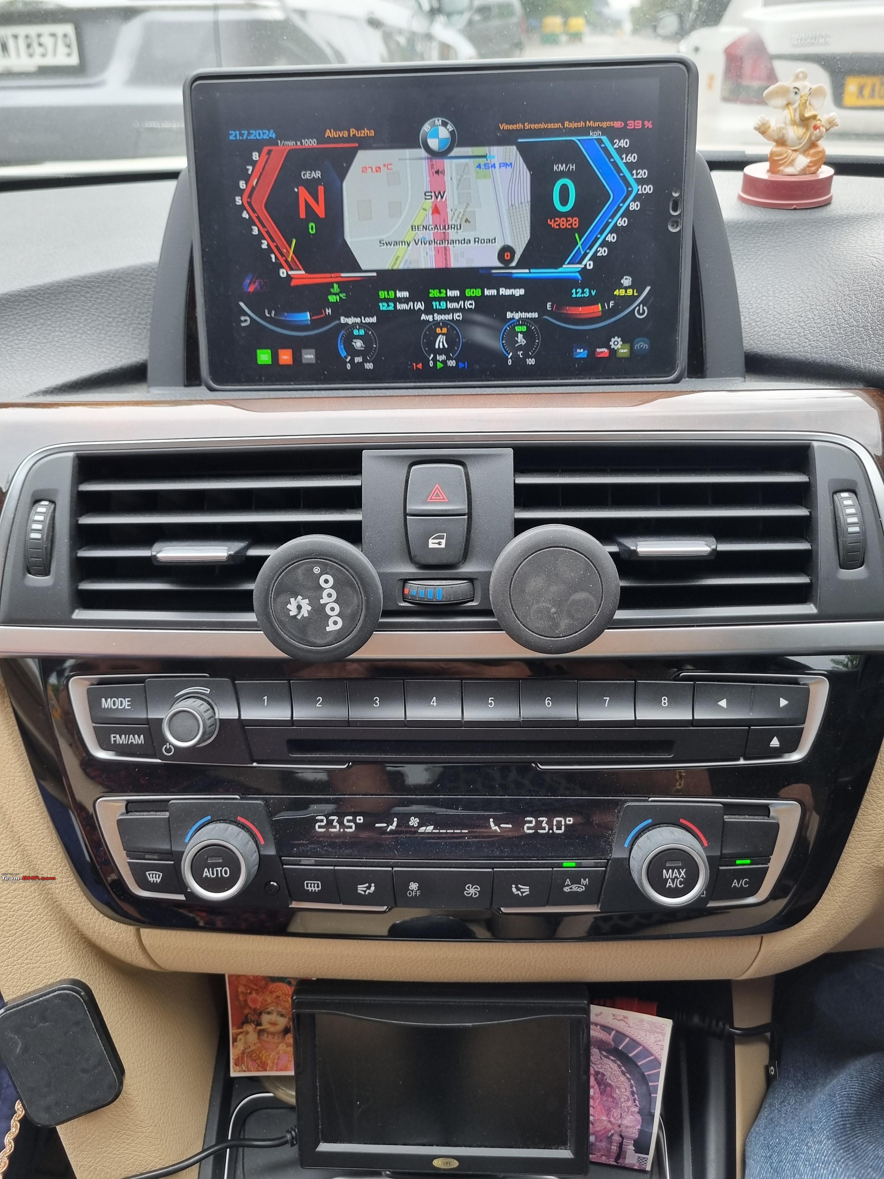

Subsequently, I tweaked the RD Premium dashboard for different modes and mostly place the tablet near the AC vent.
I have placed shortcut buttons for Night mode, Navigation, Spotify and Dashcam at the bottom left and right in all RD modes. RD also supports select voice based commands.
Some of the Vehicle parameters that I have set on RD apart from the regular ones (see the small dials in each mode):

Have set a timer to switch between the following modes every 30-45 secs.
RD Normal mode (Note the DIY sunshade)

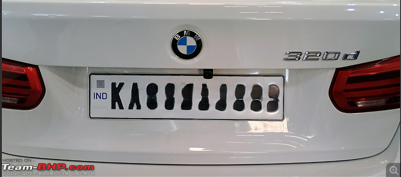

Always On Rear camera set-up:
I installed a HD 1080p camera near the trunk handle and connected it to a 5" display to view the rear of the car. Day vision is very good but night vision is average, unless the roads are well-lit and no headlights beaming at the camera.
My BMW 320d | 7 Year Review | DIY Mods | Highlights | Lowlights-bmw-rear-hsrp.png

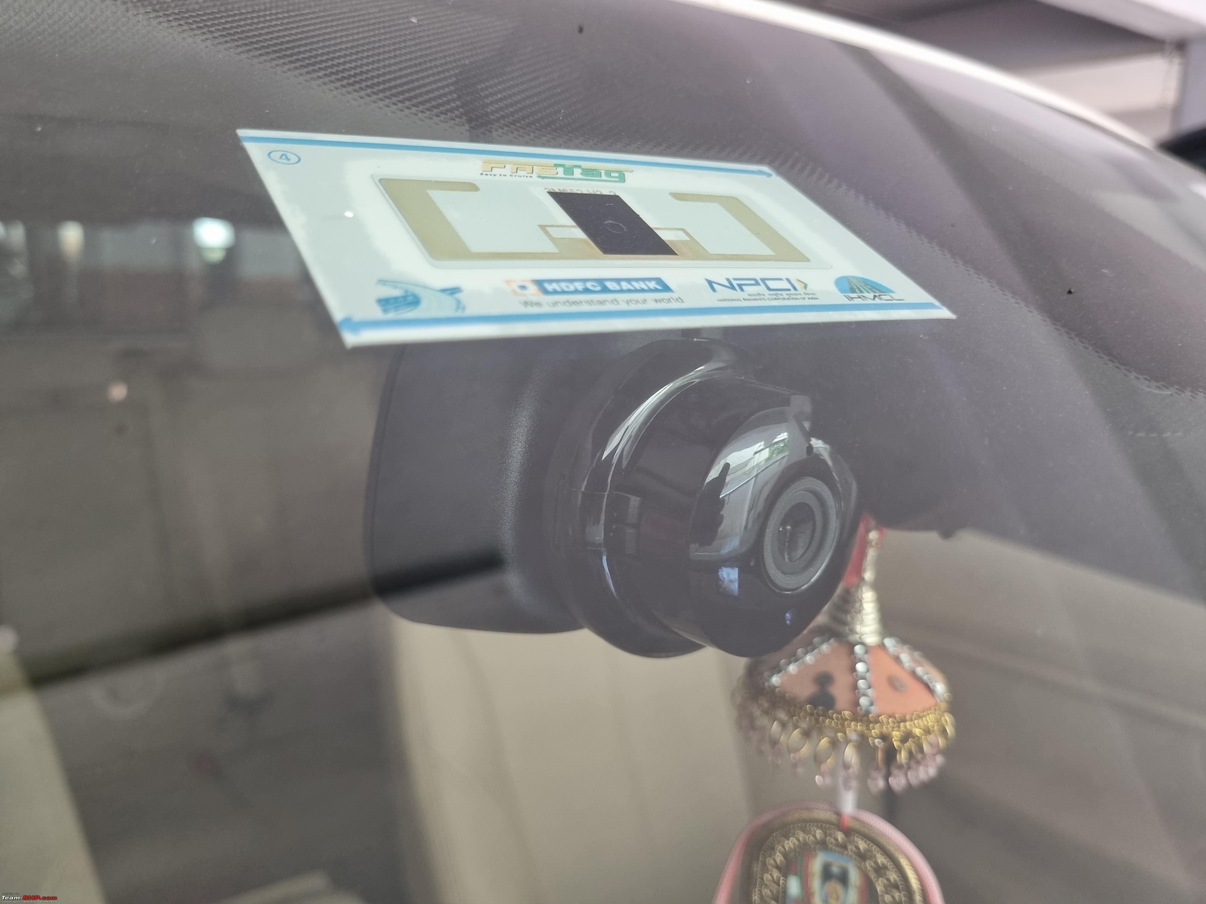

DIY Dashcam set-up:
I converted a Wifi camera to serve as a front dashcam installed behind the car's rear view mirror. I use the V380 Pro app to store the recordings onto an SD card. There is delay of around 2 secs when comparing live view and dashcam view because it is Wifi based and also this camera was originally meant for security monitoring.
My BMW 320d | 7 Year Review | DIY Mods | Highlights | Lowlights-20240719_114440.jpg

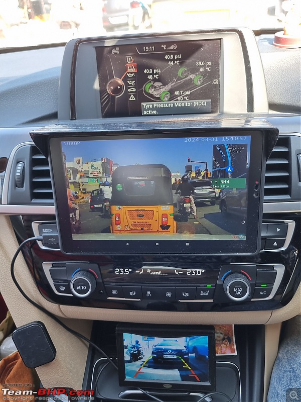

Front Dashcam View with Google Maps overlay:
My BMW 320d | 7 Year Review | DIY Mods | Highlights | Lowlights-20240331_151100.jpg
I normally keep the type pressure around 34-36 psi. Note the high temperature and pressure of the tyres. Any of you seen higher figures?
Daytime clarity is very good and it has infrared night vision too.
At a signal, if I press the Dashcam shortcut to have a quick look (as seen above), it will go back to RD view after 30 secs (I have set a timer). It will keep recording in the background.

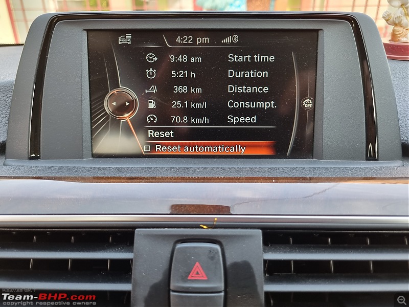

Highest mileage from BLR to CBE:
My BMW 320d | 7 Year Review | DIY Mods | Highlights | Lowlights-20231113_162205.jpg
Pure highway drive:

I think you could add a few more screens in there mate . You might be shortchanging yourself.

Ha ha, you have a point. I was initially thinking of swapping out the 6.5" for a 10" Android unit, but didn't want to risk it with those CANBUS connections and CID would show up as missing.
Now, if EGR needs a flash (I had 2 such instances), BMW will not do the update because of the missing CID. This would cause service issues as well. Also, RD apparently does not work well with these Android HUs and didn't want to lose out on its features.
Many use an additional screen for Maps or Mirroring. So its just 1 more screen. Doesn't bother me.

I know it’s personal preference, but those 3 screens are bit too much for my liking and an eyesore otherwise in such a fine car.
Yes, to each his own, but I get your point. Since RD screen is more important to me, I will move it in front of iDrive as shown initially. Since I use iDrive mainly for TPMS and general service checks, I can take a quick glance when needed. Will move the 5" Display back near the cup holder only for reversing and switch it off when not in use.
Back to 1 screen then . Sounds good buddy? @Kapany?

As preferred by many and hinted by me above, I have moved the Tab around to create a single screen solution.
My BMW 320d | 7 Year Review | DIY Mods | Highlights | Lowlights-20240721_165407.jpg
Generally OLED tabs come in >10" sizes. Up to 8.9" is what is ideally suited for this arrangement. Beyond that it would look out of place since the height would also go up. In fact, a larger tab with max 5" height would be ideal. However, night view on IPS is pretty good.
