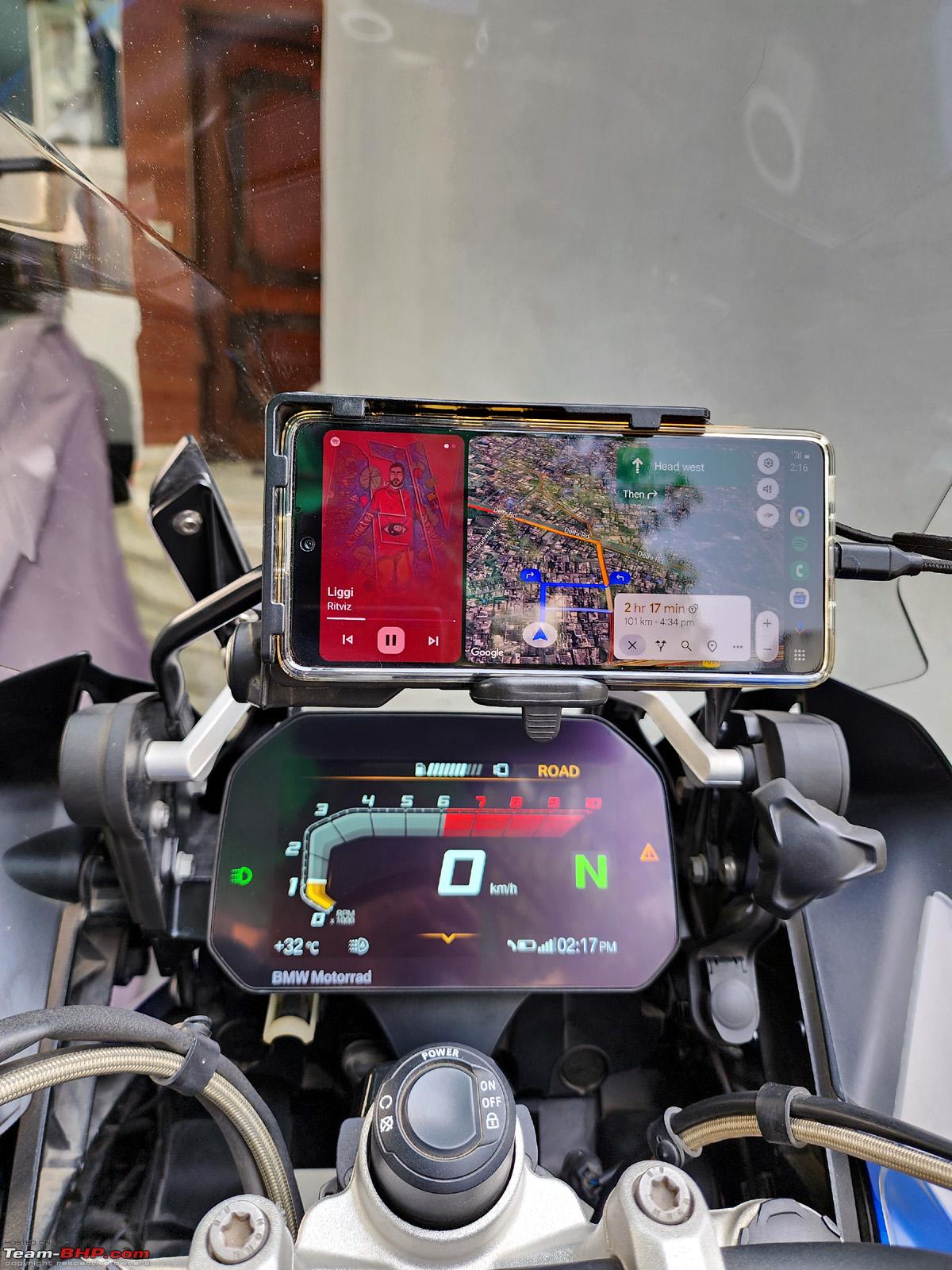

DIY: Get Android Auto in any Car/Bike for Free (or under 10k)-bmw-r1250gsa-android-auto-11052024_1.jpg
The setup is again totally wireless with my main phone (S22 Ultra) safely in my pocket while riding -
DIY: Get Android Auto in any Car/Bike for Free (or under 10k)-bmw-r1250gsa-android-auto-11052024_2.jpg
The crystal clear audio here is outputted through my Samsung Buds under my helmet or any other Bluetooth Headset you may have connected to your main phone -
DIY: Get Android Auto in any Car/Bike for Free (or under 10k)-bmw-r1250gsa-android-auto-11052024_3.jpg
Auto Brightness, in this setup, was kept OFF on Navigation Phone (A71 - 6.7"), and it's brightness was set between 50% to 70% to prevent over heating. Rest conditions are same as using any phone for navigation. Only thing is that your main phone is in your pocket, safe from the elements and vibrations. And you get a better Android Auto interface on your navigation phone than the stock navigation app.

Originally Posted by dkaile View Post
Using Samsung Tab on a motorcycle -
https://Youtu.be/mTu5PtbjlBk?si=UgXE5VwoO2ff9dkE
Note - The android tab shown in the above video is a waterproof one. Though I think this screen size on a motorcycle is a overkill, but the OP in that video details reasons for using this bigger size, as it helped him in trail riding. Not necessary for a vast majority like us.
Cheers...
Do we have a brand which sells such cases in India for Android tabs! I would not mind an overkill setup on my bike given that I have successfully destroy one iPhone and the current RE himalayans navigation system is strictly only for emergency navigation situation. A few extra minutes and the phone gets cooked and switches off due to extreme heat!
