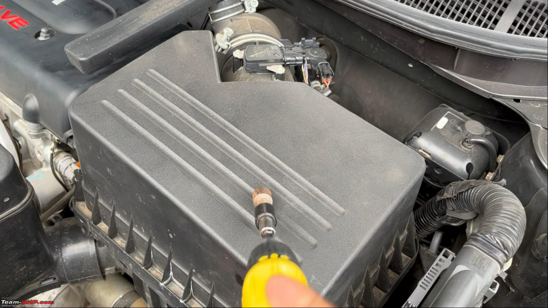

STEP 7 : Air Filter Replacement
DIY: Toyota Camry Oil Change-13.jpg
The air filter just sits on the right side of the engine. To open the air filter cover you have to unscrew 2 x 10mm bolts. Then just remove the cover and replace the air filter with the new one.
DIY: Toyota Camry Oil Change-14.jpg
