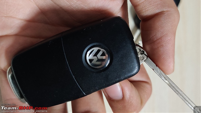

The key for my Polo GT had started showing its age, its a 2016 model year polo.
The ignition mechanism of VW vehicles is very hard and resistive hence the key gives up rather soon.
i am not sure of the price quoted by VW for this, but my friends have told me its almost 6,000/- INR for a key replacement. Mine did not need to be replaced, it was working perfectly, its jut that the key blade was coming loose from its place(That price could have been for a new key with the board, not sure). The key blade is mounted to the flip mechanism in 2 pieces and it is not one single unit, this made replacing it easy for sure but this design coupled with the hard ignition mechanism of my Polo meant that it became a weak point and made the flip key mechanism fracture like so.

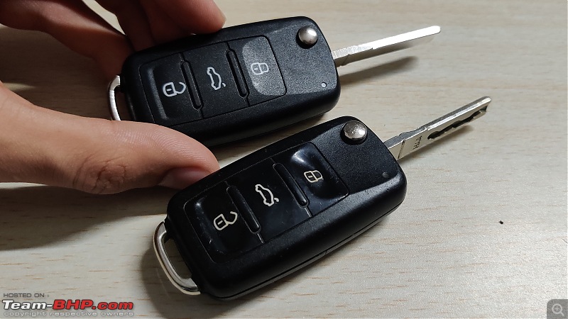

The key shell comes with a new flip mechanism and a blank blade, you can either get the blade carved from a local key shop or swap blades, because you have to open the key shells to insert the board into new one anyway.
This is what the replacement key shell looked like
DIY: Fixing a broken VW key for my Polo 6R-img_20210815_214526-edit.jpg
Both the keys had to be exploded open to swap/insert parts to make the key function.

In this video, the replacement key shell has a screw on lock, but the key shell i used did not, it was the standard, just like original Pin lock.
Another thing to lookout for is the width of the mounting region of the blade.
The stock blade is thicker than the Blade replacement key shell's mechanism can take, i had to grind down mine (with the help of my Father, he is very good with such stuff and loves to help me in such things all the time, huge shoutout to him) to make the Original blade fit.
DIY: Fixing a broken VW key for my Polo 6R-img_20210815_222031-e.jpg
If you look closely, you will notice the difference in width, we ground down that area twice or thrice checking each time by fitting it back in, when we were satisfied with the fit, it did not even need the locking pin it had, because the fit was that snug, anyway the pin was inserted to lock it in.
I installed everything in the new shell, something else you can do is to re use the flip mechanism in your old key shell, i managed to damage my old key shell while trying to open it as it requires some force to open it and where there is force involved, damage is bound to happen.

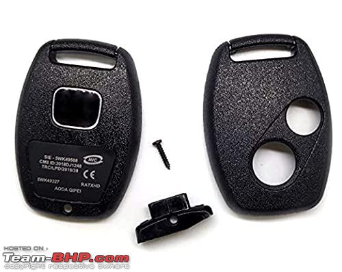

The remote key of my Honda Brio broke at the joint where metal meets plastic. Mentioned this to Honda service centre and they asked for 7K to replace the key !!! . the remote worked absolutely fine even after 10 years so started to find replacemnt for the plastic components..and was pleasantly surprised when I found these on Amazon for 300 Rs!!.
Bought the set and battery as well and preplaced them at home )
