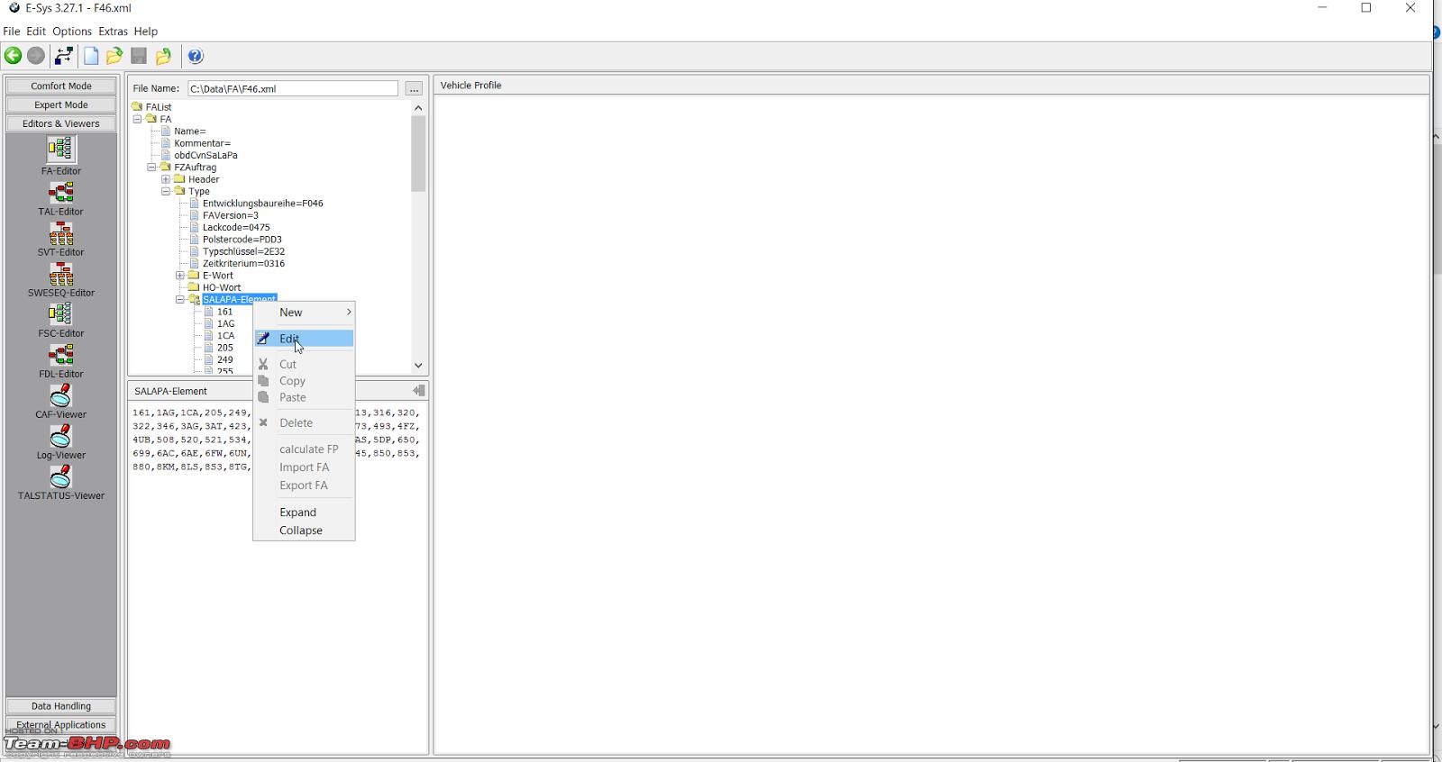

2) Go to "SALAPA-Element" and right click and select "Edit":
DIY: Retrofitting Dynamic Cruise Control on a BMW 3-Series (F30)-vo-code-2.png

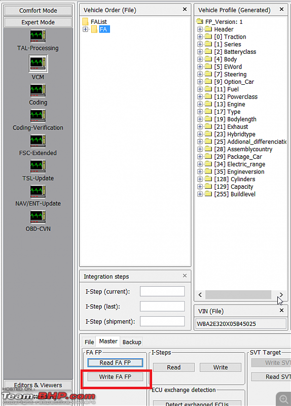

7) Click the "Write FA FP" button once you are satisfied with your settings which will writes into your ECU memory.
we killed a few ECUs initially, the car threw drive malfunction errors and all sorts of fun stuff. But we never let that bother us, started googling and going through the various guides, till we had CC with LIM up and running.
I wouldn't recommend you write your changed FA file into the module memory. There is no need to change that, and if this is done, if you ever need to update your software at BMW or with ISTA, it will not be possible till you revert it back to the stock FA.
Also don't have too much fun with esys, while you managed to recover the module this time, sometimes you can permanently brick a module.
Akshay1234 is offline   (6) Thanks
Yes, we were aware that the VO (FA) will not be the same as what came from the factory. We will use Rheingold to change the 'dcc sport' value to 'dcc sport sld' in the LIN_VARIANTE_MFL line of the FEM block. Once done and all errors are erased in Rheingold, any scan by BMW will tell them that the CC MF switch came with the car from factory. There's no need to revert to stock in order to update the car's software.
We also did not 'kill' any modules. What we saw were modules in Red (not communicating) and some in amber (with stored error codes). This is quite normal as when coding these modules stop talking to each other and the car will throw TPMS, Date/Time, Drive Malfunction and one more error code I don't remember. The Date/Time error is because of disconnecting the battery when removing the airbag. You need to reset the time. All part of the process. Clearing these errors a couple of times in ISTA+ clears them, turning all modules green.
You can't really kill any modules and if you really mess up, you can revert very easily by using the initial config file you should have saved before starting any coding with e-Sys. Saving your configuration before coding is best practise and should always be done.
It's actually quite easy. Nothing to be intimidated by.
