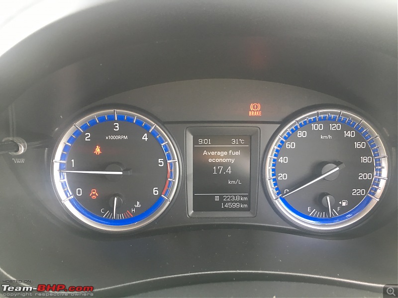

Range left after covering 360.5 KMs
Operation XP Micro: Projector fog lights for my S-Cross (Group DIY!)-img_5562.jpg

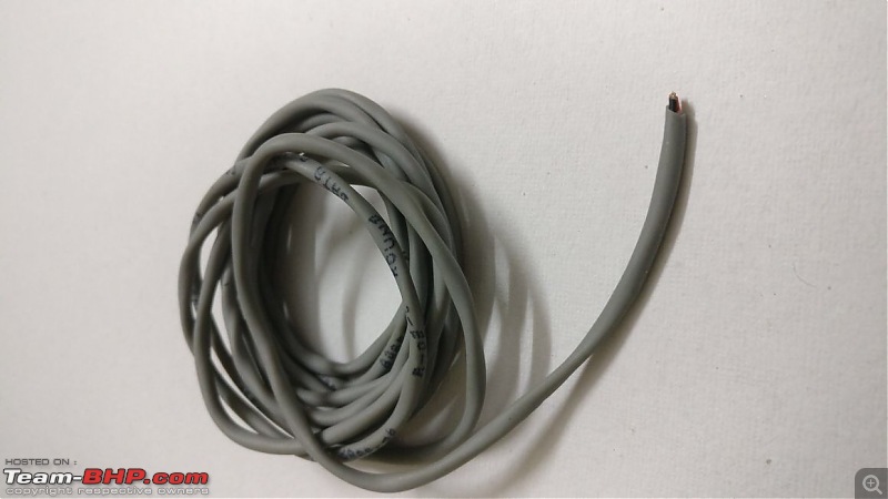

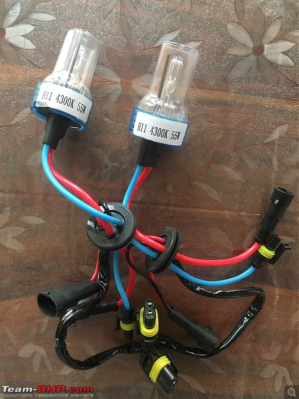

  7. Dual Core wire for the High beam of the XP Micro (thankfully this was NOT needed as the objective was to have ONLY low beam for improved visibility on the road)

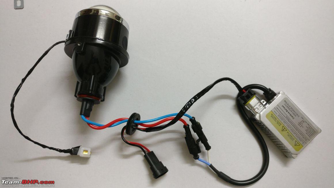

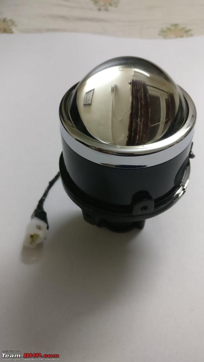

3 inch projector
Operation XP Micro: Projector fog lights for my S-Cross (Group DIY!)-projector.jpg
Projector plus its wiring connected to Ballast

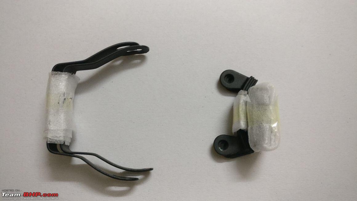

Clamps that YOU see on the right hand side were chosen to mount the projector on my car
Operation XP Micro: Projector fog lights for my S-Cross (Group DIY!)-clamps.jpg

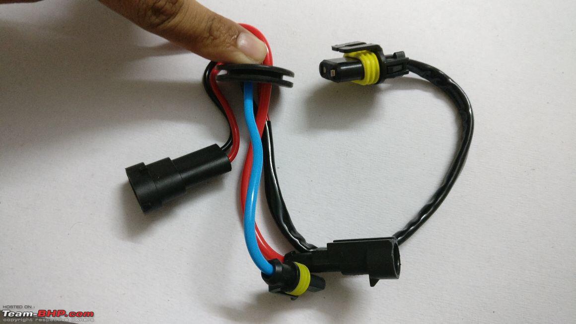

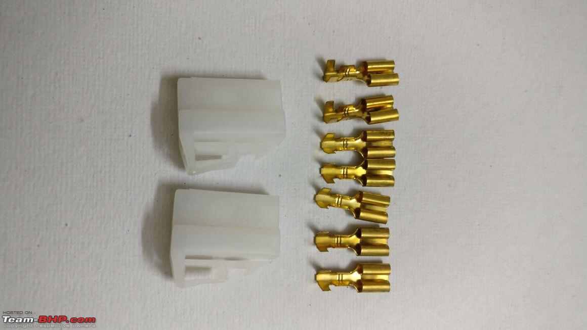

Connectors (early adopters of XP were not so lucky to get these connectors)
Operation XP Micro: Projector fog lights for my S-Cross (Group DIY!)-connectors.jpg

Dual Core wire for the High beam of the XP Micro (did not use)
Operation XP Micro: Projector fog lights for my S-Cross (Group DIY!)-dual-core-wire-high-beam.jpg

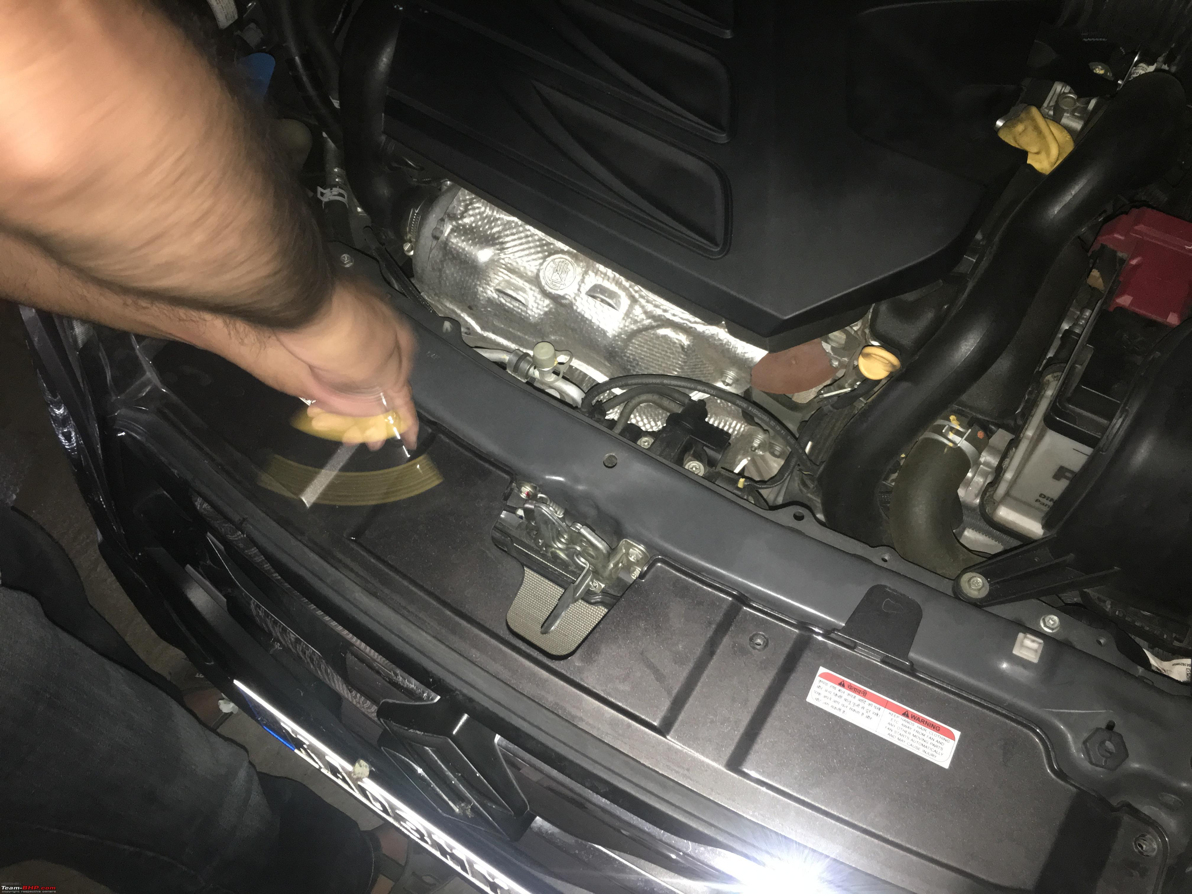

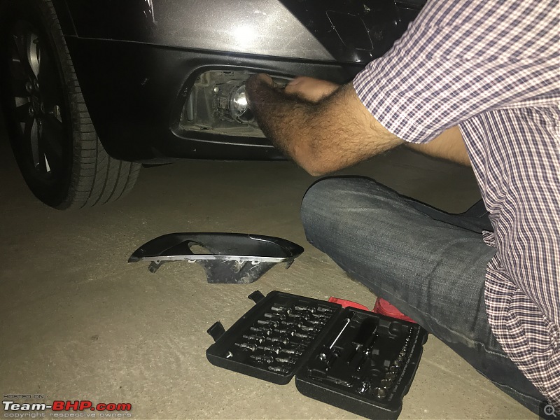

Step – 1: Disconnect the negative (–ve) terminal of the battery so that the circuit is protected in case of a short.

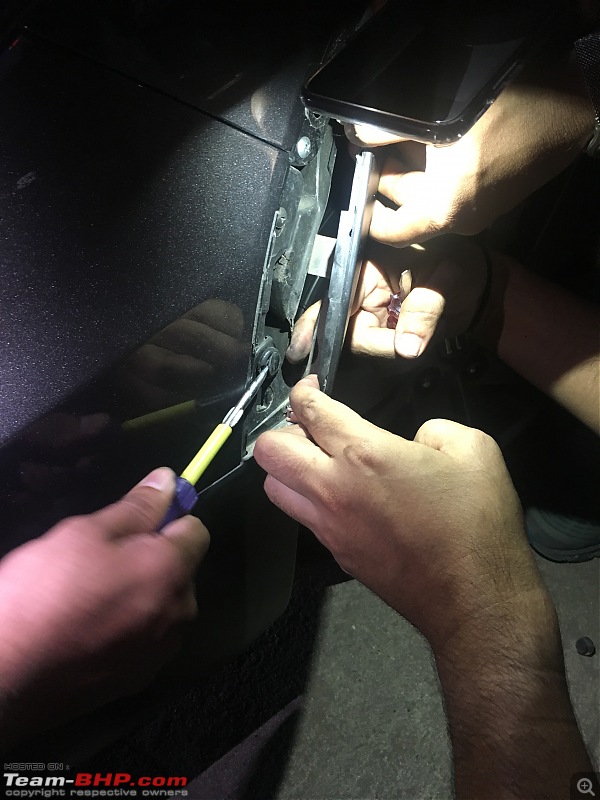

Step – 2: Open the fog lamp cover using trim opening kit. Using a star screw driver, remove the screws that hold the OEM fog lamp. Disconnect the coupler from the bulb.

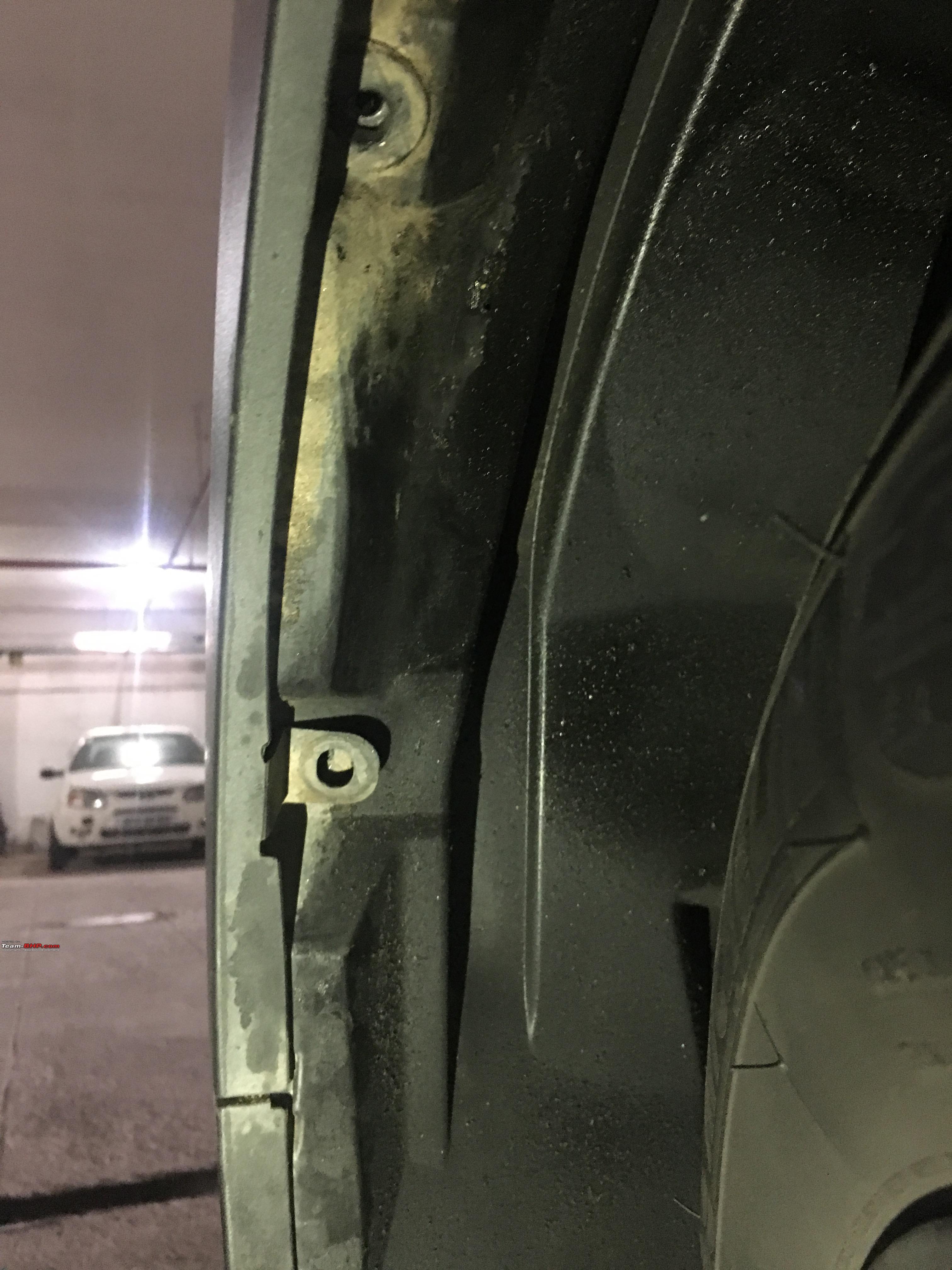

Step - 3: Open the front wheel cladding, wheel/fender liner which will be of help to open the front bumper easily.

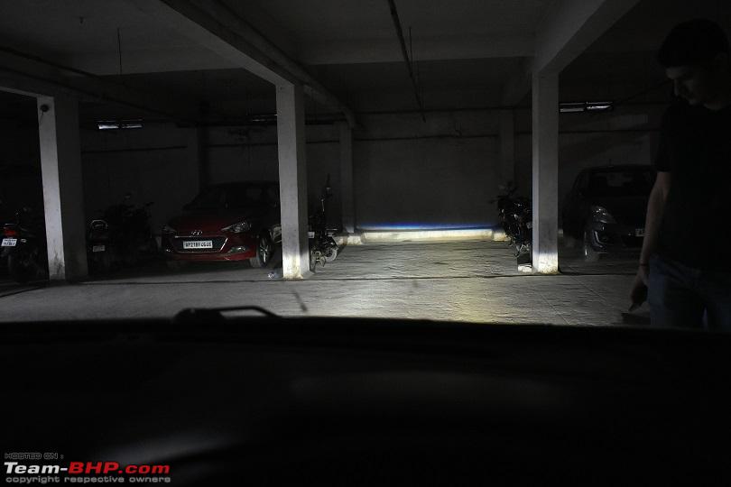

Then comes the very important aspect of proper alignment of XP Micro Fog-light Projectors.
Alignment of the Projectors
Step – 1: Wait for the late evening / nightfall and once that happens, park the car on flat ground pointing towards a wall (preferably white) with a distance of approximately 10-15 feet.
Step – 2: Set the headlight level on level 1 using the leveler switch. This is lower than Level 0 that I use regularly. Mark the Level 1 point on the wall and switch OFF the headlight.
Step – 3: Switch ON the projectors in low beam and align the projector's low beam cut off line on the same point as marked on the wall in Point 2. Do the same for both sides and tighten the alignment screw so the projector is fixed and doesn’t move around.
Step – 4: Once tightened, re-install the fog lamp covers and recheck if the alignment hasn't been disturbed or not. If all okay, set the headlight level to Level 0 and check the beam pattern.
This will ensure that the low beam will NOT affect the oncoming vehicles since it is set at a level lower than the OE Low beam of the headlight.

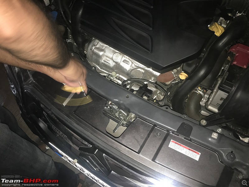

Removing fog lamp cover housing
Operation XP Micro: Projector fog lights for my S-Cross (Group DIY!)-1.jpg

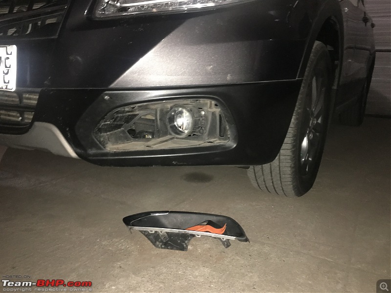

OE Fog lamp when seen after removing the fog lamp cover
Operation XP Micro: Projector fog lights for my S-Cross (Group DIY!)-2.jpg

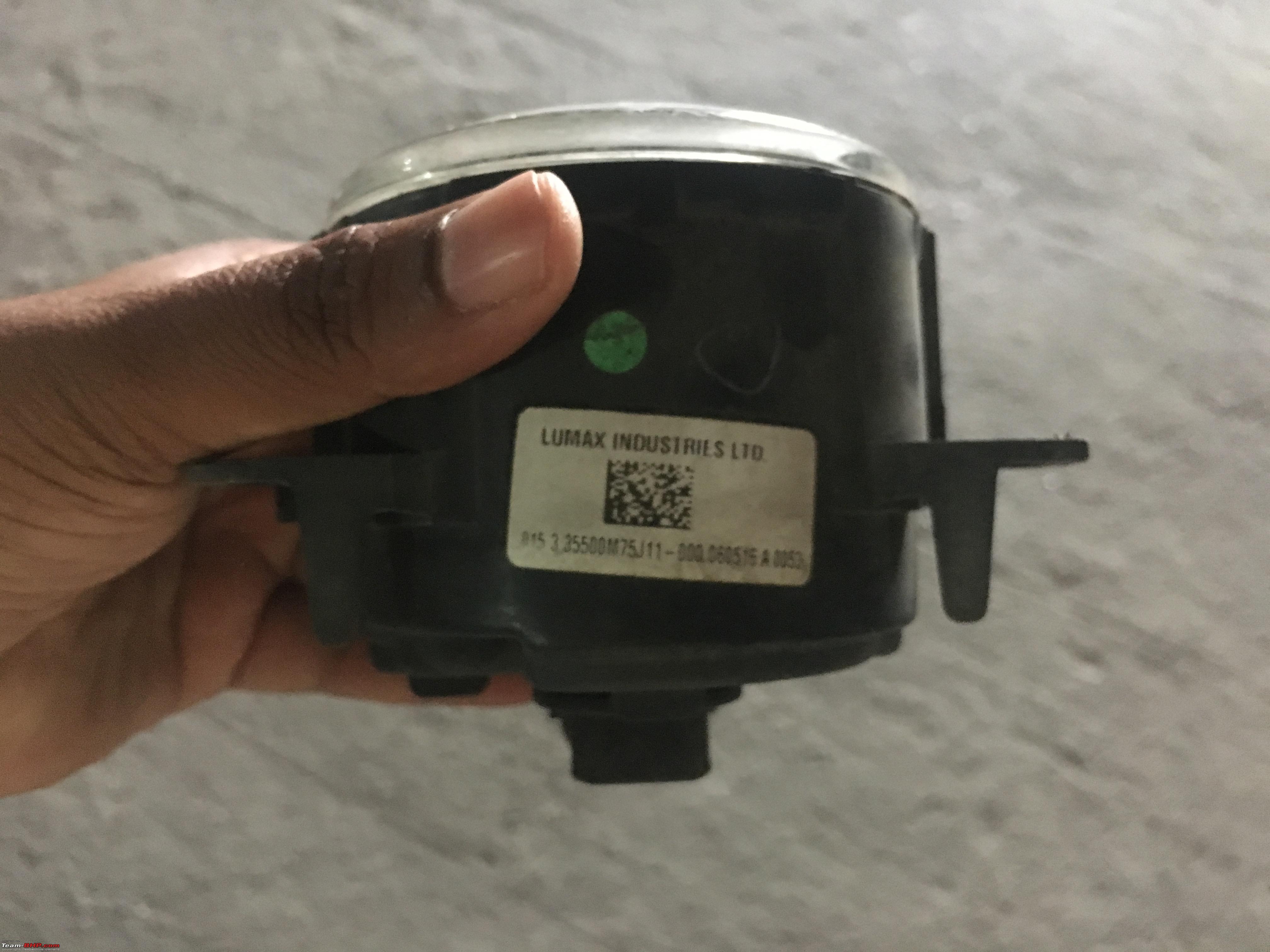

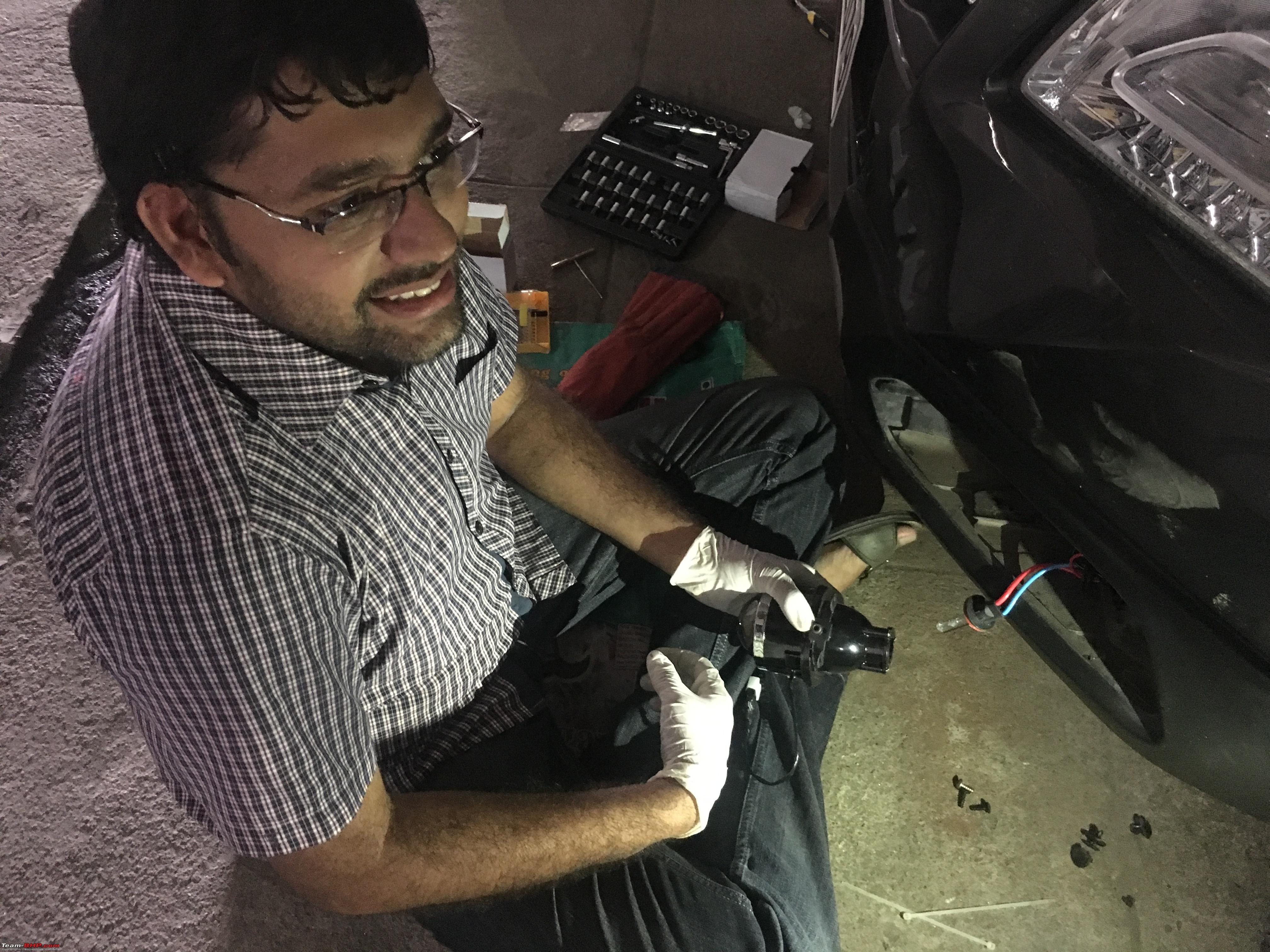

OE fog lamp being removed
Operation XP Micro: Projector fog lights for my S-Cross (Group DIY!)-4.jpg
OE fog lamp once removed from the car
Operation XP Micro: Projector fog lights for my S-Cross (Group DIY!)-6.jpg

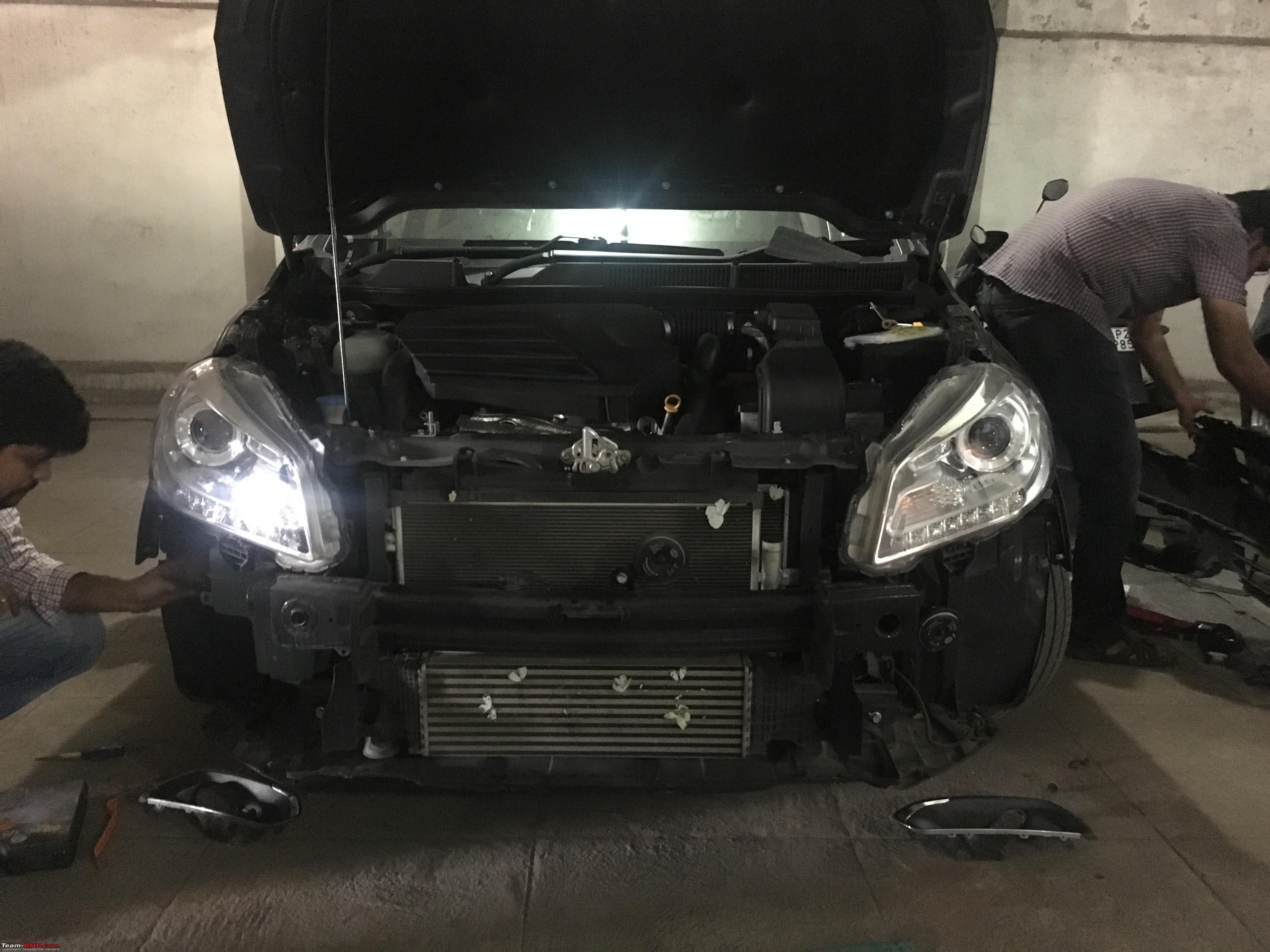

Connect the XP kit to OE fog light wiring to test before the actual install
Operation XP Micro: Projector fog lights for my S-Cross (Group DIY!)-7.jpg
Fired up and initial impressions we are on right track.
Operation XP Micro: Projector fog lights for my S-Cross (Group DIY!)-8.jpg

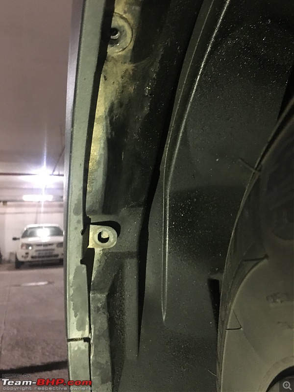

Operation XP Micro: Projector fog lights for my S-Cross (Group DIY!)-10.jpg
Operation XP Micro: Projector fog lights for my S-Cross (Group DIY!)-9.jpg
Operation XP Micro: Projector fog lights for my S-Cross (Group DIY!)-12.jpg

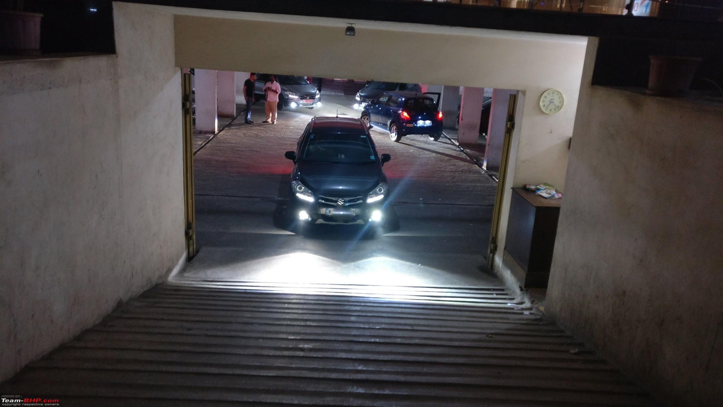

XP 3 inch projector units are fixed and being tested again.
Operation XP Micro: Projector fog lights for my S-Cross (Group DIY!)-img_5611.jpg
My tusker back to OE avatar with XP 3 inch projector units finally fixed.
Operation XP Micro: Projector fog lights for my S-Cross (Group DIY!)-31.jpg
"Hyderabad ka DON - Warun" with his hands folded backwards ensured the final alignment of XP projectors were completed as per our expectation .
Operation XP Micro: Projector fog lights for my S-Cross (Group DIY!)-32.jpg
That little dance moment definitely translates to a job well done
Operation XP Micro: Projector fog lights for my S-Cross (Group DIY!)-30.jpg

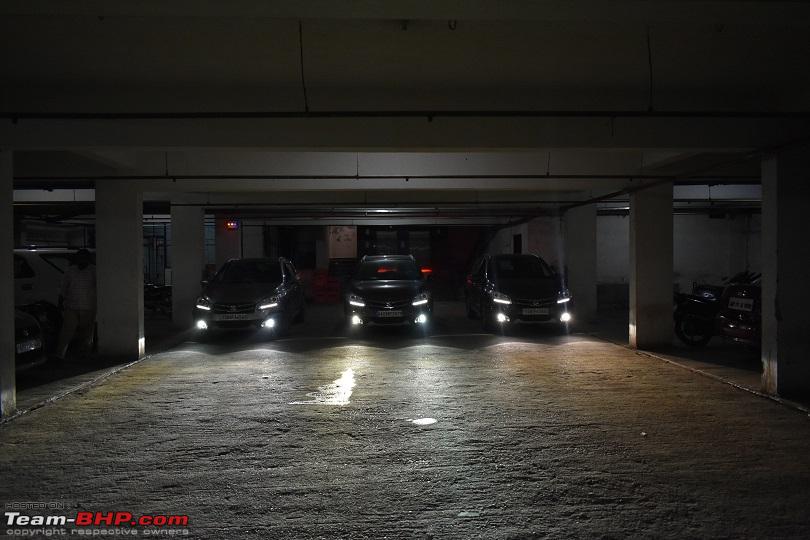

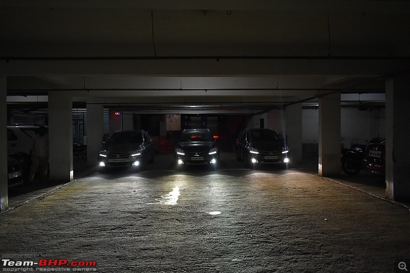

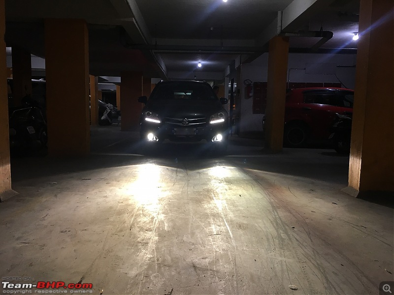

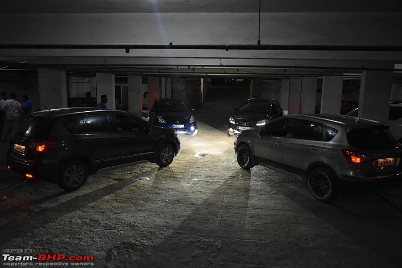

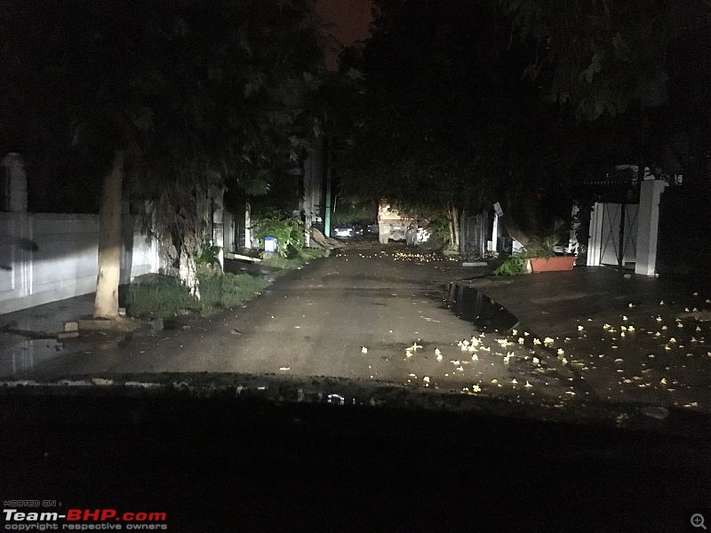

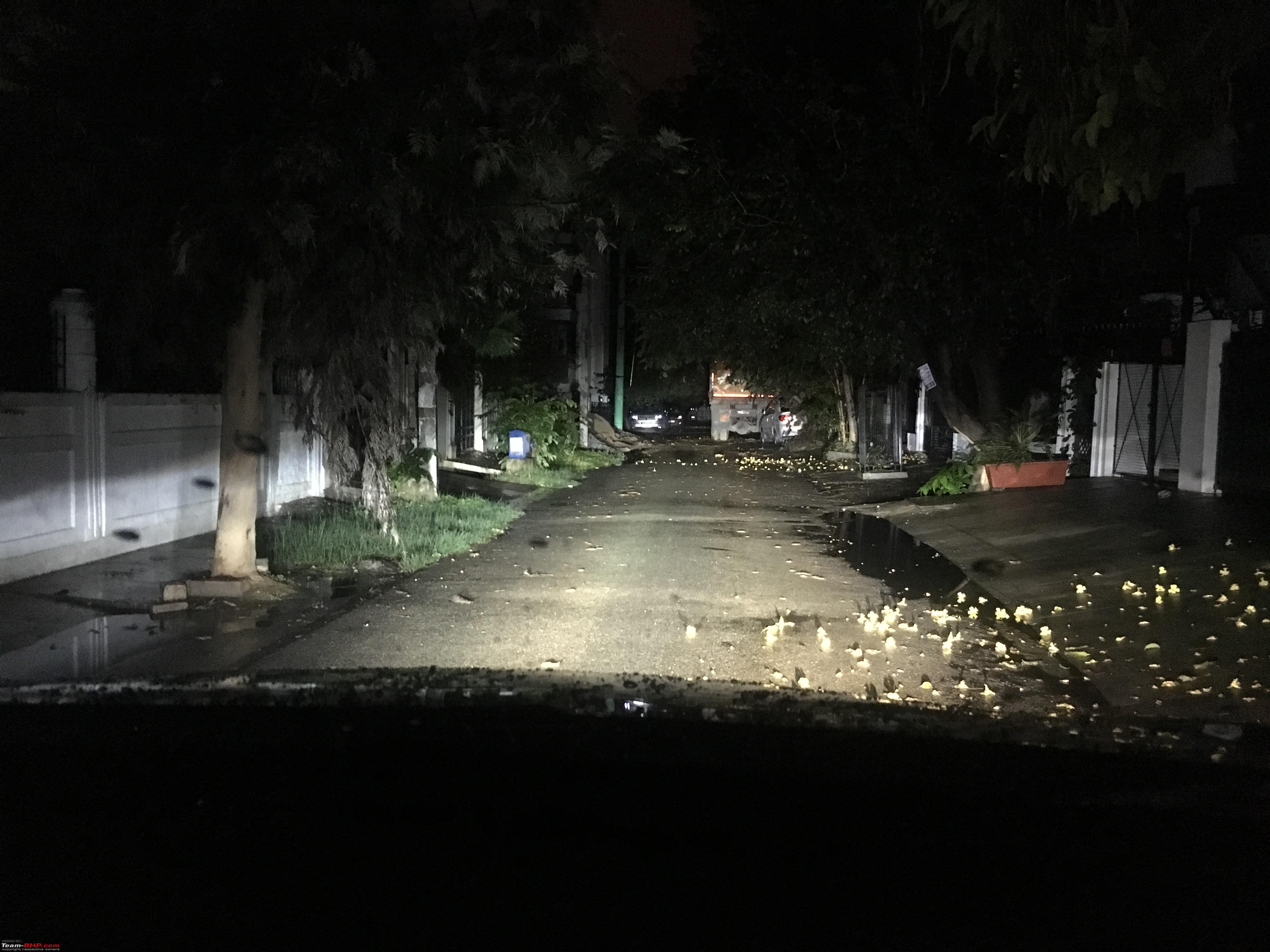

We had to wait for late evening and some darkness to fall in to check the output of the XP foglamps in my car. In the meantime, we decided to finish our well deserved lunch and then Anurag & Sudeepg started to work on Sendhil & Warun's (early adopters of XP) car to secure the ballast and wiring which was NOT done in safe manner earlier by the Hyderabad installer.

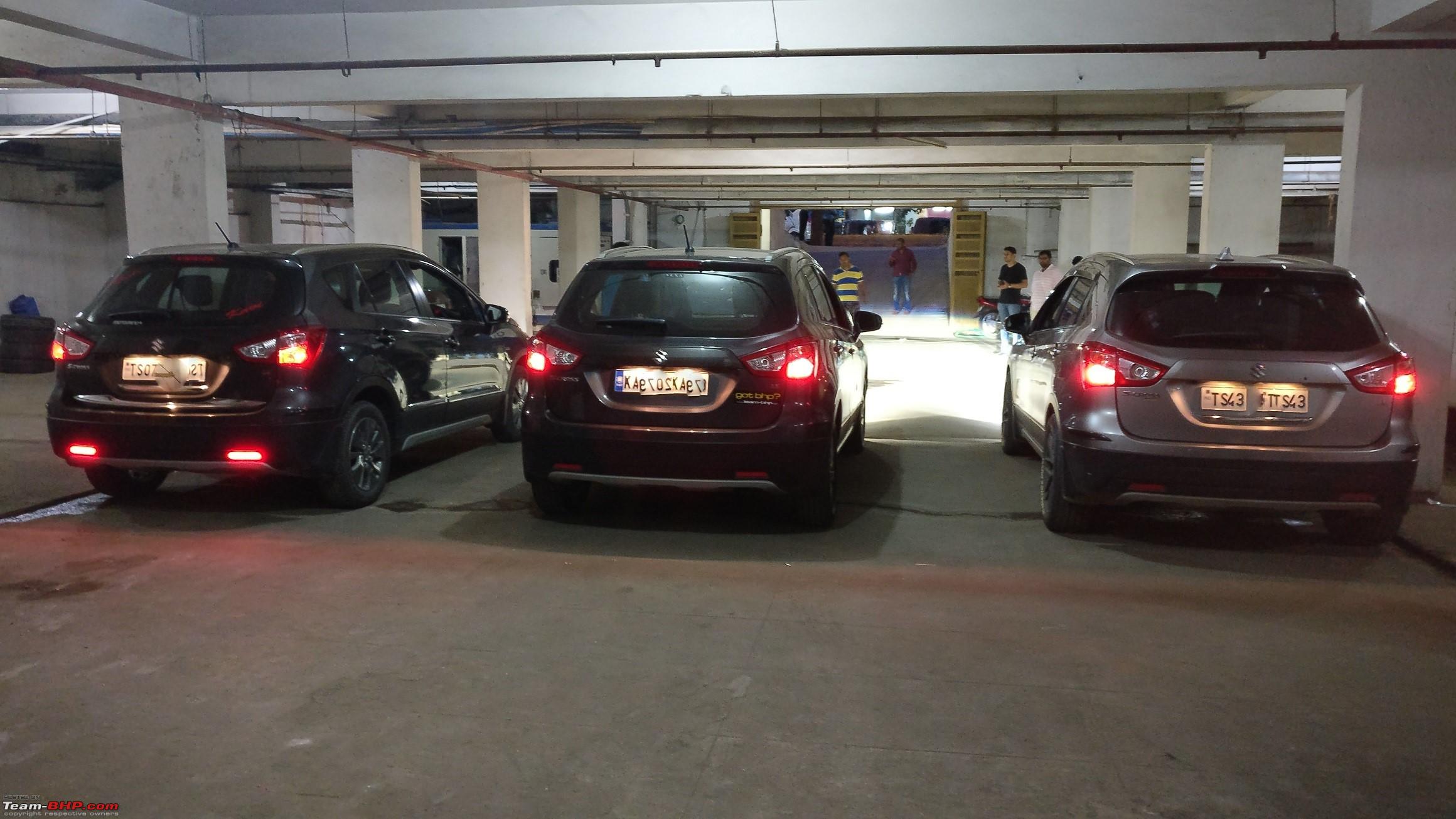

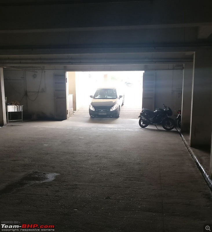

3'' inch XP Micro Fog-lights post install pictures :
Time was around 6 PM now and XP's require some running in to unleash its full potential
Next to Anurag's Blue Streak
With Warun's & Sendhil's Crossover - tusker being the hero of the day, stood in the center
Operation XP Micro: Projector fog lights for my S-Cross (Group DIY!)-3.jpg
Time to stare at each other
Operation XP Micro: Projector fog lights for my S-Cross (Group DIY!)-5.jpg
tusker leaving the operation theater successfully at 7:30 PM
Couple of pictures taken by co-passenger while on the move. This was within 15-20 minutes of hitting the highway back home from Karnool.

Filled up fuel on the way at Reliance and reached near Nandi Upachar Devanhalli at around 11:30 PM.
Total trip till Devanahalli
Operation XP Micro: Projector fog lights for my S-Cross (Group DIY!)-img_5682.jpg
Range left
Operation XP Micro: Projector fog lights for my S-Cross (Group DIY!)-img_5683.jpg

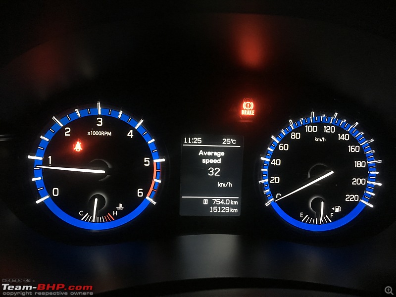

Average speed of the total trip till Devanahalli
Operation XP Micro: Projector fog lights for my S-Cross (Group DIY!)-img_5681.jpg

Update : Stock Headlamp vs XP output images
Thanks to the late night rains last night, the street lights were completely switched-off. This became a great opportunity to capture the light output post XP install. So stopped the vehicle for few minutes and took these from the driver's seat. Please note I'm still waiting for mismatch of bulbs to be corrected, however this has NOT impacted the real time performance of XP output. It is only from outside when someone looks at them the difference in color output is seen. Take a look
Stock Headlight Low Beam only
Operation XP Micro: Projector fog lights for my S-Cross (Group DIY!)-hl-low.jpg
Stock Headlight Low Beam + XP Fog Low Beam
Operation XP Micro: Projector fog lights for my S-Cross (Group DIY!)-hl-low-xp.jpg
Stock Headlight High Beam only
Operation XP Micro: Projector fog lights for my S-Cross (Group DIY!)-hl-high.jpg
Stock Headlight High Beam + XP Fog Low Beam
Operation XP Micro: Projector fog lights for my S-Cross (Group DIY!)-hl-high-xp.jpg

Hopefully the replacement pair of bulbs are a perfect match of 4300K, however we would know this only after removing the existing pair of bulbs from the car. I shall update the output pictures once this activity is completed.
Update: Bulb replacement activity in my car was completed last evening and it took just 30 minutes of time for fellow bhpian Sudeepg to do this
We removed the old bulbs and put in the new pair that was sent by XP team. This time they are an exact match in color temperature (4300K) and the output is excellent. Take a look
Operation XP Micro: Projector fog lights for my S-Cross (Group DIY!)-img6744.jpg
