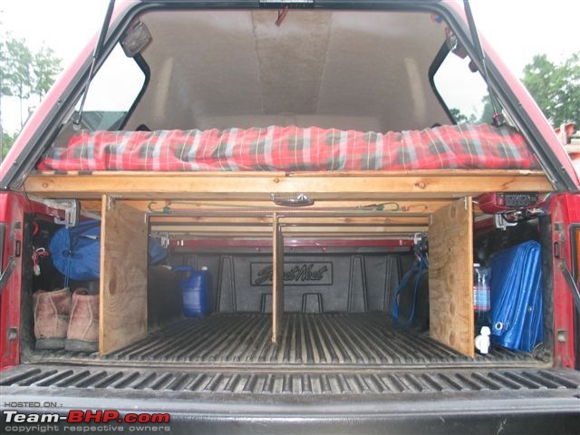

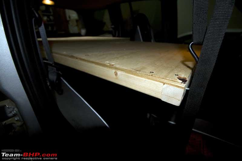

These are the images of one of the setups that I thought was quite simple to implement.

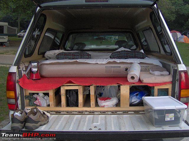

These are some more samples that I have come across. Looking forward to hearing everyones views before I go ahead with this small DIY project of mine.
Thanks.

Interesting project. Couple of questions, though:
1. there does not seem to be much headroom when sleeping, even to be able to get down when you wake up.
2. what is the lower section for ? If for luggage, will you have that much luggage ?

Thanks for the response condor. Please see image attached below.
1. The ply will be at a height of 2 and a half feet which is the same as that of the passenger seat. The scorpio being a tall vehicle , we shouldn't have a problem with headroom at that level. After all it seats passengers pretty comfortably
2. I will just have empty space and will not have any ply in the lower section so that we can dump luggage/ knick knacks, below the bed.
Since all the seats except the drivers seat will be removed , the vehicle will be suitable only for one man expeditions.
The other thing that I have been thinking about is to maybe have a hinge which can fold out for the two feet of space(length) which would enable me to retain both the front seats. This would be somewhat like shown in the 1st set of pictures above where the front passenger seat is folded all the way back when the bed is out . The hinge would then open up and cover the front passenger seat as well at bed time. The only thing here I would have to worry about in this scenario is the hinge being able to open up without getting stuck with the roof.
The whole structure would also need to be easily dismantable . I am thinking of anchoring the bed somewhere, where the jump seats have anchor points/ slots for screws/etc.

Just a warning, If the ply is a fixed kind then in case of an accident esp a rear ending (even a minor one) can be very fatal.

Thanks for pointing this out. I hadn't considered this.
Another thing that comes to mind could then just get a mattress/foam/bean bag cut to this size/stitched to this size and use it as the bed . This could also be rolled up when not in use as and when extra space is required.
The safety issue would be then be addressed. The disadvantage will be that we loose out on the space below the bed.

You need to leave more headroom IMO. There should be enough space to atleast lounge about. Imagine camping at Hundar or someplace really cold- u want to be able to sit inside nice and cozy with your drink or your book. (Also useful if u plan to get "active"! :P)
Ply is a bad idea. Ideal would be some kind of bunk (like the railway sleepers) fixed to the sidewalls that Folds down and locks into place.
PS: Saw a Bolero Guy camp next to my Gypsy in Solan once. While i camped in my gypsy, he setup his tent, regular one, on the roof of his Jeep! Cool idea IMO!

1. Thanks Cougar. I think you are looking at the set of pictures where the guy has a bunk bed kind of a system setup. His bed would rightly be a little too high and would have inadequate headroom. What I was proposing is to have the bed 2 and a half feet above the floor which is the same height as your regular seats. So if you sit on the middle seat of a Scorpio and have enough headroom, then you will be fine.
2. The coffee and book sounds good. Not much chances of activity in Ladakh unless you happen to fancy some mountain goats in which case the bed wouldn't make a difference:-P . But we can always live in hope, can't we :-)
3. The issue would be drilling holes to support the bed which may also weaken the frame. I would rather have something which I can remove and come back to once I am done with my trip/s where I can put the regular seats back in.

Not a good idea to have such structures built in back of vehicle. It would do you major harm if anyone rear ends you- the whole structure will become a projectile for front passenger/driver!! I think you should buy a good tent and a proper sleeping bag that can help bear the natural elements.. A much safer option i feel.
