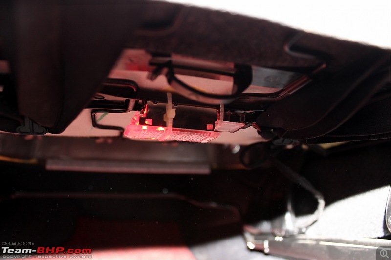

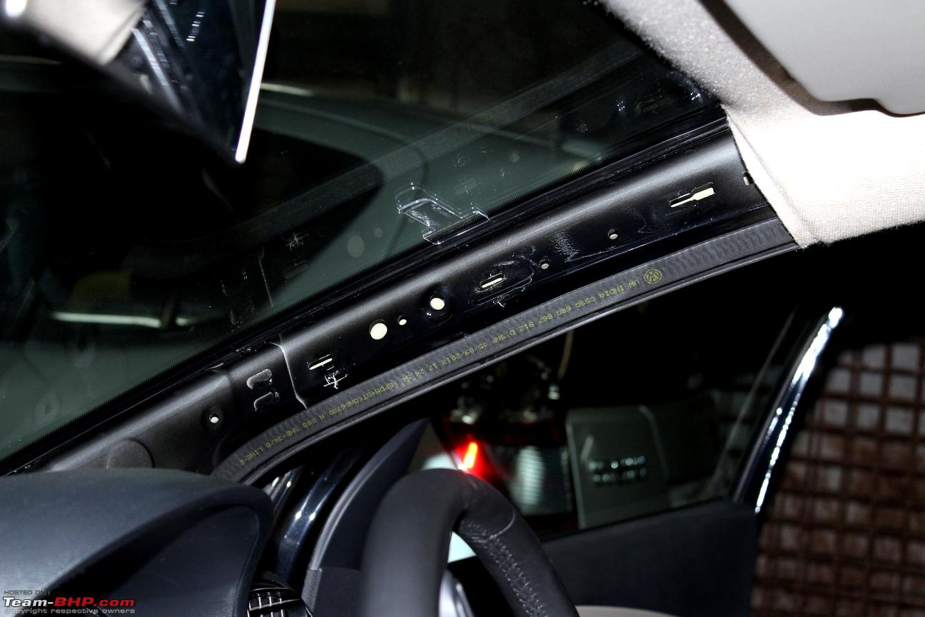

Layout:
VW Polo DIY: Upgrading cabin light, headlight switch & installing footwell lights-volkswagenpolo5door2009.gif
Procedure:
1. Follow steps 1 to 3 from DIY #1 posted above and remove the dome light.
2. Prepare the soldering iron. Using a hand file, file the bit of the iron and get rid of the old solder/dirt stuck to the tip. The tip should look bright copper in color with all the dirt removed:
VW Polo DIY: Upgrading cabin light, headlight switch & installing footwell lights-img_6485.jpg
Turn it on and leave it aside for 5-10 minutes.
3. Using a hobby knife, scratch the copper leads of the cabin light at the locations indicated below:
VW Polo DIY: Upgrading cabin light, headlight switch & installing footwell lights-img_6495.jpg
4. Prepare the cables. Cut the 4 m cable into 4 parts - 2 parts of 10 cm each and 2 parts from the remaining length. Strip the ends, twist them, apply some flux and some solder on one end of the smaller cable.
5. Solder the 10 cm cables to the leads prepared in point no. 3 above and connect a luster terminal to the end.
VW Polo DIY: Upgrading cabin light, headlight switch & installing footwell lights-img_6498.jpg

6. Pry open the A-pillar trim and run the 2 long cables from the dome light slot through the driver-side A-pillar to the area below the steering unit.
VW Polo DIY: Upgrading cabin light, headlight switch & installing footwell lights-img_7056.jpg
VW Polo DIY: Upgrading cabin light, headlight switch & installing footwell lights-img_7060.jpg
VW Polo DIY: Upgrading cabin light, headlight switch & installing footwell lights-img_7075.jpg
Stick the yellow cables to the A-pillar using the double-sided tape and replace the A-pillar trim:

10. Connect the footwell lights to the connectors at the respective locations. The Indian spec'd Polo has only one slot for the footwell light which is for the driver side footwell:
VW Polo DIY: Upgrading cabin light, headlight switch & installing footwell lights-snri4d7.jpg
VW Polo DIY: Upgrading cabin light, headlight switch & installing footwell lights-img_7225.jpg
Co-driver side footwell:
VW Polo DIY: Upgrading cabin light, headlight switch & installing footwell lights-img_7227.jpg
Rear footwells below the front seats:
VW Polo DIY: Upgrading cabin light, headlight switch & installing footwell lights-img_7231.jpg
VW Polo DIY: Upgrading cabin light, headlight switch & installing footwell lights-img_7233.jpg
VW Polo DIY: Upgrading cabin light, headlight switch & installing footwell lights-img_7237.jpg
11. Test the lights using the keyfob:
VW Polo DIY: Upgrading cabin light, headlight switch & installing footwell lights-img_7219.jpg
VW Polo DIY: Upgrading cabin light, headlight switch & installing footwell lights-img_7191.jpg
VW Polo DIY: Upgrading cabin light, headlight switch & installing footwell lights-img_7209.jpg
