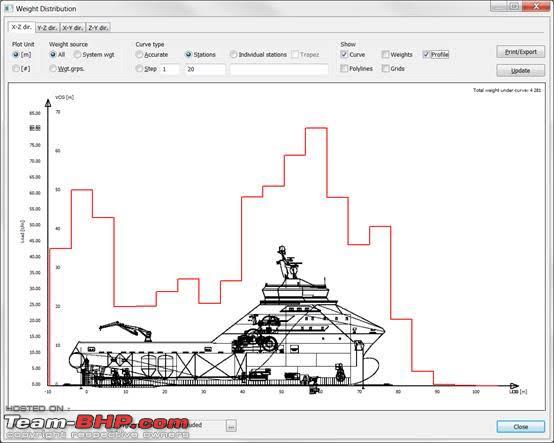

The entire hull weight is transferred to the dock blocks. In addition to the docking plan, the weight distribution curve also provides the length-wise weight distribution, bending moments and CG. Something like this:
