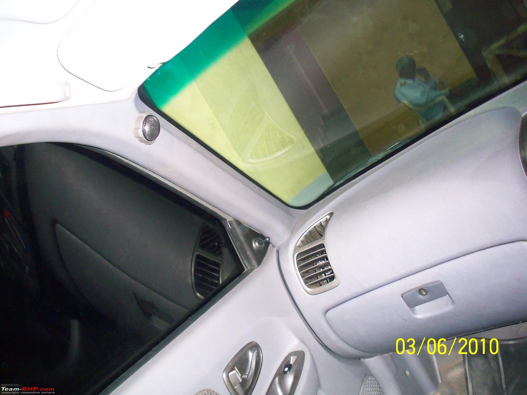

I have the following setup in my Accent,
HU : Pioneer DEH-P4050UB
JBL GTO-608C Components in the front.
JBL GT5-S396 Oval Speakers at the rear.
I am attaching 2 pics which show the placement of the Tweeters.
Car Audio Advice from the Audio Gurus: Use "Search thread" before posting a new Q!-100_0568.jpg
Car Audio Advice from the Audio Gurus: Use "Search thread" before posting a new Q!-100_0569.jpg
Please advise whether this setup is fine or do I need to change/add something over here.

Originally Posted by shantanumishra View Post
Pls reply to my query.
The tweeters look set way to high. With that much distance between the midbass (which I assume is in the door) tweeter-midbass integration will be compromised.
But now that you have made holes and damaged the A pillar I dont see what can be done. It would have nicer if the tweeters were much lower down near dash corners.
