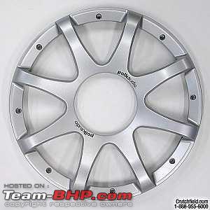

I would not recommend a fiberglass grill. A metal grill is much easier as the mesh is already readily available and all you need to do is cut and shape it and add a trim.
I already have one grill with me.Let me give a second thought.I was planing to make something like this,and i know i cannot make one exactly the same .Fit and finishing will be problem
Car Audio Advice from the Audio Gurus: Use "Search thread" before posting a new Q!-grill1.jpg
Car Audio Advice from the Audio Gurus: Use "Search thread" before posting a new Q!-grill2.jpg
Oh I was thinking about the plain vanilla mesh grills from the past. These new fangled grills look more like hub caps than speaker grills and do not protect the cone from smaller objects or prying fingers.
