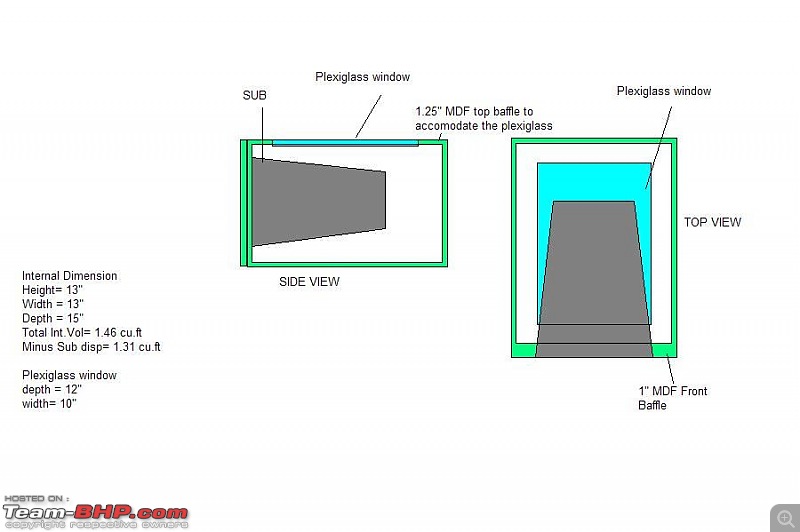

guys. i need suggestions about the enclosure. Ajay bhai has suggested an inverted install with a sealed FG enclosure with a volume of 1.2 cu ft.
I was also thinking along the lines of an MDF enclosure with a Plexi window. This design has been suggested by Invinsible.
Here's how it looks.
Which would be better? I would prefer FG since one can make it look plush and utilize a nook/corner in the boot.
The mDF/Plexi with a few lights inside would look like 'cool maal.'
Waiting for suggestions. I know for a fact that the FG enclosure (if made thick) will sound better. The MDF/Plexi enclosure might have air leakages due to plexiglass and the plexi might flex too..
Please advise!

Dude please don't do the plexi, go for the fg with mdf for flat surfaces, lots if bracing and 2 layers of csm, you won't regrett.

How thick will be the plexi glass ?

That box design was suggested considering 500 rms amp that was available before. With the new amp I suggest you get the enclosure made in 1" MDF on all sides accept the front and the top baffle which would have the plexiglass. Needs to be done with 1.25" -1.5" thickness.
The plexiglass will be 18-20mm. Also make use of bracing on all the joints with layer of FG on the inside wall of the enclosure. Add 16-20ounce of poly fill on all the inside sidewalls to cut/absorb those standing waves.
Complete FG sealed enclosure in this case might take same or more amount of space since the mounting depth of the sub itself is around 10".
Also i strongly suggest the enclosure would need to be around 1.3/1.4 cu.ft net volume for a good low end ext. output.

Also I like to add that FG enclosure might add a bit of resonance unless it's deaden, although many would disagree here. A good FG enclosure would require minimum 4layers and good 8 layers. You could also use HDF/HDP instead of MDF. i would still go in for a good MDF enclosure.
The plexiglass will be 18-20mm. Adding some LED would be great
Frank wrt light I have one rule for Audio - "If you want lights go buy a christmas tree".
Go FG. The enclusre will be a triffle smaller as the wall thicknesses will be less.

Hmm. So fibre glass vs mdf seems like the debate all over. yes, FG has to be thick.
Which one of the two has better acoustic qualities?
