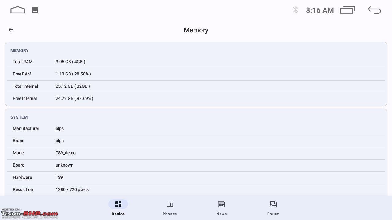

I installed CPU-Z and was surprised to see 4GB RAM and 32GB ROM. Was this for real?

I researched a bit more and got to know that apps like CPU-Z/CPU-X/AIDA64 read the specs from OS and firmware. So if you can fake the firmware, you can fool these apps too!!

CPU-Z was the worst of the lot, reporting all specifications same as advertised.
