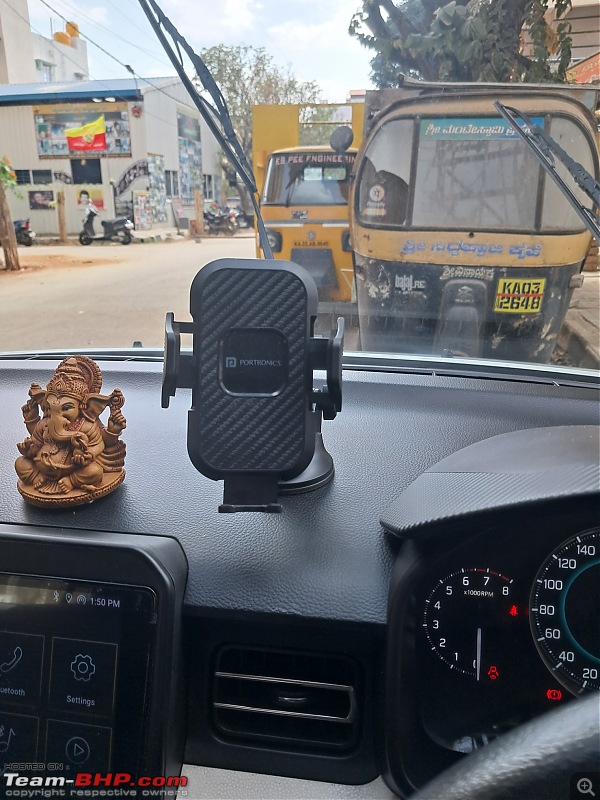

I used a mobile holder to view google maps while travelling out of town.
Installing a Tesha 9" Android Screen, Dash Cam, Problems Faced and Review-20240128_134941.jpg
The holder had to be mounted on the dashboard. Could not find any other place where I would be comfortable or it would not obstruct my view. When I was travelling to Goa in November 2023, the phone got heated due to the Goa Sun and the phone switched off. The phone would get warm while using navigation. Add the hot goa sun, the phone could not handle it.

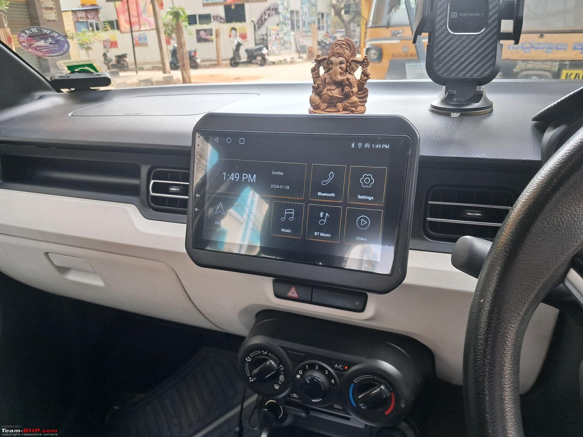

I decided to upgrade the old music system to an aftermarket Android Screen. I bought an Tesha 9" Android Screen from Amazon. It set me back by ₹8.5k and also bought a cheap aftermarket rearview parking camera for ₹650. The local garage near my home asked for ₹800 for android frame and another ₹800 for labour.
The android screen came with all the necessary plug and play wires for sound, additional microphone and GPS unit. I could train the system to my steering mounted switches. I listened to my favorite songs using Music app with Android auto on my drive back home. The rear camera view was grainy as expected. But it was an important utility to park in tight spots.

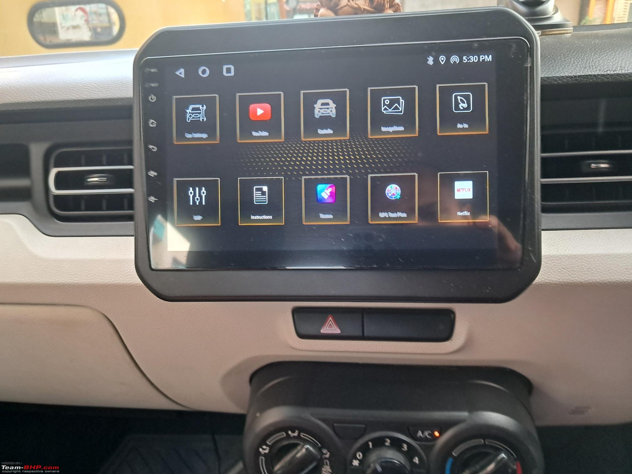

Installing a Tesha 9" Android Screen, Dash Cam, Problems Faced and Review-andriod-screen.jpg

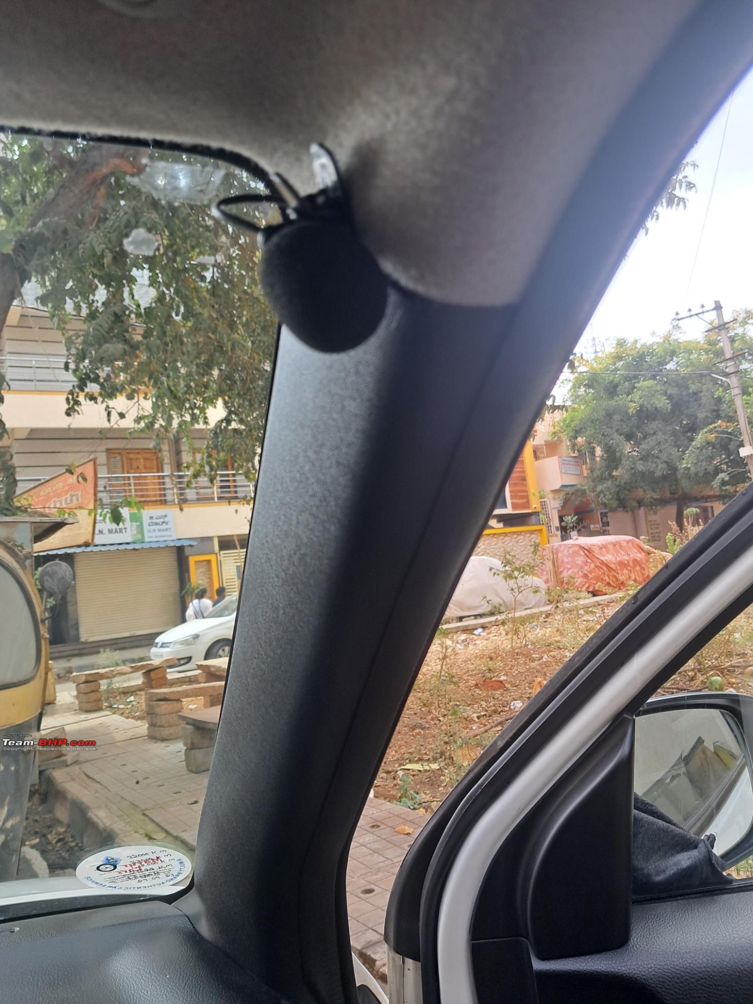

Installing a Tesha 9" Android Screen, Dash Cam, Problems Faced and Review-external-mic.jpg

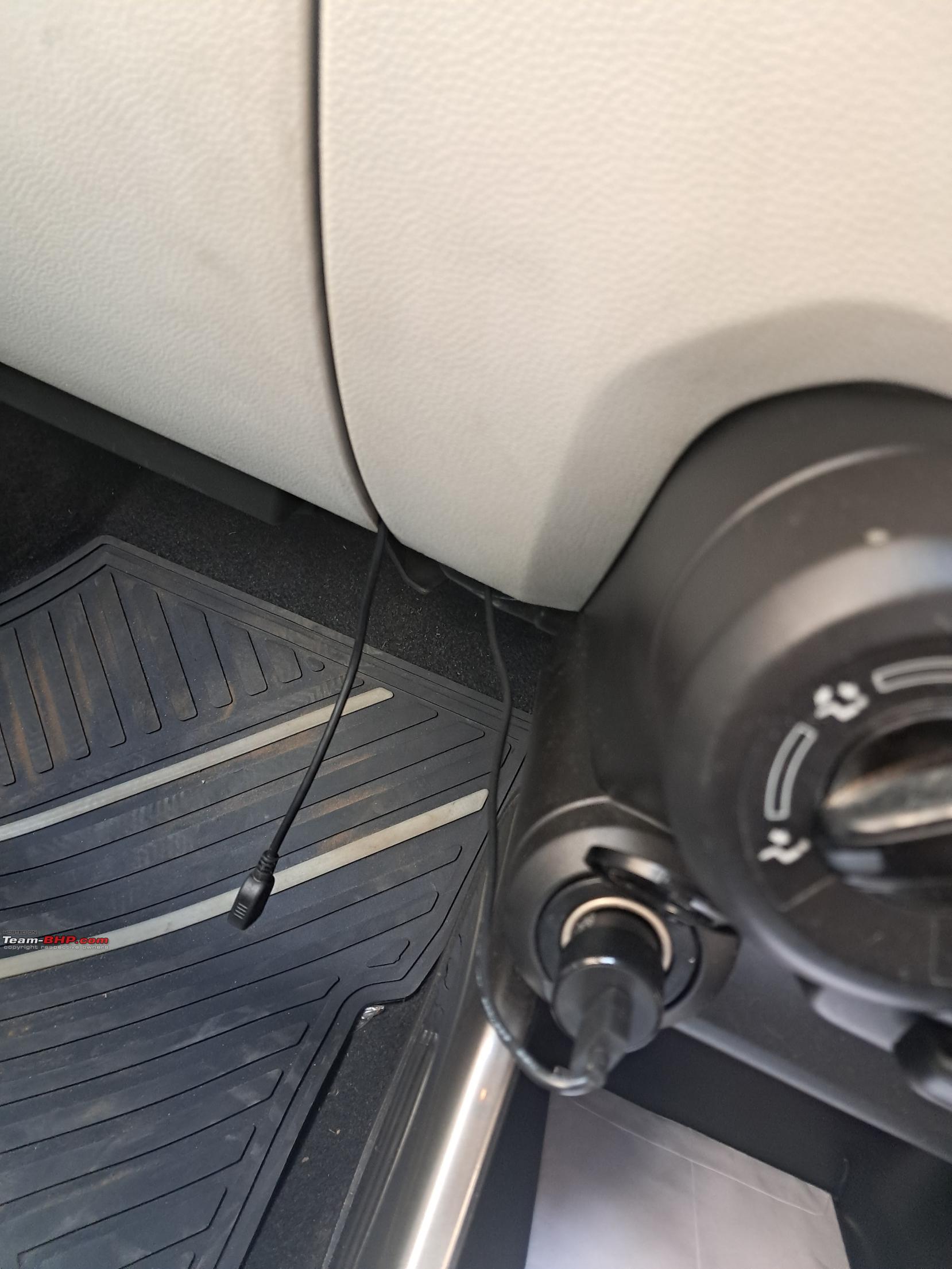

Installing a Tesha 9" Android Screen, Dash Cam, Problems Faced and Review-dashcam.jpg
Installing a Tesha 9" Android Screen, Dash Cam, Problems Faced and Review-charger-dashcam.jpg

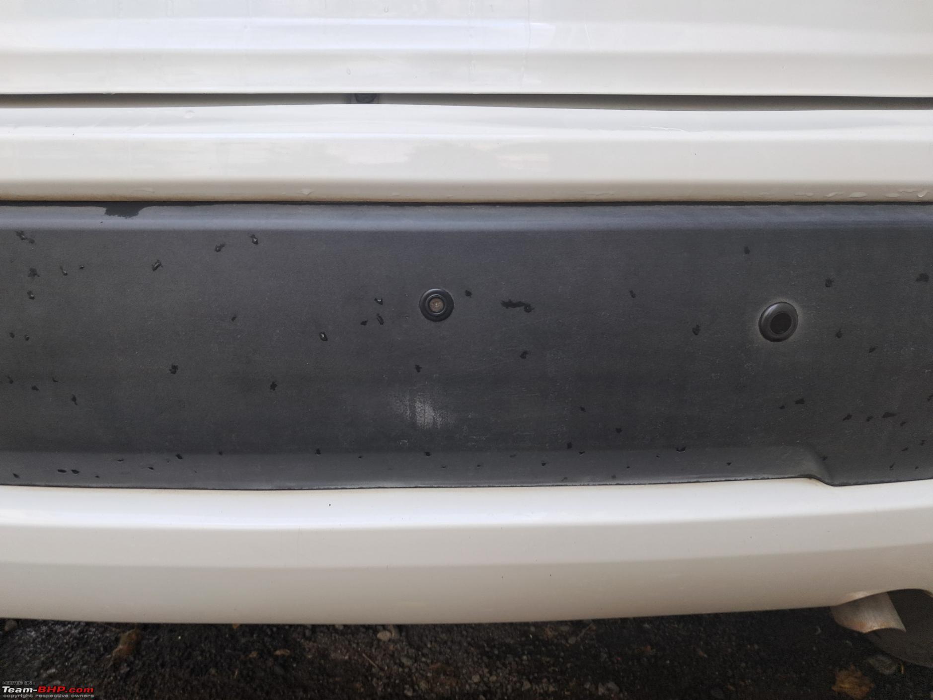

Installing a Tesha 9" Android Screen, Dash Cam, Problems Faced and Review-rear-view-camera.jpg
