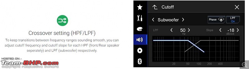

Old 19th April 2018, 09:59   #821
Alfa_Romeo1's Avatar
Join Date: Apr 2018
Posts: 46
Thanked: 39 Times
Re: Queries in 'Ask the gurus' section
Hi Navin Sir,
I discussed with the installer and he is proposing configuration as below:
1. HU : Pioneer MVH-A209VBT, 12.5k
2. Amp : Pioneer GM-D8604 Class FD 4 Channel Bridgable with Bass Boost Remote, 13k
3. Sub : Focal Performance Auditor + RSB 300, 6k (Sub may be changed after auditioning.)
4. MDF Box : Some readymade box, 1.5k
5. Wiring, RCA : 5k
6. Damping : Front doors : 3k
7. Harness : 0.5k
8. Frame : 2.5k
9. Labour : 1.0k
Total : 45k
He said these are prices without discounts (except for HU), final prices will be negotiated on saturday, day of installation. Please share your feedback on this.
Also one question from my side regarding having two amplifiers - one monoblock and one four channel. As per him, four channel amp should have HPF setting and gain control then only we can set appropriate cutoff for frequencies. Such four channel amp would cost me starting from 8k-10k.
Now I dont understand, Pioneer India website says for shortlisted HU :
Crossover settings (HPF/LPF) - To keep transitions between frequency ranges sounding smooth, you can adjust cutoff frequency and cutoff slope for each HPF (front/Rear speakers seperately) and LPF (subwoofer) respectively.
https://pioneer-india.in/buy/car-ent...s/mvh-a209vbt/
My doubt : Is it necessary to have HPF and gain settings again on four channel amps for front/rear speakers while I use monoblock amplifier for the subwoofer. Please guide me on this.
As of now believing him, I am planning to go ahead with four channel amp to drive front components and sub, Later on when budet permits, I will add nice monoblock for subwoofer and use current four channel amp to power four speakers.
Alfa_Romeo1 is offline

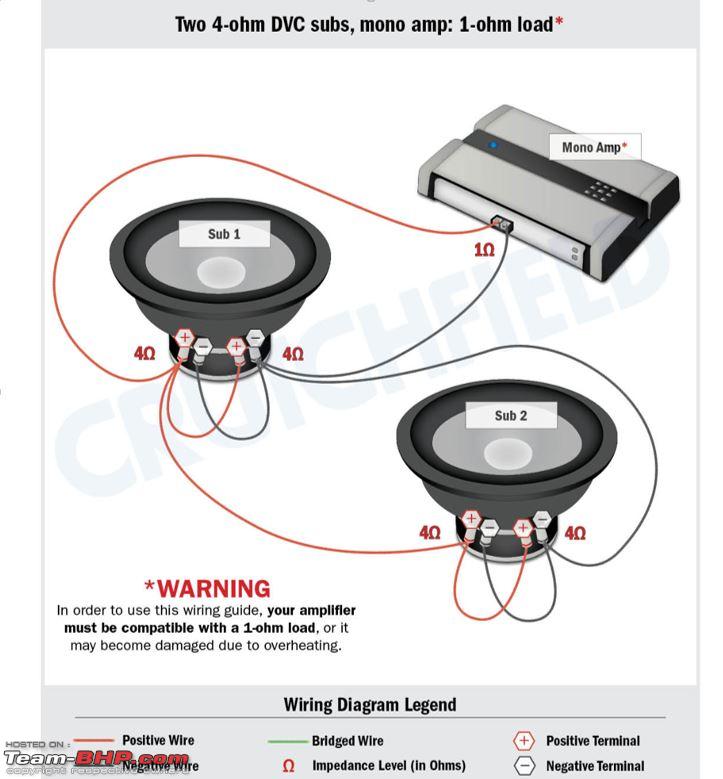

Old 27th April 2018, 10:48   #822
Join Date: Apr 2018
Posts: 46
Thanked: 39 Times
Hello guys, I completed setup as per above posts in my car, sound clarity increased by leaps and bounds. Absolutely droolworthy. Many thanks to Navin for suggestions.
Now I want to further up the game by adding another 12” sub and hence the hunt for monoblock has begun.
To summarize, current setup looks like this:
HU – Pioneer MVH-A209VBT 2 DIN
Front components – Focal Performance Access 165 AS
Rear co-axials – Focal 165AC
Sub – Focal Auditor+ RSB300 12” (DVC 4 ohm)
Amp – Pioneer GM-D8604 to drive front speakers and a sub.
Now to drive two subs, after talking with google bhai, I gathered following layout which will be the best. Please let me know if you think otherwise.
For this power requirement, I have shortlisted following amps :
1. Rockford fosgate Prime 1200 (https://www.amazon.com/Rockford-Fosg...ate+Prime+1200)
2. Pioneer GM-D9601 (https://pioneer-india.in/buy/car-ent...mono/gm-d9601/)
Both are stable under 1 ohm.
Can you please suggest which one is good? Any other suggestions are most welcome. Budget 15k, can go up to 20K max. Will source it from US.

Thanked: 15 Times
Can the Focal 165 AS be paired with Blaupunkt 470 DSP amp?
I'm planning adding this set of components on front doors of my Fiat Avventura and adding the Blaupunkt 470 dsp amp. Will look for a decent set of co-axials for the rear doors.
Why not? Most car speakers and amplifiers are compatible.
There are a few 1ohm and 2ohm speakers which may prove to a difficult load for all but the best built amplifiers but other than these rare exceptions they are all compatible.
