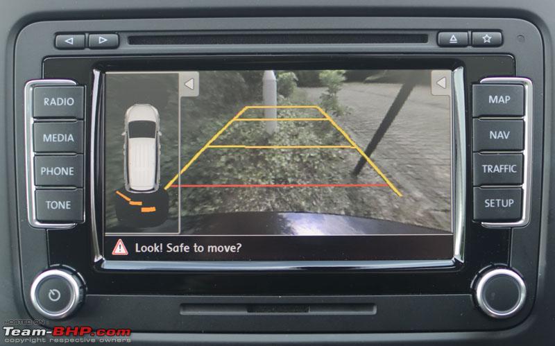

To those using the RCD330 plus along with reverse camera and optical parking sensors - could you please confirm if the RCD330 plus shows the parking sensor display along with the reverse camera image?
for reference, The RCD/RNS 510 shows like this:
Hi,
If you install OPS along with rear view camera in RCD 330 then camera is activated by default when you engage reverse gear. You get an option to choose OPS display but at any point of time only one function is available.
Overlap between video from camera and OPS is not available in RCD330.
Regards.

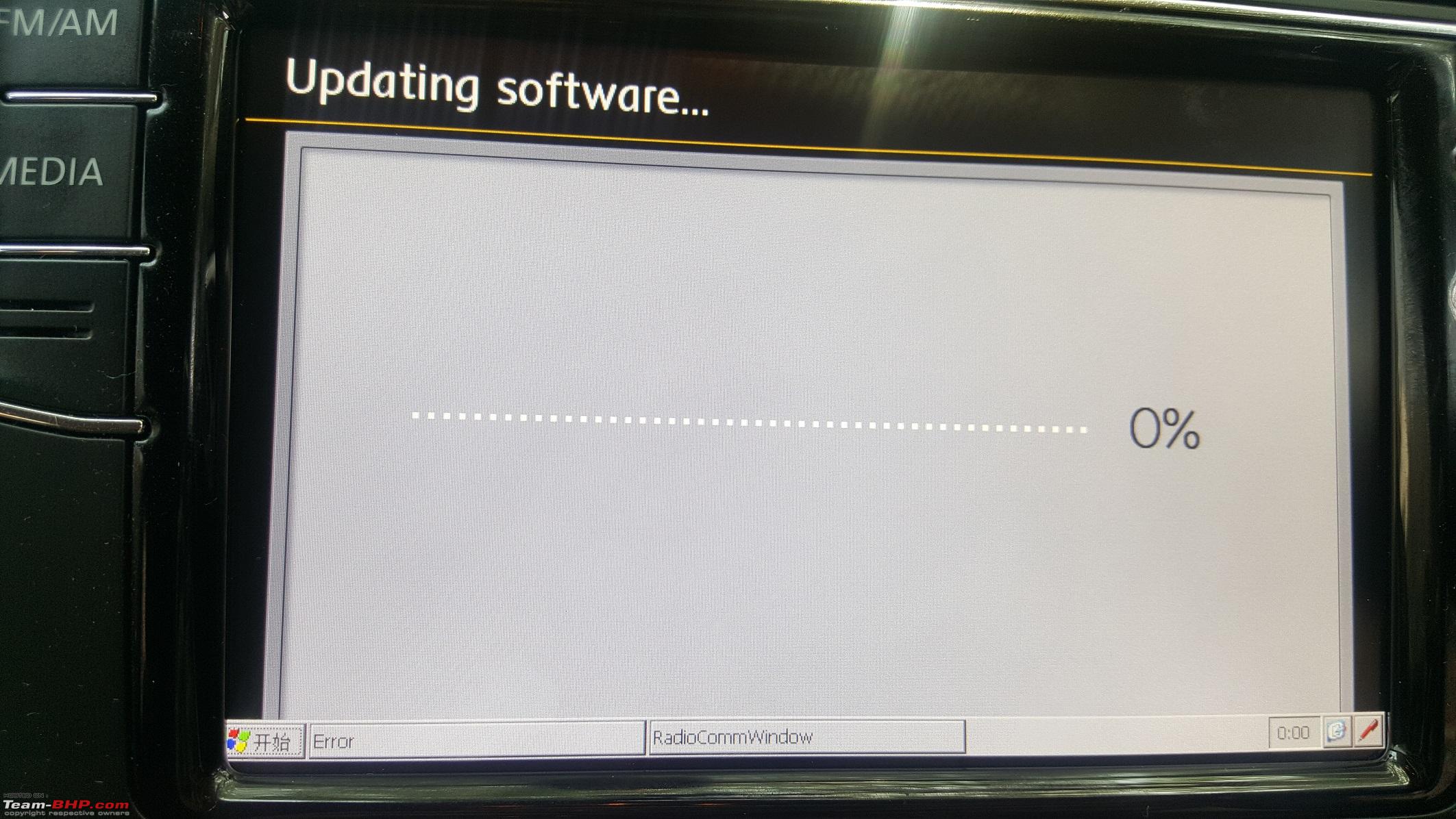

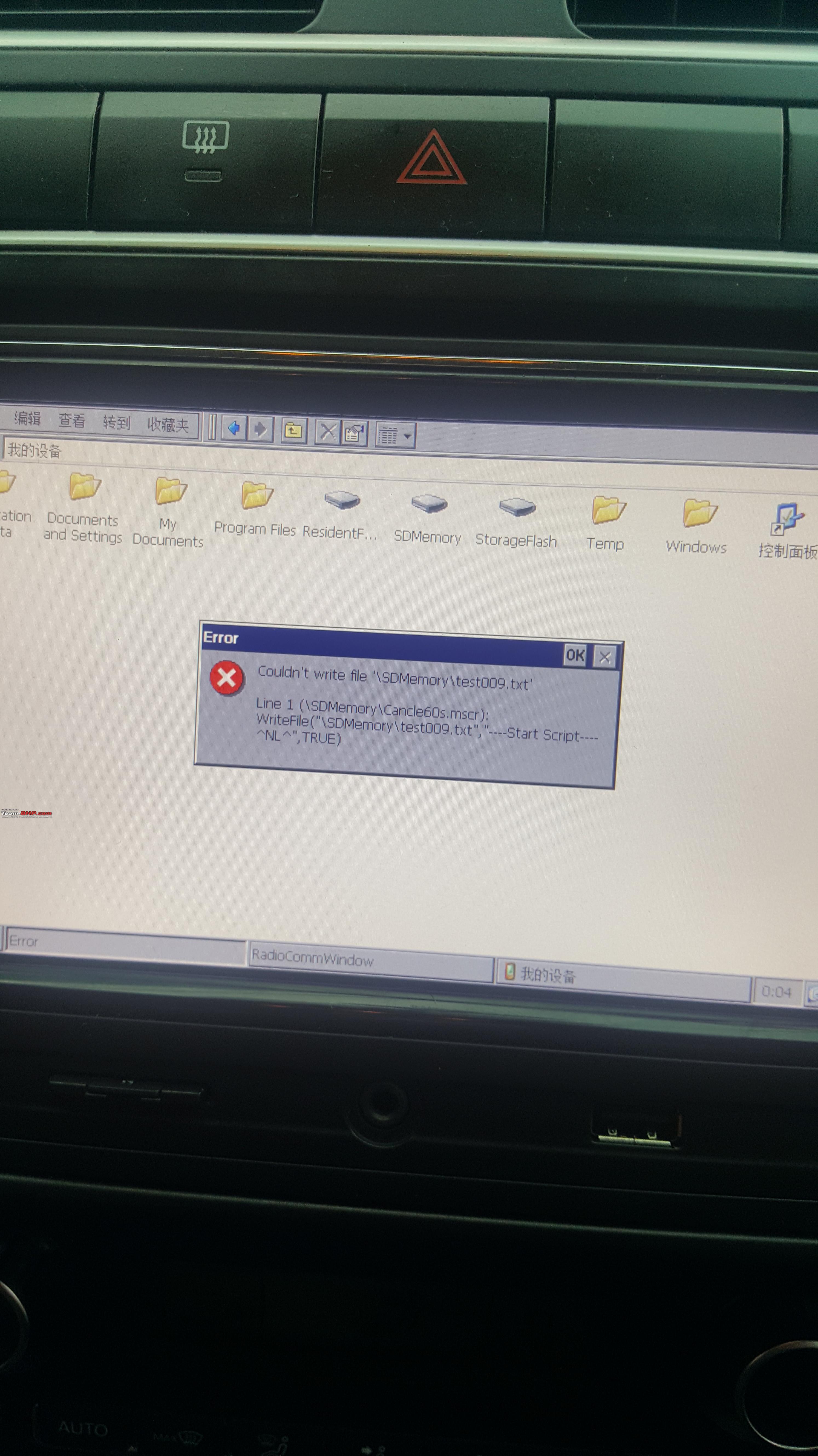

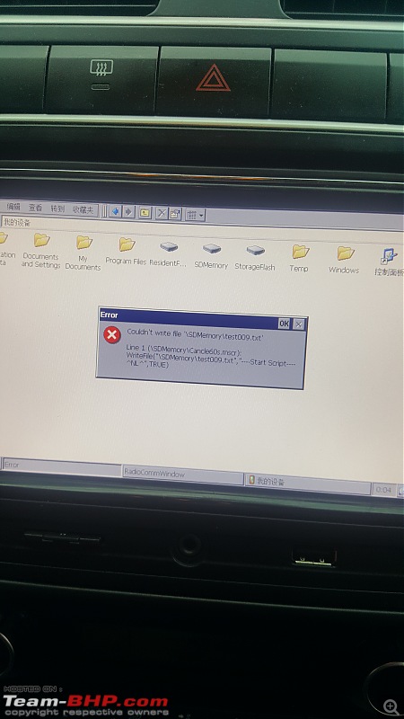

Dear members,
I met an unexpected dead end while trying to update the firmware of my RCD 330g plus 087A with the Red theme update. I have been trying to update to red theme but when I selected Update software and then update NAVI. AFter that there was no blue windows CE screen, it is stuck on Software Updating window 0%.
There is also an error tab opened at the bottom, I have attached image of the same.
I tried to run Total Commander using the RUN fuction and successfully copied all the files but still when I restart the player by long pressing the power button it comes back to the Software updating screen.
Anyone else who has faced similar issue while updating the firmware?
Attachment 1743609
No it doesn't show it by default. Not sure if there is any setting to make it do that.

Originally Posted by Mr.mitsuvolk View Post
Dear members,

Re: VW Polo/Vento : Replaced stock RCD320 with RCD330 Plus + rear view camera installation guide
Originally Posted by navdeep.rana View Post
Yes this is what I tried but unfortunately it did not go this way. Now I don't know how to get rid of the error and make my music system function the way it used to.
Do you have any leads on this?
