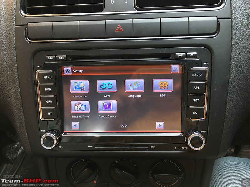

I have installed this HU in my Polo ,bought from the same link. I did the DIY myself.
After operating the HU ,my initial reaction was WOW. Radio works very well,Navigation is superb,Connects to my Iphone very well and the call quality over BT is excellent. The Video Playback is superb. Total Cost incurred is 10800+4612(customs) = 15412. fitting cost ZERO. I am attaching the photos to help in your decision making process.
Edit: I have the latest map installed i.e. 2015 Q2. Map Supplied is 2014Q3. You Don't need internet for Navigation. HERE Maps are preinstalled on 8GB MicroSD card.

Very neat, and great price too. Here comes pics of my installation.
