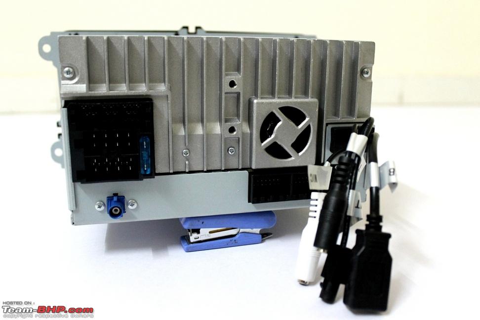

| Re: [To be merged with my ownership thread] Updates! Swapped the stock RCD320 HU with the Blaupunkt Philadelphia 835 unit. ![]() ![]() ![]() The stock system (RCD320) was not a bad performer per se but there were a few hiccups I had faced over the last 3 months of usage. Listed below are some of my observations on this aspect: 1. The sound quality was just about okay. The bass felt overpowered and the mids were washed. 2. The sensitivity of the mic was poor. As a result, the call clarity at the receiver’s end turned out to be pretty bad. One of the reasons being the positioning of the mic. The mic is located on the top-left corner of the HU since this is a unit originally designed for the European or LHD cars. Unfortunately, the same unit made its way into the RHD variants as well and as a result the mic is on the co-driver side. 3. The HU could not sync the contacts from the phone. Thus, the unit could only dial the last dialed number on the paired phone. To make a call, we have to ultimately use the phone to search for contacts and dial. Receiving calls worked well regardless. 4. The HU lacked the required CAN support for displaying visual feedback while reversing the car. Ironically, the older RCD310 HU had this support! (Link) 5. The system lacked a wireless remote. Take it as nitpicking if you'd want to but a no-frills basic stereo system such as the one onboard the Toyota Etios has one! That said, there in an Android/iOS application which can be used to control some of the features of the HU after pairing the device with Bluetooth. But nothing beats a standalone remote for the passengers seated on the rear. 6. The HU wouldn't display time! The only indication of time was on the MID visible to the driver. Purchase & Installation: And then the search for a better HU began. The RCD510 (starting from 26k, there are several variants of it) was a good system but lacked navigational features. Bluetooth integration with the system for sync’ing contacts required an additional expensive BT kit, a separate BT mic and then some. Ultimately, for a fully functional system the pricing was well over 50k INR. And installation was a concern since we do not have a competent garage like Vagtune/Pete’s here to do these kind of installations. So I thought, heck If I am upgrading, I might as well get a fully functional system which had all the features built in and the Philadelphia 835 from Blaupunkt was the perfect solution. To top it all, member Rajeevraj recently installed it on his Vento TSI and he had only good things to say about it. That almost sealed the deal! We were in touch over PMs and he was extremely helpful in answering the queries - however stupid they may have been. I had posted on Blaupunkt India’s Facebook page and they sent me a mail with all the details, the very next day morning. Impressive customer support right from the start! I had a few technical queries as well and all of them were promptly answered by Mr. Murugesh Palani Durai, Product Manager - Operations & Logistics who had later directed me to Mr. Anurag Jain, the Territory Sales Manager for Gujarat & MP. I noticed that Snapdeal was running a massive discount for the system at Rs. 42679 inclusive of shipping after discounts. But I thought maps weren’t a part of this deal and I may have to pay for it separately but I was wrong! When I received the shipment 2 days later, a MapmyIndia Aura pack was included in the bundle! I was completely taken aback! That wasn’t the best part. That comes next. The next day morning, I called up Mr. Anurag to find out a skilled installer in Surat. He directed me to Chetan Motors and suggested that they are the installers for Blaupunkt systems in the city. We went to the shop, spoke to the person in charge (the boss Mr. Chetan hadn’t arrived then), dropped the car at their underground garage and his team began working on it. They figured out that the steering controls weren’t working as they should. The reverse assist display wasn’t appearing on the HU screen either. Something was wrong and they were fiddling with the wiring. Then, they called up Blaupunkt’s technical support and they resolved the issue mutually. I was at work when Mr. Murugesh sent me a mail saying the issues have been resolved. I was delighted! We went to the garage after work, met Mr. Chetan (the garage owner) and it was time for settling the expenses. He wasn't willing to accept a penny from me! I was shocked, for his team had spent at least 2-3 hours installing the equipment in the car and resolving the steering control issues. He said that he'd received the call from Blaupunkt India office (presumably they did not want him to charge the customer?) but I wasn't willing to leave the garage unless I paid him so I gave him a 500 Rs. note. He returned back 300 Rs. Then we went down to the garage to pick up the car and I saw the technician working on another car. Slipped a Rs. 100 note into his shirt pocket, smiled and we fled the scene. Overview: As many of you may be aware, the unit was specifically manufactured by Blaupunkt for Skoda, Volkswagen and SEAT cars evident from the front fascia of the HU and has been indicated in their press release: ![]() The box: ![]() Btw Blaupunkt means blue dot or point in German. To get an idea about the size of the box, this snap should help: ![]() The eco-friendly and biodegradable egg carton-type enclosure and not the usual Styrofoam/polystyrene material - Good job Blaupunkt!: ![]() The HU snug-fit inside the casing: ![]() The contents inside the white box: ![]() L to R (from top-left, clockwise): Connectors & cables, user manual, GPS antenna, external wired mic & antenna connector (inside the blue pouch), cleaning cloth and stylus ![]() The HU up close: ![]() ![]() The SD card, USB and TRS aux. input slots: ![]() The microSD card slot for maps goes here: ![]() Rear of the unit with the Alu. heatsink-back and the tiny exhaust fan: ![]() The blue connector (bottom-left) is where the GPS antenna attaches itself. Notice the bundle of cables to the right. The unit is Made in China: ![]() The multi-lingual manual: ![]() Installation was pretty much straight forward and no wires had to be cut or trimmed so I am assuming VW wouldn’t create any issues during a warranty claim but only time will tell. *touchwood* The external wired mic for Bluetooth was located near the IRVM: ![]() The cable was concealed within the headliner and routed through the co-driver side A-pillar plastic trim. The GPS antenna was stuck to the corner of the dashboard using double-sided tape: ![]() The 7” display with the 800 x 480 resolution is pretty good and crisp for a HU display among many Pioneer and Kenwood units I have seen so far. Touch sensitivity is good. We have been pampered by the displays on our smartphones, Retina display Macbooks, iPads and whatnot, this one seems to be from the Stone Age! But jokes aside, this is one of the best resistive touchscreens on any HU I’ve come across. During playback of music, album art is displayed on the screen provided it is properly embedded within the song. ![]() ![]() ![]() One word regarding the sound quality of the system - incredible! I think this is the second HU upgrade in the cars that our family has owned so far (the first being a Sony back in 1999 on our Zen LX). The difference from the stock system in instantly noticeable in this one. Startup screen: ![]() The backlighting color on the buttons can be adjusted from a matrix of 256 colors, which Blaupunkt refers to as the VarioColor mode. I chose to go with red since it blends well with the backlighting of the Polo’s other systems. I've posted a few snaps of it in the next post. We also tested the DVD playback using a regional movie DVD and it played just fine. IMO Blaupunkt should have come up with a cheaper CD-only version of the same HU as well retaining the same DAC. I mean, not all of us are going to watch movies on the go but listening to music? Definitely! While reversing the car, the display shows a park assist screen from the installed sensors on the rear bumper including the proximity from the object: ![]() The volume of the music is automatically lowered by the system and beeps are heard when the reverse mode is engaged. Disengage the reverse gear and the original volume is restored. Definitely helps when the car has to be parked in tight spots like our apartment's allotted slot: ![]() If there are sensors on the front bumper (for instance, the Passat), it shows the proximity of the object from the front bumper as well: ![]() (Source: Google Images) If a camera is installed at the rear bumper, pressing the tiny camera icon on the display switches to the camera view. Unfortunately, the Polo (and Vento) lacks the required CAN bus support for the ACC system so the display does not switch while changing the AC settings. However, for the Jetta, Passat, Laura and Superb, it will. Like this: ![]() (Source: Google Images) The built-in navigation feature is a Godsend! We have lost count of the number of times we have relied on our smartphone’s GPS during our recent trips to Ahmedabad and Bombay. And 9 out of 10 times, it worked well. Using the navigation feature from the HU is a breeze. Pop in the bundled microSD card from MapmyIndia into the slot, press the navigation button, choose the language, enter the default settings, accept the license agreements and the map would load indicating the current location of our car. ![]() ![]() ![]() The only gripe right now: ![]() Must think of an alternate routing for the USB cable. This one sticks out like a sore thumb although it doesn't interfere with the driving in any way. I had originally thought of routing it through the glovebox but that requires drilling a hole - not really worth it and it may spoil the looks. Last edited by Gannu_1 : 5th January 2014 at 19:05. |

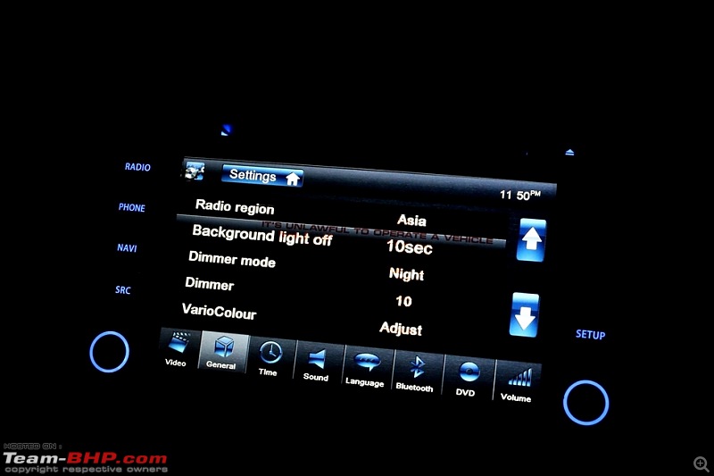

| Re: [To be merged with my ownership thread] Updates! Crossed 30 attachments on the previous post so here goes the Variocolor modes for the backlighting and the different options menu of the system: The 3-band equaliser (why not a 10-band one?) and the low-pass, medium-pass and high-pass filters menu: ![]() The balance and fader menu: ![]() The options under the General tab: ![]() Blue backlighting: ![]() Green backlighting (suited for Skoda cars): ![]() White backlighting: ![]() Orange backlighting: ![]() Sky-blue backlighting: ![]() Purple backlighting: ![]() The VarioColor scheme mode - choose the color with the RGB settings or just touch the color palette on the left to choose one: ![]() Bluetooth menu: ![]() DVD menu: ![]() Language menu: ![]() Sound menu: ![]() Time menu: ![]() Video menu: ![]() Volume menu: ![]() With a highline cluster, the information can also be displayed on the MFD. Here's a video of the 835 installed on a VW Transporter (their flagship van) that indicates this functionality: Things I liked: - The fit and finish of the unit lends it an OEM stock look. Blends well with the present setup. - Built-in CAN support for reverse assist - a huge boon for folks like me who park in tight spots (like this). - Built-in navigation and the bundled MapmyIndia map is very convenient for day-to-day usage. Extremely noob-friendly. - Day and night difference in the sound quality using stock speakers! I wonder about the improvements with a set of better speakers! - Built in BT and flawless integration with the smartphone including the contacts sync. Sensitivity of the integrated mic is very good. The bundled external mic is just icing on the cake! - Additional USB port behind the unit is a blessing especially when we want the front fascia of the HU to remain clean without anything jutting out. - Insurance for the system from New India Assurance for a period of 1 year (Link) Things I disliked: - The interface isn’t elegant and professionally designed compared to the stock systems offered by VW - RCD510, RNS510. It looks as if it was sketched by a 2nd grade kid! Don’t get me wrong! The UI is intuitive but the design lacks the finesse of a Blaupunkt system. - There is a noticeable lag in the UI of the system. Feels and operates like those entry level Android devices with some sluggishness. But this grows on us eventually so it is okay. - During music playback, the system does not shuffle songs from multiple folders - a feature the stock RCD320 had. To understand it better, suppose the USB drive/SD card has 10 folders containing different set of songs. If the system begins by playing a song from one of the folders, by pressing the shuffle button on the device twice, it shuffles the songs between the folders and not just the one folder. But my roomie tells me, even his iPod doesn’t have this feature! - The system takes a while during startup and displays a startup screen that lasts for a few seconds. It can get annoying at times! Well, that would be all guys. This has been a fantastic investment. I am yet to discover the potential of this HU. SQ-wise, this has been a worthy upgrade. As for maps and navigation, I guess I'd get to know more of it eventually. That would be all guys. Hopefully, these snaps may be of some help to someone who's planning to make a switch. If you have any queries do let me know! I'd be glad to help. Cheers! Last edited by Rehaan : 31st January 2014 at 14:18. Reason: As requested |
