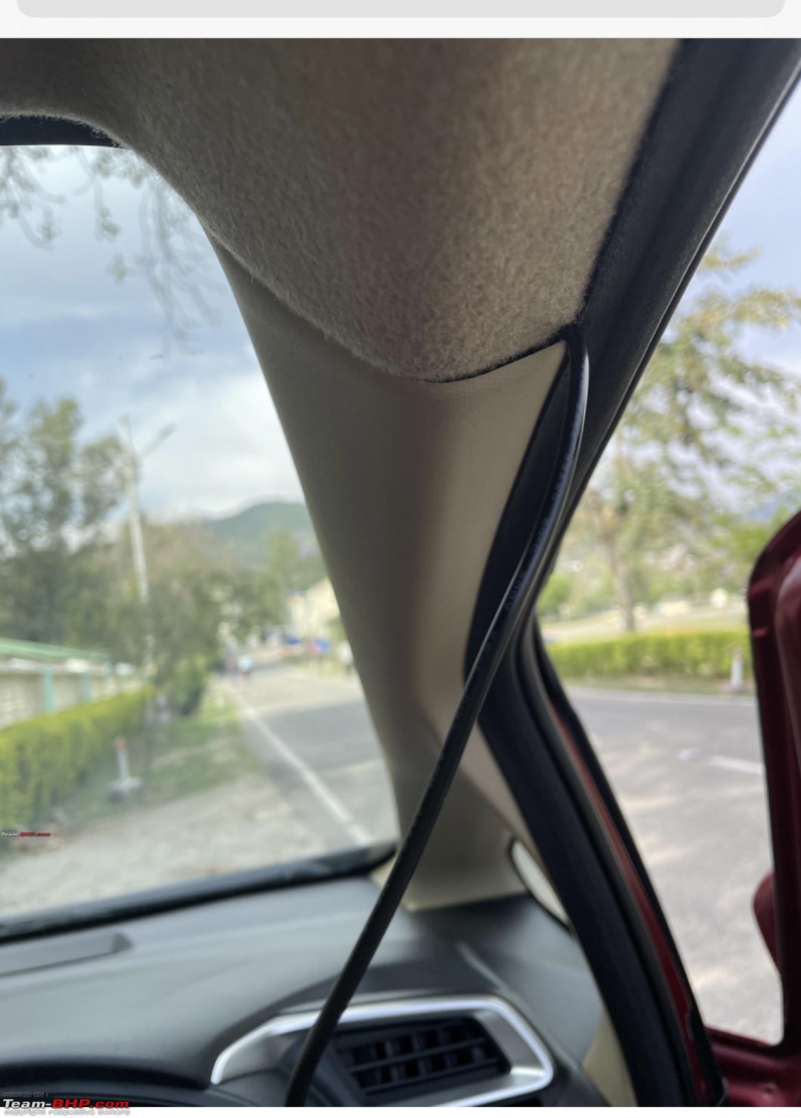

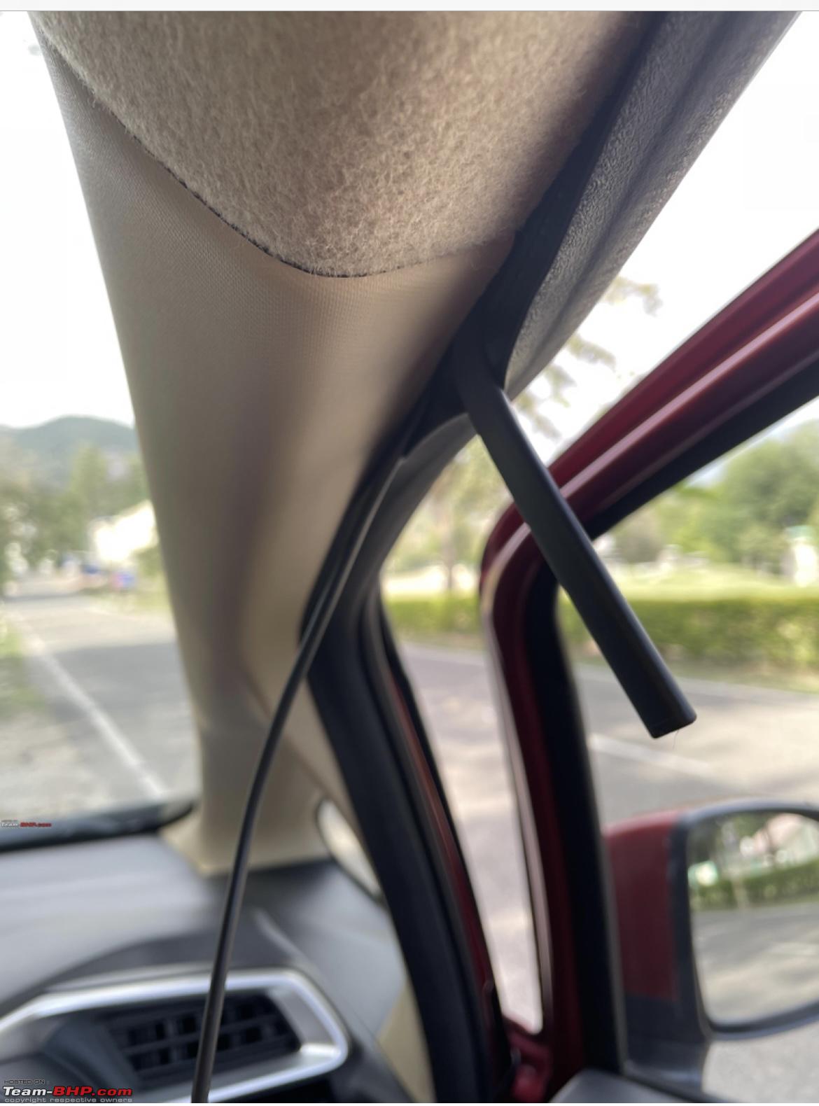

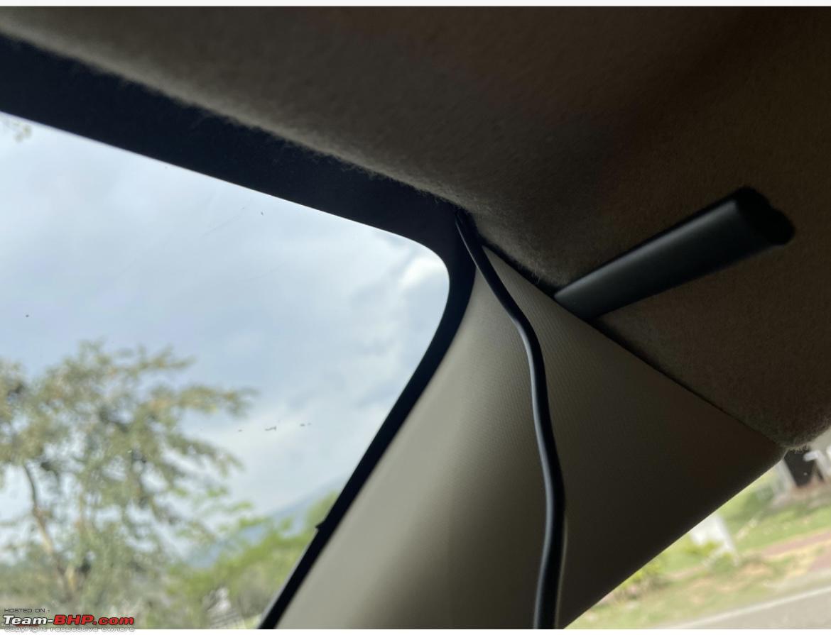

Hi @ACMerchant, can you please guide me on how the wiring is done from A-pillar bottom to under the dashboard? For trial, I did a dummy wiring through left (front facing) side of A-pillar, but then looks like I have to keep the wire exposed on the right side of the dashboard and then go to bottom by the side of the door. Is there any better way, without removing A-pillar? Picture attached showing my dummy wiring and exposed wire below A-pillar.The Dashcam / Car Video Recorder (DVR) Thread-dashcam_wiring_apiller_to_dashboard.jpeg

Hi @ACMerchant, can you please guide me on how the wiring is done from A-pillar bottom to under the dashboard? For trial, I did a dummy wiring through left (front facing) side of A-pillar, but then looks like I have to keep the wire exposed on the right side of the dashboard and then go to bottom by the side of the door. Is there any better way, without removing A-pillar? Picture attached showing my dummy wiring and exposed wire below A-pillar.Attachment 2471570
From the front dash cam use the tool to push in the wire till the A Pillar. Now slowly pull the rubber door lining downwards taking care not to pull the whole but a small section near the A pillar and then you need to pull out the white plastic of the A pillar an push in the wire. Snap the plastic back shut and then passing the wire again re fix the rubber door lining properly. Now you need to pull out the glove compartment and pass the wire behind it and then to the 12 volt outlet next to the mobile charger.
Cross over the A pillar at the top. It’s not possible to do it at the base. Check the pictures below

Hope this helps
