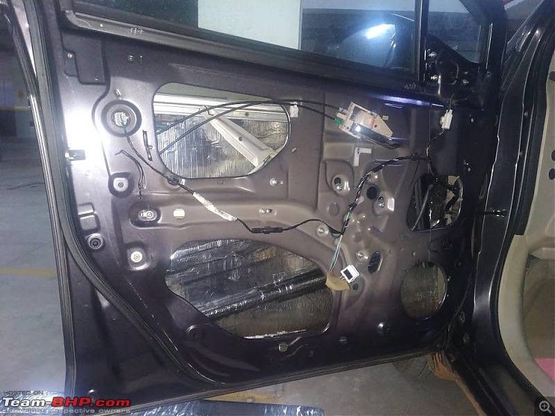

Hi everyone,
This is an interesting thread, and I have been following this for a while now. Now, I have always believed in damping the doors to improve overall NVH levels (not make it zero, which I think is practically impossible and not advisable too).
While getting my new vehicle, I got the floor PVC-carpeted and also went for some under body treatment for this purpose. The showroom guys have done a decent job here. I also got my stock HU replaced with a Sony XAV-3000 HU for Android Auto and possible future sound upgrades, and Polk components (DB+ 6502) for the front doors. The NVH and audio output at the time of delivery was decent. However, I was looking to damp the doors further as I could not play any music at higher volumes. Not that I wanted to make others listen to my choice of music, but the setup was somehow not falling in place. Then, I decided to get it done through professionals only, as I am not a DIY person myself. Finally, zeroed in on Satya from EVO-BLR. He seems to know a thing or two about decent audio upgrades, as some of our fellow BLR Bhpians would know. Anyway, we decided to upgrade the rear speakers too. On opening the door pads, we observed a shoddy installation work by the showroom guys. the MDF speaker mount was all over the place on the front door. Anyhow, we got better mounts in place, and Blaupunkt Damp 2.0 sheets were used for the damping work ( a total of 8 sheets were used). These guys pasted one layer inside the outer door metal and another layer just before the plastic door mount, on the metal surface where the manufacturer puts a transparent sheet. This took about two hours to complete.
I must say, the audio quality has improved drastically after the damping. The lows are brighter, and the tweeters are also tuned better (the showroom folks had messed up the crossover setting and boosted tweeter gains). I can also play music at moderately high volumes without any distortion. I don't listen to very loud music, so I have not checked for higher volumes. However, they seem to be good too, as demonstrated by Satya.
I hope this damping remains effective. I plan to get an amp only in future, and no subs. My wife and kid don't like the thump, and they are always in the car with me. Have to wait and watch how this setup holds with an amp. I suppose it should be alright without the sub.
Incidentally, the damping has also reduced ambient noise to a great extent. Road noise is muffled but still there (No major changes here as the floor was already PVC-carpeted before), but I don't mind that. Its a feedback of sorts, and should be there, I feel. Otherwise, ambient noise is well-controlled now. This is important in Bangalore!
I have not tested it on highways and at high speeds, so will not be able to comment on these aspects.
I was quoted about 9K for the damping, but we negotiated to a mutually agreeable price for the same.
However, I forgot to damp the boot door
I have attached a few shots of the installation. The inner installation in not clear from the pictures. However, I have seen it in person, and the guy did a good job.
