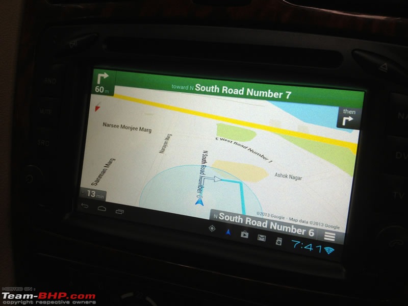

Just to update you guys: I finally ordered one unit off AliExpress. Along with the extras, shipping and duty, I ended up paying close to Rs. 45-50,000. I lost track of the cost and just gave up counting.
A quick round up...
Pros:
  • Perfect OEM look. You'll have to see it to believe how good the fit and finish is.
  • Steering mounted controls work just fine.
  • Runs Android 4.0.3, is rooted (so you can install scripts that run at start, etc.). Play Store and most apps work fine. Google Maps, TuneIn Radio, etc. Only 4GB built in, but that's sufficient for most apps.
  • WiFi works, so I turn on my phone's portable hotspot and the HU is online.
  • It has an AUX in for audio as well as rear-cam video.
Cons
  • Sound quality isn't up to expectations, but it's not unbearably bad.
  • The touch screen is resistive, so you'll need to use your fingernails or a stylus to use it and it's not convenient to type at all. No multi-touch either. This can be quite frustrating.
  • The color balance of the screen is off and it's not good for watching video, but the rest of the apps and UI works okay.
  • Takes a while to boot into Android, so if you shut off your car, you'll lose whatever is going on when you start the car back up again.
  • No USB OTG apparently, so Android can't access a connected USB drive or the memory card. You're stuck with the built-in 4GB local storage. But WiFi works, so you can play music off another device with the appropriate software.
  • Took me a while to get voice support added to Android, but it doesn't work because the mic doesn't seem to be connected internally.
  • The non-Android USB playback mode is primitive. It gives a full list of files with DOS 8.3 filenames, no tags, no folders, nothing. It's unusable.
  • The internal clock resets and starts at 5:30am (IST, so 00:00 GMT) everytime you turn this thing on. Workaround: use Smart Time Sync and set time via GPS or NTP over WiFi.
Anyway, after getting it fitted, I felt like it was the closest I was ever going to get to a near-factory OEM AND functional experience. Pics below.
Thanks, all!
