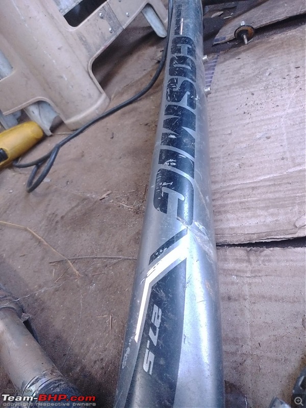

Well, weather in Manali has been in a warming trend the past 2-3 weeks, hardly need a sweater now and that means it's time to get going with cycles again. Village kids have pulled out all their rusty ones (look to have been stored under snow piles) for me to get started with, but am eager to start something of my own as well.
I've got three MTB frames I'd picked up late last year which have been sitting in the storeroom under my landlord's house, waiting for some kind of buildups: A very old alloy Firefox, the spindly steel Hero Ranger, and this Cosmic Crux 27.5".
I got the latter from a cycle shop down-valley for a few grand in complete form - probably too much considering the condition, but 1) the alloy frame itself was of handsome profiles and felt pleasingly light; 2) 26" MTB's are apparently getting to the point of near-obsolescence, and most of my (rental) fleet along with that... So wanted to start adding more contemporary sizes.
I've got Raleigh/FF 29er's which do ride ok, but honestly feel the additional (unsprung) weight of the larger wheels negatively on broken roads. Probably would need considerably higher-end stuff - lighter wheels and better-damped, more rigid forks (than SR XCT) to really appreciate the supposed benefits of the 29's. So as some out there suggest, the 27.5 might be the best compromise. Being a modest 17" frame, it'll be too small for me personally, but that's alright. Should turn out light and strong enough without having to spend too much.
Anyway.
Paint scheme was based on a rather nice smokey, kind of gleaming metallic grey, but it was scraped up enough to make me doubt a good cleaning/touching would suffice...
...So today stripped the paint with a chemical remover (I seem to be partial to polished aluminum frames, this will be my fourth), and was pleased to find the bare frame weighing in at under 2kg's, even with the BB / steering races still in there. Must be about 1.5 net then, which generally puts it on par weight-wise with an aluminum Trek or whatever else. Also has, quite surprisingly, the clip-type holders for hydraulic brake lines... something that back when this was made would have been fairly unusual. So I'm guessing a decent China/Taiwan-sourced frame laden with heavy, cheap desi components to keep costs down?
Whatever, it had www.brandnmc printed on the frame, which currently takes me to a seemingly not very lively site called "Nandi Marketing" which at present offers a couple of rather nondescript low-end cycles of the "Level" brand.
I had an aluminum handlebar and seat post on hand already, the OE rims seem acceptable. Typical freewheel type setup should work well enough, especially if I can source a 32 or 34T-first eight-gear one, which pre-Covid was supposed to be available even from my local desi source (he has 13-28T 8g even now). Tyres are quality take-offs with a little life left in them. I'll try to get hydraulic brakes on this one, too.
Forks are always the sore point when it comes to budget MTB builds, 'cause cheap as everything else may be, it's basically impossible to find budget ones (meaning anything that doesn't cost twice what a budget cycle is worth) that perform well and don't themselves weigh more than the rest of the frame (as the horrid, undamped, unadjustable original seen on the ground there definitely does). I have a spanking-new Rs1500 set, also heavy but at least tighter, that'll have to do for now. Parts supply still hasn't picked up very well and am hoping that once we get into the season I'll be able to find some better-quality salvaged items. Rigid just isn't going to work up here for most people on about half the available roads, where dodging nasty potholes is far too distracting to be enjoyable, IMO. Personally I want to be able to keep my line and just ride through them.
On that note, the 27.5 SR XCM hydraulic fork I picked up from someone I met at Manali's downhill event last year would've been perfect for this build, had it not been even more needed for my ACT108Max... which is now riding much more happily "over the river and through the woods" than ever before. In retrospect, getting repeatedly airborne with the original front suspension was pretty foolhardy
Anyway, put my best mechanical junk-bin calipers on there - Hayes MX-5's - and between those and the SRAM rear derailleur and clickers and jugaad 2x8 setup, it really is a pleasant ride. Anticipating some real fun on it this year.
A good winter's rest for my knee(s) seems to be what was most needed, thank God. Haven't been on as long of rides as I was doing last year pre-injury, but so far in moderate pushing a few times a week am feeling no pain, so am looking forward to more riding again - most of which will probably be on the (ancient) Decathlon Riverside, since indeed the 700C's do roll better than anything else I've got. Really wish I had some flatter roads to go longer on, though. We've only got two basic roads running either up or down valley here, most of the link roads / side valleys are more interesting but steeper, too. Working on getting whatever personal cycles I ride geared as low as possible in order to reduce the strain (better late than never).
More to come.
-Eric
