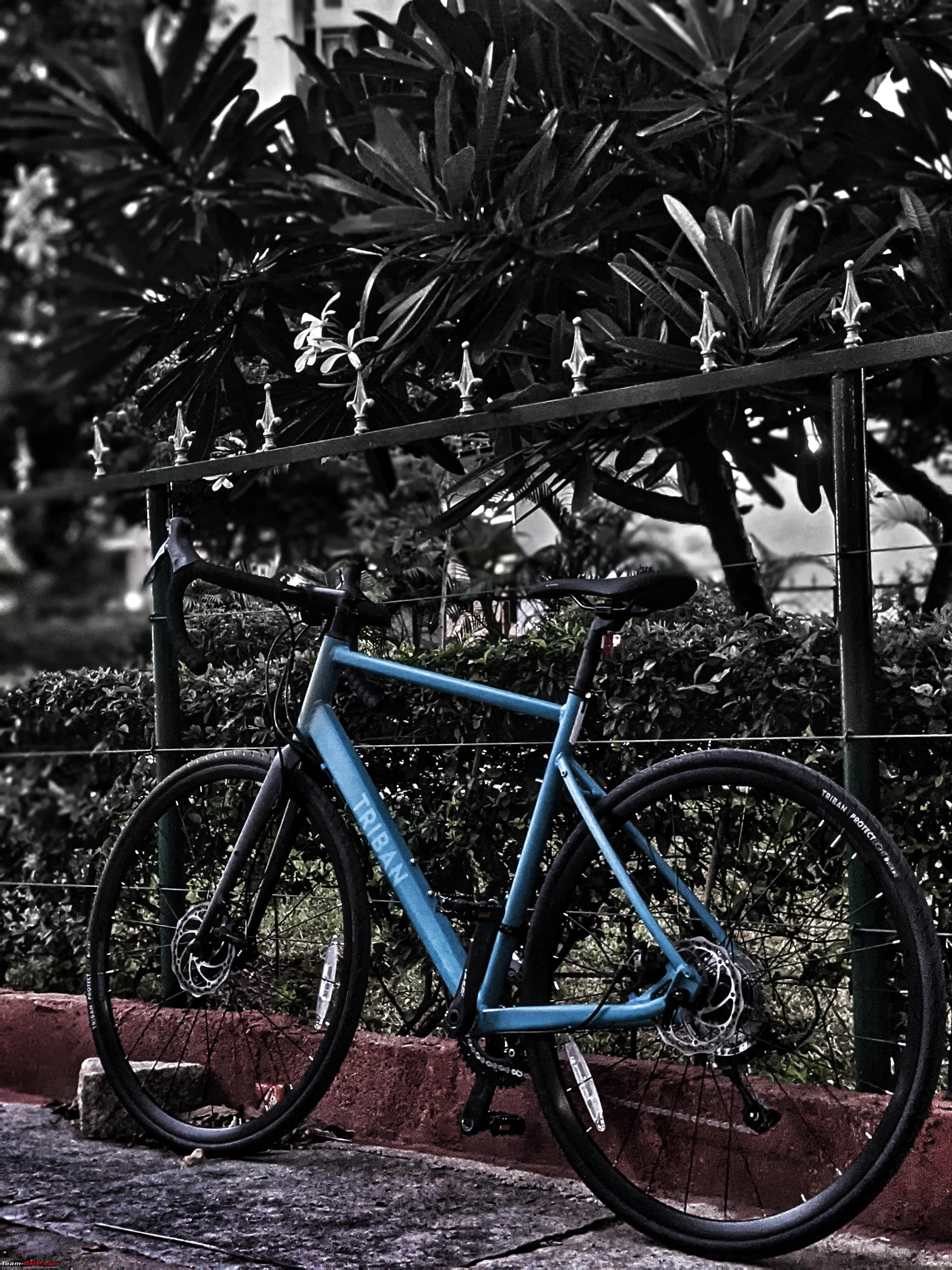

Just fooling around with the new toy lol

Who setup the bike? Why are the hoods pointing to the sky? Last I remember you were looking for a hybrid. How come you ended up buying a roadie?

Looks like I got caught. I was just fooling around with the bike fit for myself to make it a little comfy. I bought the roadie, but I plan to max the tyres up for comfort when I get access to them.
Should I go back to leveling the handle bars? I found the seat also a bit too rear ward. Will probably want to move that forward so I get closer to the bars a bit.

My suggestion is find out who’s a great guy at doing bike fits in Bangalore and do a proper fitting session with a fitter. Setting up the bike with the right fit is quite important while riding a road bike.
25c tyres should be a good option. Please do consider those.

No need to panic but at a L the frame is a size too large for you.
As a comparison, I am 180 cm and I need a M in this Triban frame.

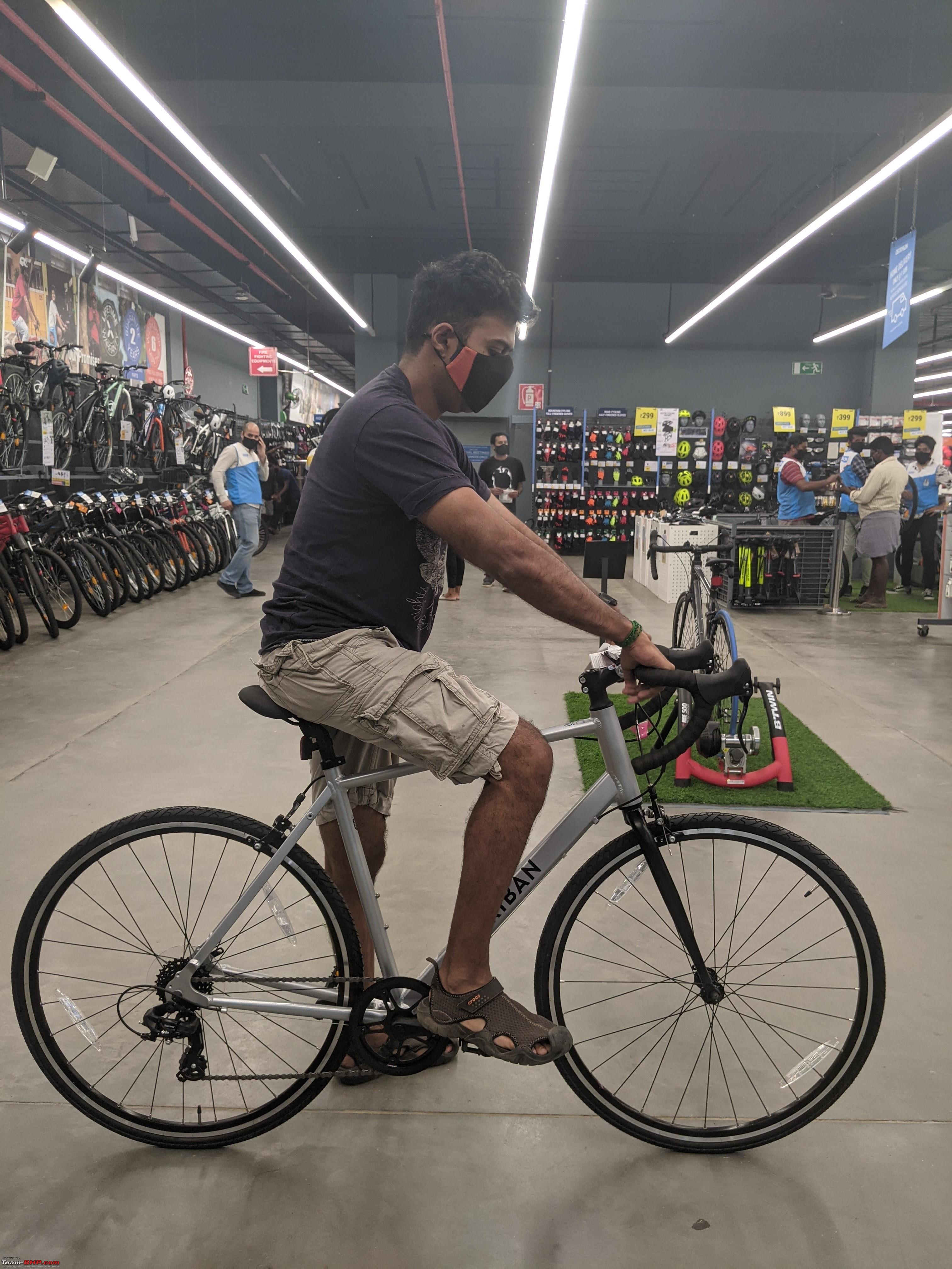

I tried the medium at the store and it felt way too small for me. It was the rc120 medium that i tried. It felt physically cramped.

Check the French sizing chart I added above.
You're definitely not an L.
And you don't hold the handle like you are while trying to figure out fit.
That position is the most upright and one only employed when very tired, or climbing.
It's also a good 5-7 cm short of the hoods which is the usual default position.
The drops will be even further away.
Cheers, Doc

I will put the bar back to stock position and relook at the the bike fit again. Just watched a bunch of videos on this. Hmm, i will look into the stem/seat etc as well. I liked the room on the large, just didn't feel cramped up. Does inseam also make a difference in these things along with arm length?

If the RC 120 is for sale (looks like a demo piece), exchange your bike for it. Will save you months of hardship and a lot of expense in different stems, before you come to the conclusion I am telling you now.
