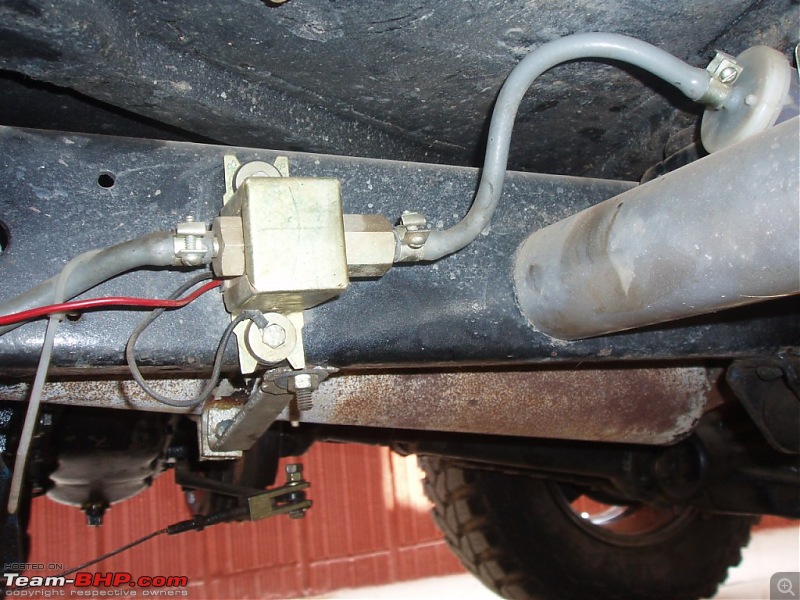

Originally Posted by Jaggu View Post
Right now my idea is to put her under the body, close to fuel tank with a filter before. This will go direct to mechanical pump. Powering up will be by a separate switch to control the usage only when required
Hi Jaggu,
Here are the pictures which is basically what you intend to do. Filter -> Electronic Fuel Pump -> Manual Fuel Pump -> Carb in series.

Originally Posted by gbanavar View Post
Hi Jaggu,
Thanks i was thinking ill mount it on the body instead of the chassis. Otherwise precisely the set up i have in mind Anyways good that you posted the pictures, now i can show this and explain better to my mech.
