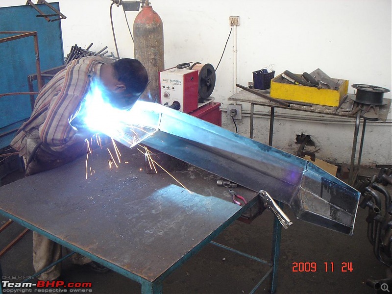

As a part of the add-on process planned earlier, the jeep is going to get a customized front bumper, exclusively designed and fabricated by Mandeep. The aim was to come up with something simple but subtle that stands out from the conventional looks, not too heavy yet super-robust in terms of strength. Its made out of 'white metal' with MIG & TIG welding all the way at appropriate places.
Here are a set of pictures of the buil-up process of the bumper. More pictures will follow soon.

1 question
what kind of welder was used, tig or mig ? (& amperage)

Harjeev,its a 4mm thick steel with mig welding from inside and outside.It wont get damaged,its not like those 1 guage or 14 gauge bumpers.
Originally Posted by jeepster View Post
in harjeevs words
1 question
We have miller for tig,and sunrise for mig,as far as the amperage goes,i need to check with my foreman.

I personally like tig as it has less spatter and does not heat the metal much,you can make fine welds and tacs with it.Though mig is easier to do as the spool feeds the wire through the torch.The price range varies on the series of machine you buy.You can go online and call for price.Esab is also a good company and has offices everwhere.
