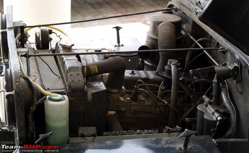

Under the hood.

Wow! Your Jeep is so clean under the hood....can hardly see any rust. I guess living in the coastal area takes it toll on my Jeep.
Yeah, and there is no oil leak too!
