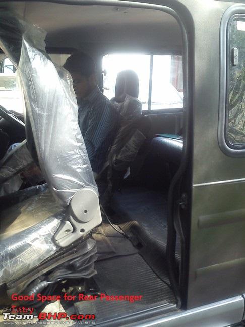

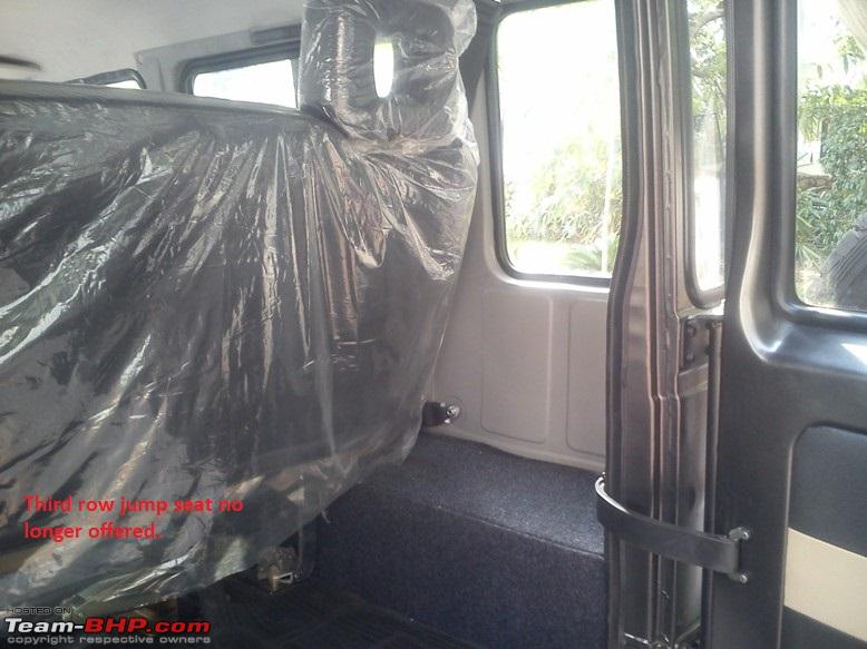

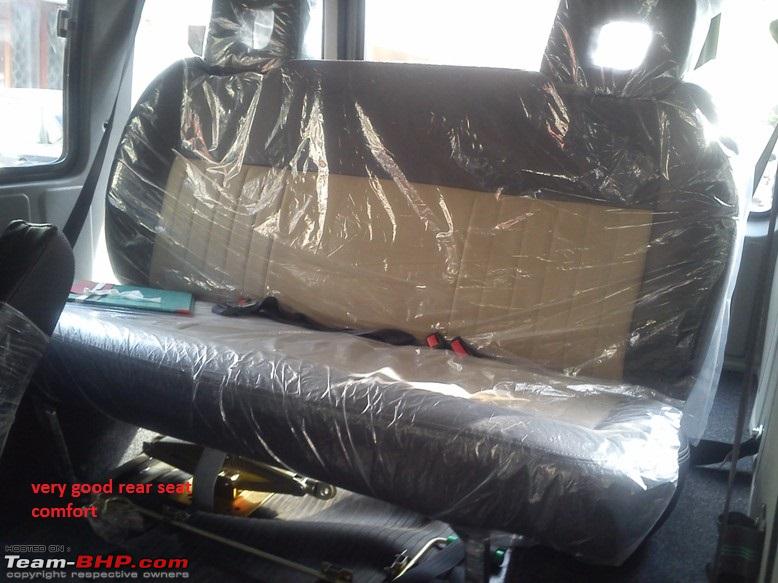

Interiors/Comfort/Ergonomics:
This vehicle is one of the most comfortable Indian off-roaders that I have sat it. For comfort it blows the pants off the Scorpio 4x4 and also Thar. Seats are well bolstered. There are arm rests on the front seats, but driver side arm rests cannot be used unless you convert the transmission to an automatic as there is no way to change the gears with the driver armrest down. Ingress to rear seat is fairly spacious since the front passenger seat can be flipped forward. The rear bench is also quite spacious with enough legroom, but since it is placed high on the rear wheel arch, tall passengers should watch their head. However, the roof has moulded roof lining so even if you bump you heard, you may still be able to go to work the next day. The third row jump seats were not there. The salesman said that it is no longer offered so not sure what the story is. Overall the interiors are extremely crude, but I have no complaints about that since you don't expect a range rover when you buy a Gurkha. So it was something that I am willing to live with. The dash looks like it was hacked up by a local tinker.
