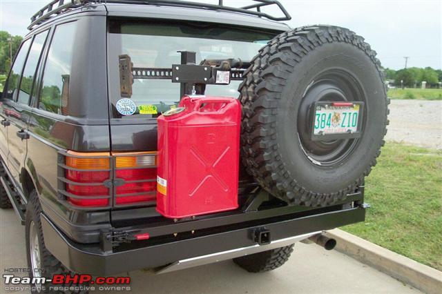

Guys, I came across this setup someone on another forum did on their GV.
I need to carry two 20L jerry cans for an upcoming trip. Is it safe to carry these cans inside the vehicle, given that they are well secured, seated properly and sealed?
The reason I ask is because unless safety is a major issue, I would rather have the cans inside the vehicle as it requires relatively easier modification, and is less prone to theft.
- Petrol fumes are a hazard to your health, and can be explosive.
- Sloshing the fuel around builds pressure.
- Closed environment like a car cabin can increase temperature when you park the car under sun for a while.
The condition of your cans are a major deciding factor. Older the can, more the chances of the fumes leaking. I am assuming you would be opting for plastic cans to avoid static electric discharges while placing it/removing metal cans from between the seats/carpet.
Thinking a little out of the box, if you can design some contraption, a pipe to guide the fumes out through a small gap in the window, you should be good.
On second thoughts, I am not very sure if a moving car causes enough air pressure drop to suck the fumes out.
I'll only fill these cans to up to, say, 16-17L.
I recently bought (plastic) ProQuip 20L cans. Never used them before but the seals appear to be of solid quality, so I'm hoping there will be no leakage/fumes.
Good point. Will have to keep this in mind. During driving the windows will most probably be rolled down partially at least.
Of course, an alternative is to buy a roof rack and install the cans there. Seems like an overkill right now since we don't have enough luggage to justify getting a roof rack given that there is a lot of space after tumble-folding the rear seats.
If I don't go for the in-cabin storage, I was thinking of putting the spare tyre inside the cabin (and tie it down, of course), and getting a small mount fabricated which can hold the cans and mount it where the spare tyre was on the tailgate.
Tanmay K is offline

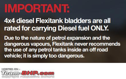

@Tanmay K
While searching for solutions to your fuel carrying problem, I stumbled up on this product. It is called FlexiTank, but for diesel only.
And also this note in their brochure.
Product info link.
Spinnerr is offline   (1) Thanks
Yikes. I will move the spare tyre inside and get a mount made to put the cans outside. Don't want to add the weight of the spare + 30 kg of petrol on the tailgate.
Thanks!
