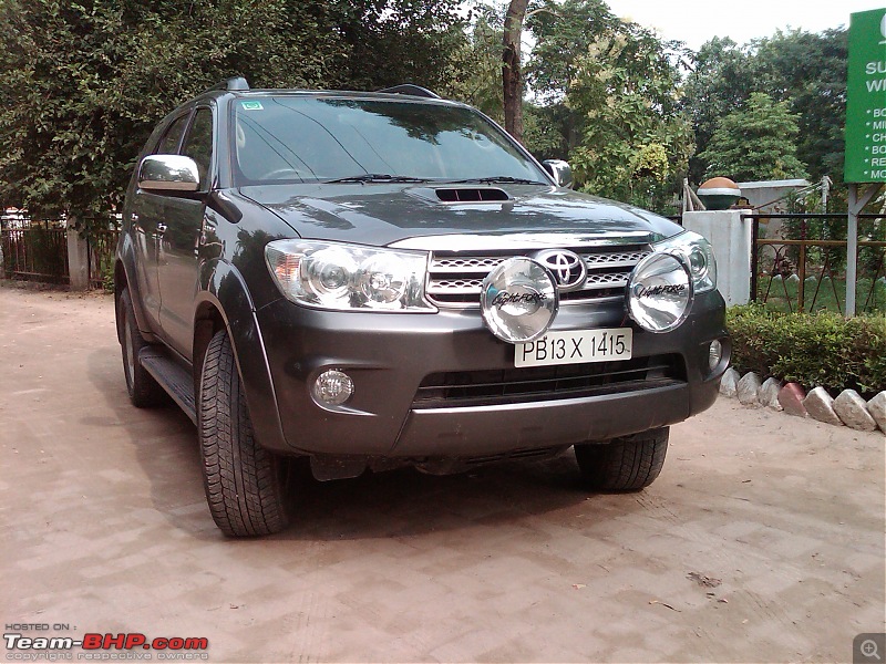

the lights have been installed by using a metal pipe mount and using the no.
plate holes to fix it.

Hi Sammy.
Please coudl you tell where did you get your light force lights installed. I have a pair of 240 bliz that I am looking to install on my scorpio and am not very keen on getting a crash gaurd installed.
Also any issues on the way its been installed on your fortuner?
Many Thanks

hi prakashutosh,
since the bumper design of the fortuner and the Scorpio is not similar so I think the lights would be difficult to mount in a similar fashion.I would suggest u install the front guard of the Scorpio Getaway minus the round pipe on the top.It serves the purpose very well and looks nice too.BTW it is a very strong mount for any kind of lights,this i am telling you from personal experience as had previously installed HELLA rallye 4000 HID lamps on my (now sold) Scorpio.Mind you the hella lights weigh a ton.
Hi Sammyaulakh, can you post more pictures of the mounting brackets for those Lightforce aux.lights on your Fortuner? I've just bought a pair of Hella 4000 (Metal ones) for my Innova, but am yet to find a good installer. I do not want to drill holes in the Bumpers, and the lights should not vibrate. The Unibar brackets would be good, but I think they would vibrate once the Hella 4000's are fitted.
