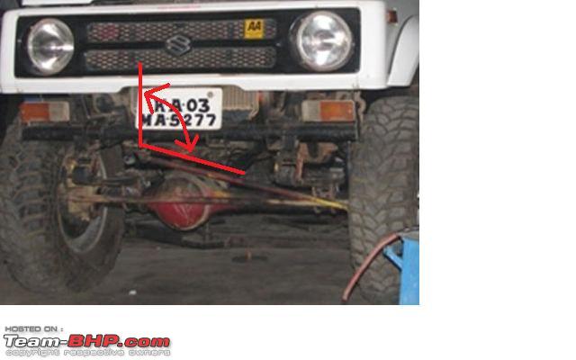

... shouldn't the angle needs to be reduced? or else a small bump can steer the wheel either way on high speeds.
Originally Posted by star_aqua View Post
..... I think the ball joint between the pitman arm and the steering drag link should be as nearer to the perch on the axle housing. ....
Originally Posted by Alfa_Kilo View Post
Make sure both the ends of the drag link are in the same horizontal plane ............. by either lowering the pitman arm or raising the knuckles....
Guys, I WILL BE getting a Hi-Steer setup done soon by raising drag link & tie rod over the springs suing custom fabricated arms.
BUT still want to discuss how come that the AXE has this steering angle?
See pictures below. The angle between the drag link & tie rod looks similar to what I have right now in the Gypsy. What does AXE have here?
Khan sir, one major difference i could see here is the track width. with the wide track the steering drag/correction will be less during articulation.
my only concern is what would be the magnitude of the drag when you run the left front wheel on a pothole at a high speed. But i feel the existing setup does not cause any problems off the road since the speed at which you cruise will be very less and there is allways more time left for you to do the correction.
