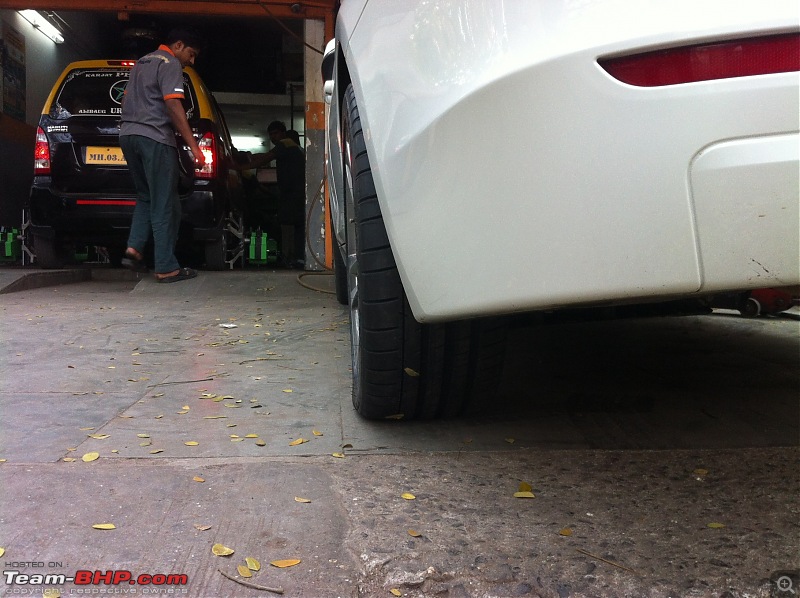

Gone Staggered;
Front : 225, Rear 245

Rear 3/4 stance;
My BMW, upgraded to Michelin Pilot Super Sports! Imported from TireRack.com, USA-9.jpg
Side stance remains almost unchanged
