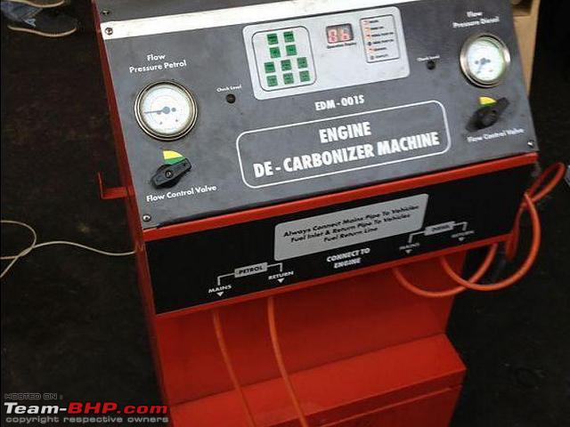

So, what is decarbonising?
In simple terms, decarbonising an engine involves removal of carbon deposits from the engine, using either mechanical (physical) or chemical methods.
The procedure of mechanically cleaning out carbon deposits entails removal of the cylinder head and then, physically scraping off carbon deposits from the top of the pistons, the combustion chamber and other components (e.g. valves). Two-stroke engines of yore needed frequent decarbonising as the lubricating oil (2-T oil, in common parlance) burnt in the combustion chamber, leaving behind carbon residue.
Opening up the cylinder head of a two-stroke engine is a relatively simple procedure. This isn't the case however, with modern 4-stroke engines and their overhead camshaft(s), injectors, multiple sensors and electronics. There is a lot that can go wrong in the hands of an incompetent mechanic. Therefore, the perceived need for chemical decarbonisation.
Adding certain chemicals like alcohols and terpenes into the conventional fuel supply (petrol / diesel) appears to dissolve and remove at least a part of the carbon deposit formed in various parts of the engine, such as fuel injection systems, piston crowns & rings, combustion chambers, valves, exhaust manifolds, EGR valves, cat-cons and mufflers. The carbon is then ejected out through the exhaust. Various companies make proprietary decarbonising agents, the contents of which are usually trade secrets. A machine, such as the one pictured above, is deployed to meter the decarbonising agent along with fuel into a running engine, where it's supposed to perform its magic.

Why Decarbonise?
Most explanations about the necessity of decarbonising any engine unsurprisingly come from manufacturers of the chemical decarbonising machines! The benefits are said to be as follows:
  • "Spring cleaning" of the engine from the inside, without opening it.
  • Decarbonises the entire fuel system, including the O2 sensor and catalytic converter (sic).
  • Restores / improves fuel efficiency.
  • Maximizes vehicle performance.
  • Reduces harmful emissions.
  • Reduces engine noise & vibration.
  • Repairs driveability problems - Eliminate engine hesitation, hard starts & rough idling.
