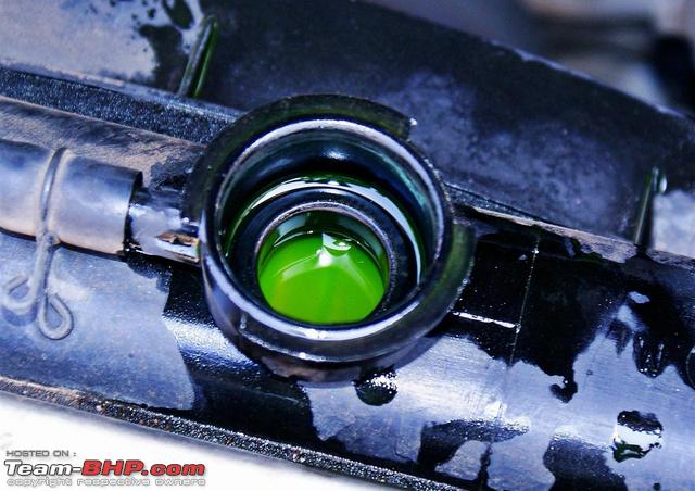

First things first:
The first thing you should do is switch the air-conditioner off, keep the revvs to a minimum and find a safe parking spot. Once you come to a halt, switch the engine off immediately, but position the key in “ignition on” mode. This will allow the fans to keep running. Contemporary cars have electric cooling fans that operate even when the engine is switched off. Pay attention to whether the fan kicks in or not (you will hear it) as this information will help us later.
Ensure nothing is blocking the front of the radiator (e.g. plastic bag or newspaper). Also open up the bonnet. Keeping the bonnet open will allow heat to escape quickly. However, if you see steam coming out from the bonnet area, don't go near it. Wait for the heat to subside or call for professional assistance.
There is no airflow aiding the cooling system at 0 kph and the components have to work harder to keep things cool when the car is standing still. The steps above help to minimise damage.
If the Radiator is Empty:
• Look at the coolant overflow tank (usually a small plastic tank connected to the radiator). If fluid level is below the minimum mark, there is a good chance that your radiator is running low too. While you can top up this overflow tank when the engine is hot, in some cars (mostly European models), the tank is pressurised. If there is a warning around the lid, or the lid needs to be screwed off (not flipped open), you can be sure that it's pressurised. Don't open it in that case; wait for the engine to cool off.
• We need to ensure that the radiator is topped up with coolant and water. Remember, you should NOT open the radiator cap when the engine is hot. It's literally a pressure cooker in there and you could end up severely burnt. Therefore, wait around for a minimum of 45 minutes. Go get yourself a snack or try to find a mechanic close by. When the engine has cooled down, slowly open the radiator cap with a thick napkin or cloth placed over it. It might release pressure and steam as you unscrew the cap, so do this very slowly.
• If the radiator is dry, you need to fill it up with coolant & water. If you cannot source coolant, use only water as a temporary fix. Be sure to start the engine before you start filling the radiator. This is necessary, else you'll end up with a cracked engine block. Keep the engine running and slowly top the radiator up with coolant and / or water.

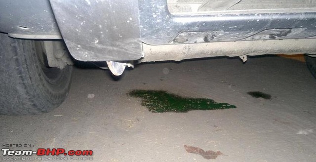

Radiator Leaking?
Radiators of modern cars usually last the lifetime of the vehicle. However, rust or damage can result in leakage. These leaks are usually accompanied by steam from the bonnet area (but not always):
• Adding a spoon of haldi (turmeric powder) when filling up water can help to plug minor radiator leaks. Be advised that this is only a stopgap measure to get you to a service station. At the first opportunity, you must flush the entire radiator and get the haldi out.
• If the radiator's leaking spot is visible, apply m-seal to that area once the engine & radiator have cooled down. It should hold until you reach a garage. M-seal is easily available in smaller towns too.
• If one of the hose pipes has a minor leak, you can try wrapping electrical tape generously around the damaged area. If the leak is at the edge of the pipe, see if you can cut the damaged area off and still have enough length to refit the pipe.
