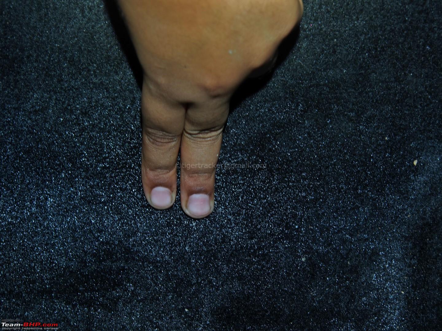

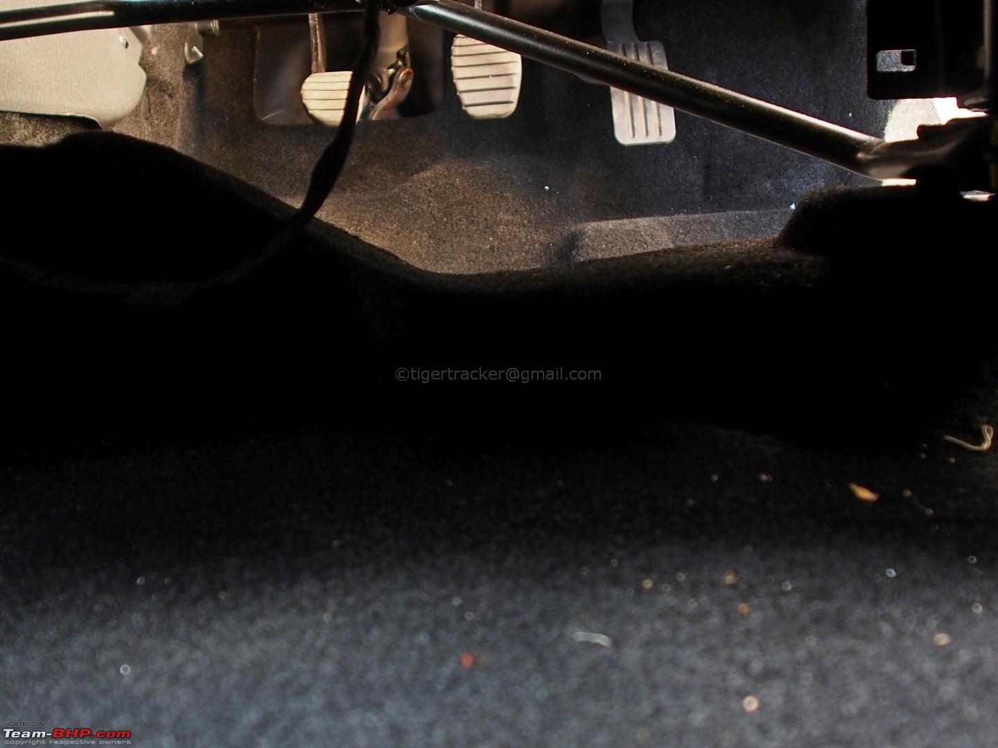

I am starting this thread because I see more and more Duster owners facing the unusual problem of water seepage inside the passenger compartment. There are a few posts on this issue but they are lost in the ‘traffic’! I thought it is a significantly serious issue that warrants its own thread.
I took delivery of my Duster (85Ps RxL-O) on the 1st November 2012 from the TVS Kochi. It was a rainy day and my car was already in the showroom. I went around the car inspecting for any dents or scratches and found none but I found that the accessories I had asked for were not fitted or provided despite have informed the service/PDI section a full week before. I got into the car and did not find anything amiss except that the paper ‘mat’ they usually put on the floor had a damp corner. I didn’t think much of it and assumed that it would have been some water creeping in while washing before delivery.
It was just after Cyclone Nilam had hit the east coast of India and we were feeling its effect on the west coast. I, therefore, couldn’t leave the doors open to dry out the wet mats for a couple of days. Meanwhile, I went to the upholsterer and got my seats covered and firmed up because I have a bad back. I also got a waterproof rubber matting laid over the, now dry, floor carpets. After that the car has done two trips over 300 kms and a few smaller local trips one of which was to Malampuzha Dam. After that trip I had washed the car personally but since I only shook out the plastic mats I did not notice anything unusual. A week after that trip my driver noticed that the edges of the carpets around the rubber mat was wet. It was then I realized that I had a problem and posted it in Team BHP.
It seemed that others too had similar problems attributed to three problems (recorded in earlier posts under owner reviews) A/C condensation leak, ‘scuttle panel’ drain block or door beading leak.
To most of us the honeymoon with a new car lasts a few months. Mine was over last week, a little under a month after taking delivery. I had been to Trivandrum the previous weekend and the car was lying locked in my porch for 72 hours. I came back late evening on 25th November and opened the door to have a stench wash over me. It was a miracle I did not puke but I opened the doors, switched on the A/C, sprayed a car perfume inside and waited for 10 minutes. The car was drivable. Next morning, when I opened the door the smell was still there. Now, I dread opening the door in the morning. Over the last two days (Sunday & Monday) I dried out the car completely again, then washed it today. I have water inside on all four sides and the carpet is soaking. See the pictures and video.
I’m taking it to the Renault service center in Coimbatore tomorrow. Hopefully I’ll have solution to the problem. I’m making this post so that other Duster owners with similar problems can pool their experiences and help other. I have seen one post by Driven Tweel with a similar problem but not seen any follow up post about whether the problem was solved.

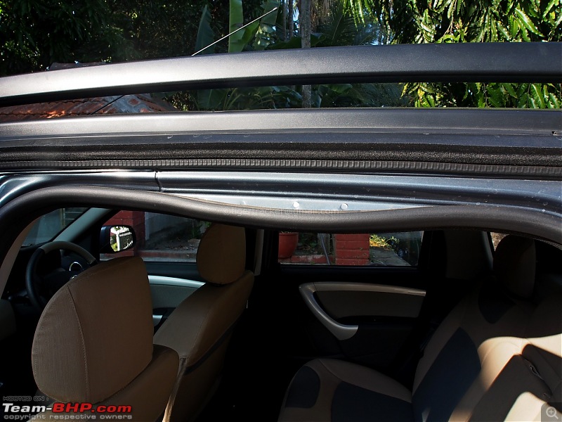

My take is that is has to be the ridiculous single, door beading. The A/C Condensation drip or a scuttle panel leak cannot flow over to the rear because there is a small hump under the front seat.
Any idea fellow Team-BHPians? I’m really frustrated.
The video link follows this line
Caption for photos:
1 - Water in the rear passenger area
2 - Mist of water under the transparent plastic mat
3 - )'Press test 1'
4 - 'Press test 2' showing wet finger!
5 & 6 - The hump under the front seat

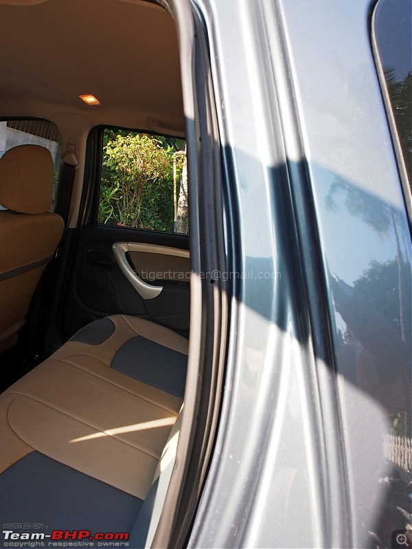

These pic are after yesterday's wash. There is a loose beading on the left rear door (1st & 4th pics). Tried pushing the beading into place but it pops out again (2nd & 3rd pics) but that does not explain how water got in on the right side also.

From your pics, it does not look like loose beading is the culprit. If it was, you should have seen some water on the door panel, inner part of windows or probably even the seat edges.
Auto grade two-sided tape might help keep the beading in place (just a wild guess, not an informed suggestion; do not know if it has any drawbacks!)

1. If the a/c water outlet is loose or not plugged in properly to drain out.
2. Below the wipers/windshield there are perforations for water from windshield to collect and drain. From here if there is leakage then water would enter the cabin. You need to check under dashboard and well as from the bonnet.
3. Check the Drain plug of the car below the carpet, it allows for water draining as well as water entering when driving through deep waters.
MKP
