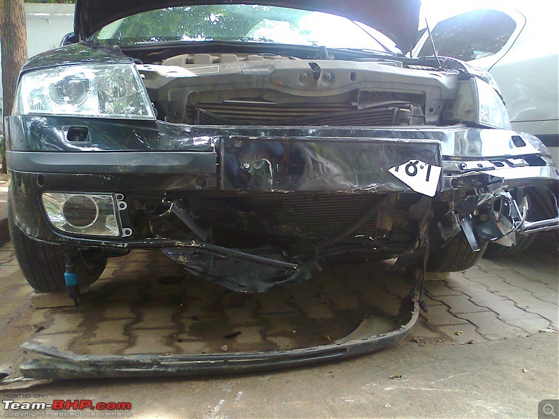

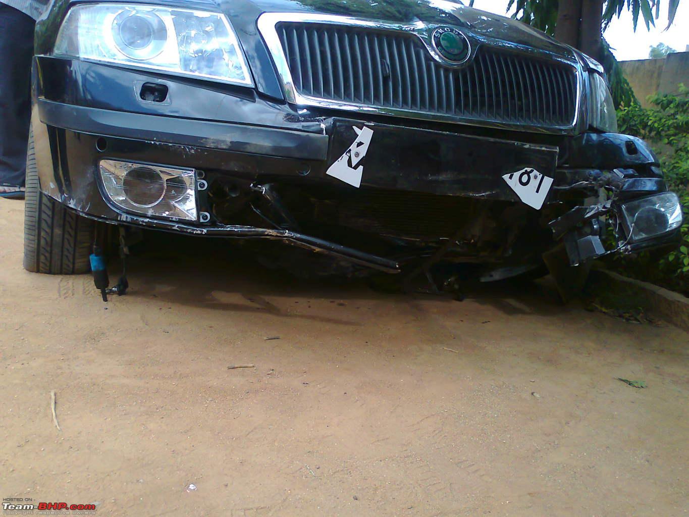

My Skoda Laura would have completed 4 years on 26-June-2011 and I was planning to write an ownership reivew, but unfortunately it met with a major accident and is currently camping at A.S.S.
Photos take at the workshop: (Dropped it yesterday, so it will take a couple of days to complete estimation and it's fate)
The vehicle at the police station (I was not there at the site of the accident and the vehicle was already at police station by the time I reached)

My parents were traveling towards Hyd from Bangalore (NH-07) and around 5KM after chikballapur town there was an auto in the left lane that took a sudden righ turn (i guess he saw a gap in the median and wanted to take U-turn and didn't bother to see what's in the right lane). Our driver swerved right and hit the median - and my guess is he hit the median at full speed either without braking or insufficient braking.
The concrete median chopped off everything that is below the fog-lamp level and the median barrier has smashed into the front-left fender. Green coolant was all over the bottom broken plastics and few 'guts/wires' where dangling from the bottom (pics don't show). The "turing" auto hit the left rear passenger door.
Front two airbags deployed and all the three (mom, dad, driver) seat-belt pretensioners were also activated. All were wearing seat-belts so they were all safe (my parents were later recounting the story and told me that they thought "this was it!"). Auto driver fell from the auto and he sustained injuries (hospitalized) - we were later told he was alright but under treatment.
The scene after the accident was tense what with all the people gathering on the highway and the beginning of a mob-action. Luckily some of the locals supported us saying we saved that moron's life by damaging our car. When my parents called me I told all of them to go to the police station (chikballapur) asap and forget the car. When the driver told me the airbags deployed, I pretty much lost hope on the car and I was hoping that the auto driver is out of danger (for conscience sake and to skip future complications)
This happened on a saturday, so we could finish the FIR formalities on Saturday itself. We needed to complete RTO+Police paperwork to get the car to the workshop which we could do only on Monday. Apparently the auto does not have proper documents and the driver does not have a DL, so no one came to the police station to lodge a complaint, etc. during the last four days.
I will receive the detailed evaluation from A.S.S in a day or two. Even though the car looks to be in OK shape, the repairs costs are massive and it might not be worth doing it. Rough estimate 6-7 Lacs:
1. Airbags 250K
2. 5-seat belts (with pretensioners) 50K
3. two xenon headlamp units (they are intact, but the harness is broken): 40K
4. Compressor: 50K
5. bumper, fogs, flat tyre etc: ??
5. Lot more damage underneath ??
Hopefully I will have the information on cost to repair, insurance coverage, etc. by this weekend and I will take a call. Repair will typically take 45 days it seems!
When the dust settles, I would like to describe the procedure/tips for dealing with such an accident.
I am usually not attached to 'things' but before I went to bed on Saturday there was a lump in my throat - all the memories of this car flashed before me (kids, parents, school, office, vacation, friends everything!)
This car always felt so solid and so safe - I used to jokingly tell my passengers (parents, wife, friends, etc.) that if you wear seat-belts, all the hell may break loose but you will not die in this car. Little exaggeration, but thats how I always felt in this car. And if it was not for this car, when my driver called me to tell they met with a serious accident, I would have been super scared for my parents (I know they wear seat-belts all the time)
Well.. let us see how the story unfolds and see how bad skoda a.s.s and ICICI Lombard can get!!
Btw, the car is at Vinayaka a.s.s and I have been very happy with them so far, so I am hoping they will do their bit this time also.
