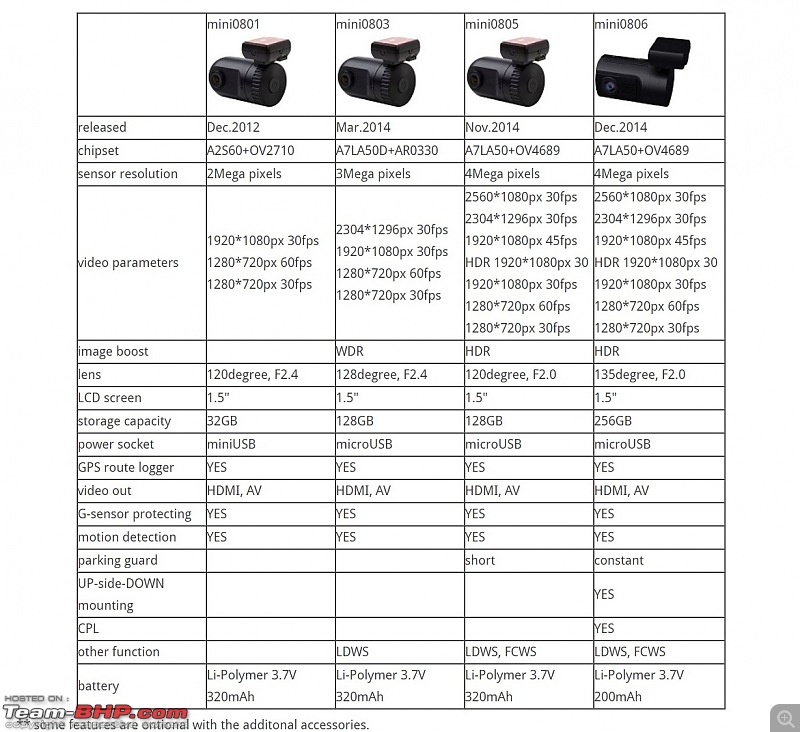

So after the little more research, I found the below points to be tilting in favour of MINI 0806 over MINI 0805.
  • 2 Memory card slots in 0806 whereas 0805 has 1.
  • View angle in 0805 is 120° whereas in the 0806 it is 135° (Not much but felt like an advantage)
  • Cooling issue has been further addressed with more holes on the cover
  • A CPL filter (Reduces glare) in 0806 whereas no such design for 0805
Here is the tabular comparison of the MINI Series:

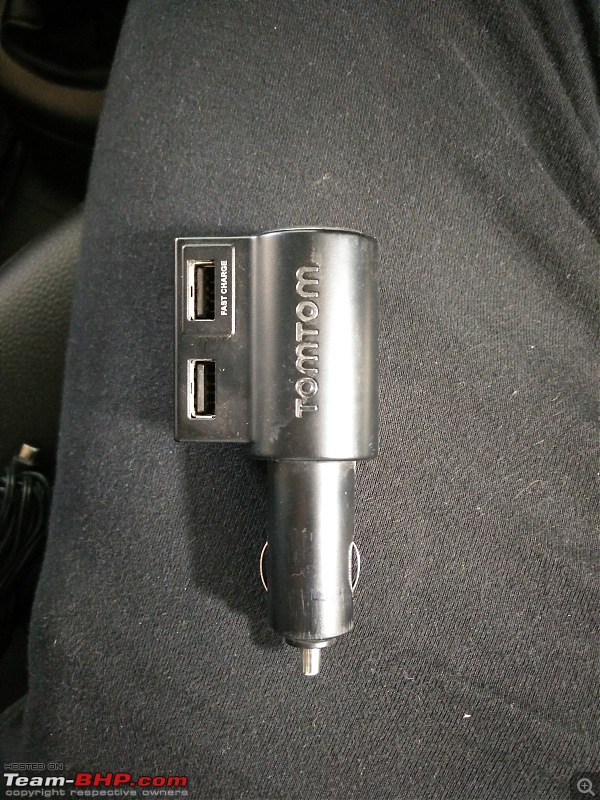

TomTom charger that I use currently
DIY Install & Review - The Mini 0806 Dash Camera-current-car-charger-tomtom.jpg
Car charger provided in the package (Note the USB port)
DIY Install & Review - The Mini 0806 Dash Camera-car-charger-has-usb-port-too-other-use.jpg
I could have used this method as the car charger that I use is a TomTom one that has 2 USB ports and one 12V socket to compensate. The car charger that is provided in the package would fit into that socket in the TomTom one and even then I will have 3 USB ports to use. Since I am the solo user of the car, 2 ports are left idle anyway so there would be no load on the 12V socket.
I didn't choose this method because I wanted a cleaner install and not to clutter the central console with wires routing over/under them. Also I may forget to plug the charger in or someone may pull it off to use to charge their mobiles.

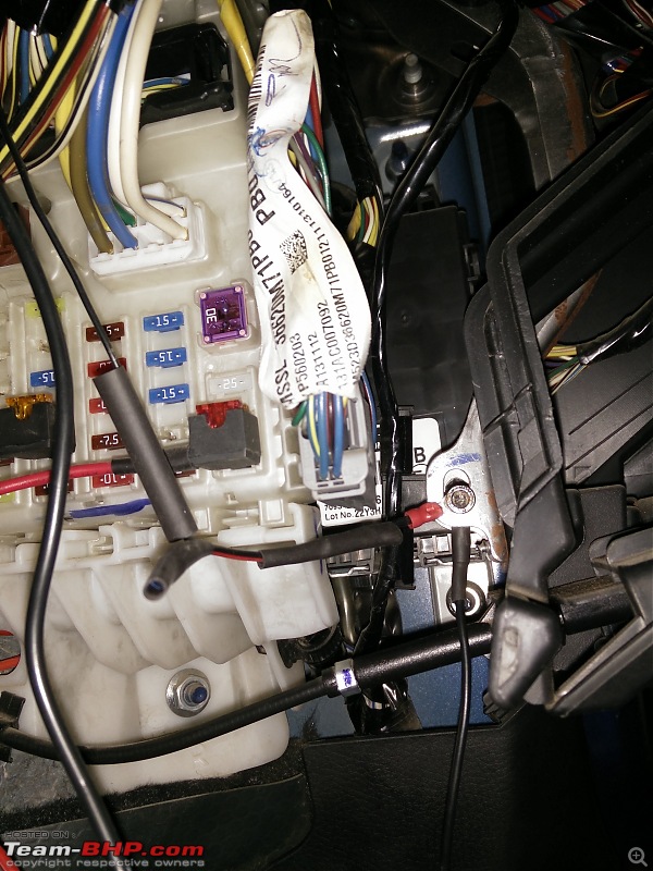

  1. Go to the fuse box and search using the owners manual for a fuse that is "Open/Blank" that can be used for such installation. It is better to use a empty fuse point rather than using a running power line that can go kaput in-case there is an issue in hardwiring.
  2. I am looking for a fuse that would supply power ONLY when ignition is ON so that the dashcam isn't ON always (Would deteriorate overall performance) and also drain my cars battery slowly. Using a 12V Fuse tester pen, I narrowed down on the fuse that I was looking for where the pen lights up upon Ignition ON. In my Swift there are about 12 fuse points that I left blank but out of them only 3 or 4 fulfil the "Ignition ON only" condition.
  3. Once narrowed down, prepare the hardwiring kit for connection.
  4. Open the A-Pillar trim
  5. Decide and fix the camera mount**
  6. Route the wiring from the dashcam mount towards the 12V socket and NOT vice-versa*
  7. Connect the hardwiring kit and also secure the Earthing point
  8. Connect the Dashcam and plug-in the Micro USB port into the dashcam to test for Powering ON
  9. If all OK, secure the extra wiring underneath the dashboard using Zip ties
  10. Refit the A-pillar trim
  11. Clean up the car after all the mess and HAPPY RECORDING

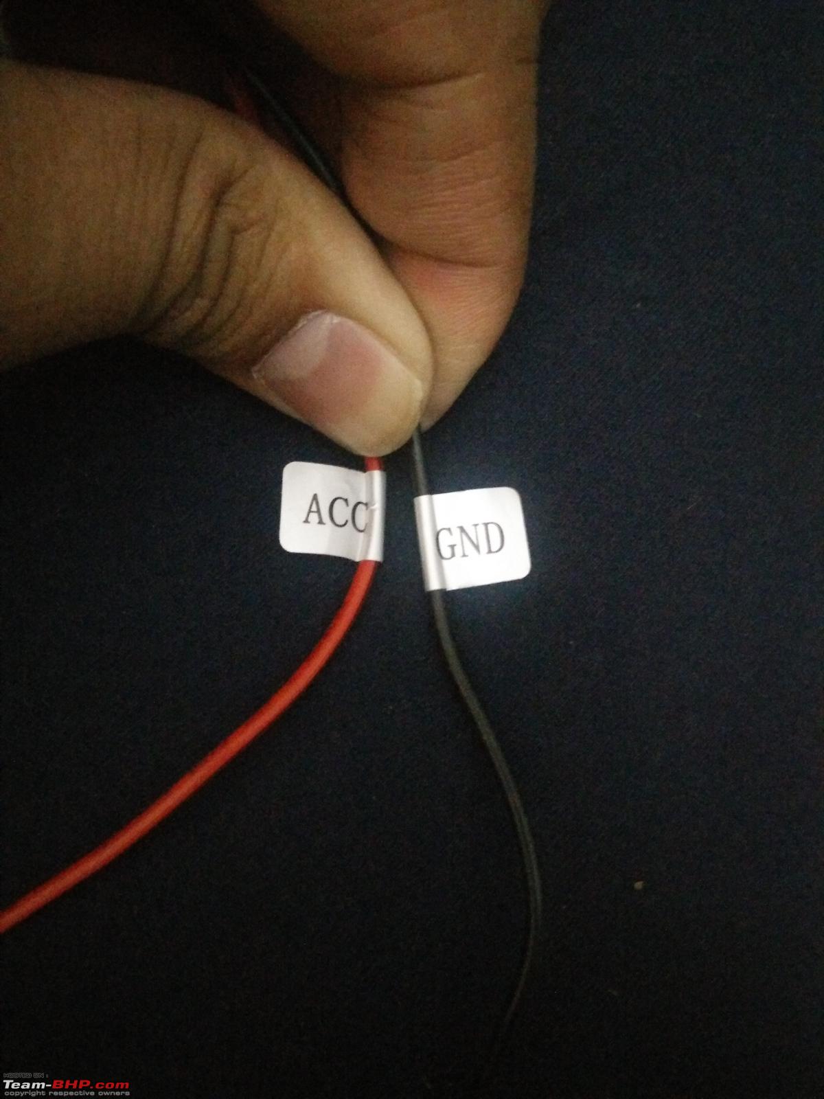

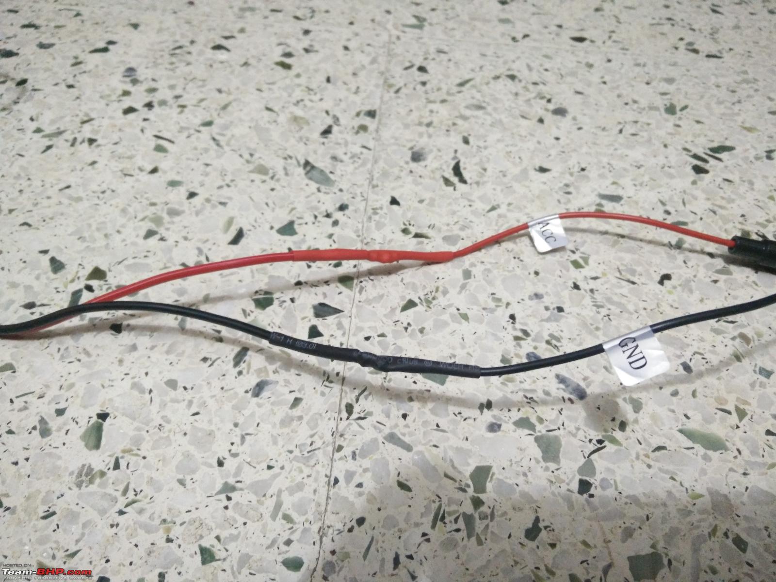

Preparing the Hardwiring Kit:
The kit has two ends:
1) A Micro USB port that connects to the dashcam
2) A Red+black wire to be connected to the power source and earth
Clear labelling on kit which is power source and which is Earth, Neat!
DIY Install & Review - The Mini 0806 Dash Camera-clear-labelling-power-earth.jpg
Earth connection crimped
Power connection crimped
DIY Install & Review - The Mini 0806 Dash Camera-7.-power-socket-crimped.jpg
Wiring connected and heat shrink'ed to the hardwiring kit
DIY Install & Review - The Mini 0806 Dash Camera-6.-acc-gnd-heat-shrinked.jpg
Hardwiring Kit - Labelled what is what!
DIY Install & Review - The Mini 0806 Dash Camera-8.-hardwiring-kit-labelled.jpg

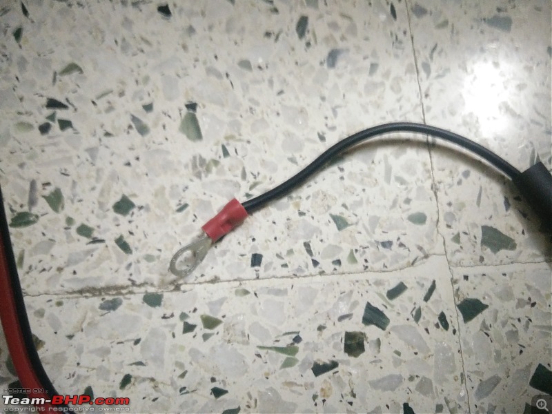

To put it in simple terms, first using a wire stripper, strip some insulation off to get a larger and cleaner source of wiring to be connected. I have used a small extra wire (Thicker) to connect the hardwiring kit and fuse tap cable.
For the Power Connection: Strip some insulation off the red wire and fix it tightly into the butt connector of the fuse tap cable. After getting a tight fit inside the connector, using a crimping tool, crimp the butt of the fuse tap cable to secure the connection we'd just made. Slide in a piece of heat shrinking tube prior to crimping. Using a hot air blower, shrink the tubing over the connection to be safe and clean.
For the Earth connection: Strip some insulation off the black wire and fix it tightly into the ring terminal that I using from the set of terminals that I have. This ring terminal will then be plugged into the car metal body point to act as Earth in the whole connection. Since I have already hard-wired my Auto-dimming IRVM previously, I will be using the same earthing point in this install too.

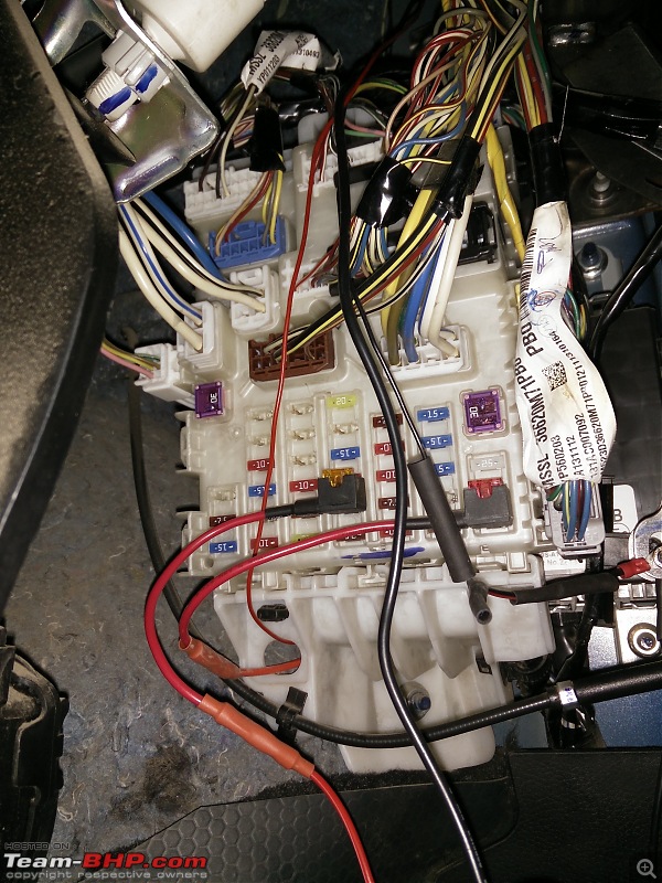

Fuse to be tapped from the fuse box:
DIY Install & Review - The Mini 0806 Dash Camera-3.-bcm-owners-manualtile.jpg
Checked and confirmed on the fuse using the 12V fuse tester pen
Way to route the hardwiring line - Through the dashboard
Wiring kept ready to be routed through A-pillar
DIY Install & Review - The Mini 0806 Dash Camera-14.-hardwire-kit-routed-through-apillar-fuse-box.jpg
Routed through A-Pillar and secured using wire holder clips
DIY Install & Review - The Mini 0806 Dash Camera-9.-wire-holder-clips-3-nos.jpg
A close-up of the wire holder clips
DIY Install & Review - The Mini 0806 Dash Camera-10.-wire-holder-clip-closeup.jpg
5A fuse in the fuse tap cable (Fuse rating on the converter box is 1.5A so went double of that rating hence using a 5A one)
Fuse tap cable connected in the chosen fuse (Note the first fuse tap present that is for the Auto-dimming IRVM)
DIY Install & Review - The Mini 0806 Dash Camera-12.-dashcam-fuse-tap-connected.jpg
Earth connected to the same point that I used for the Auto-dimming IRVM
DIY Install & Review - The Mini 0806 Dash Camera-13.-earthing-connected-same-point.jpg
Mount fixed on the windshield after a lot of trial

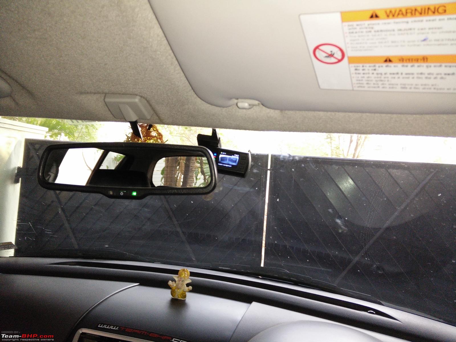

DIY Install & Review - The Mini 0806 Dash Camera-15.-position-fixed-trial-connection.jpg

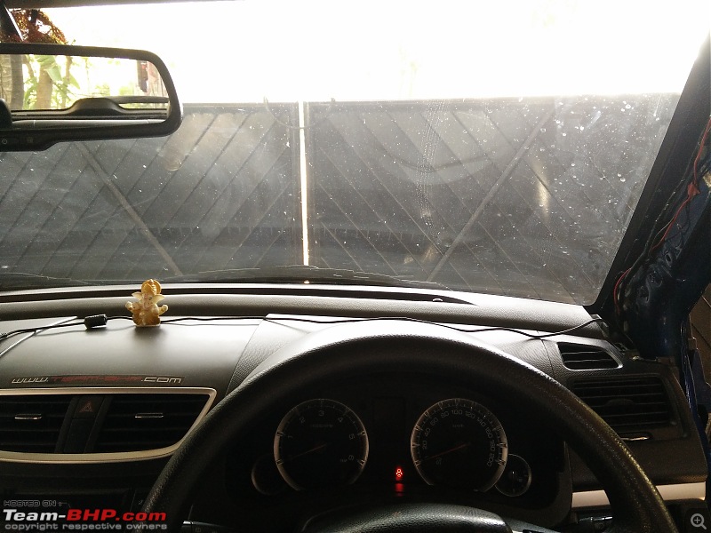

[b]Test shot after hardwiring[ - All Good!!/B]

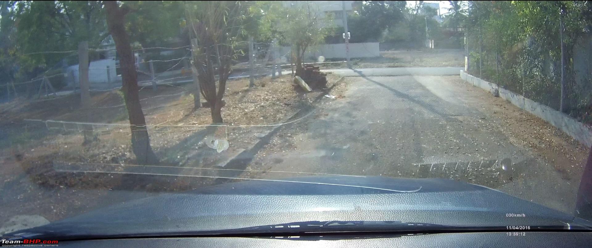

Driver's View
DIY Install & Review - The Mini 0806 Dash Camera-17.-test-shot-after-hardwiring.jpg

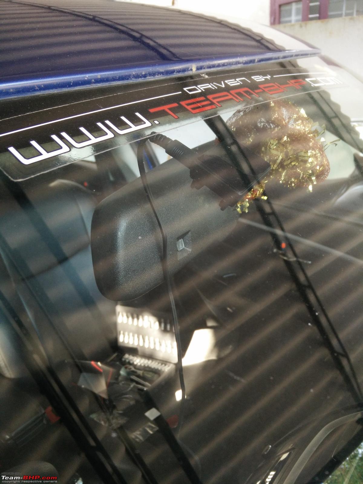

View from outside
Closeup shot of the dashcam from outside
DIY Install & Review - The Mini 0806 Dash Camera-19.-view-outside-closeup.jpg

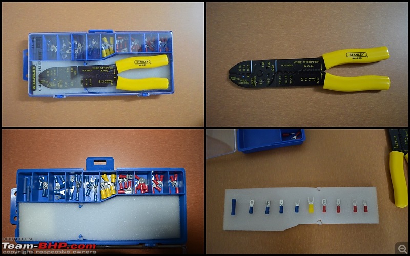

Crimping Tool
DIY Install & Review - The Mini 0806 Dash Camera-5.-stanley-crimping-tool.jpg

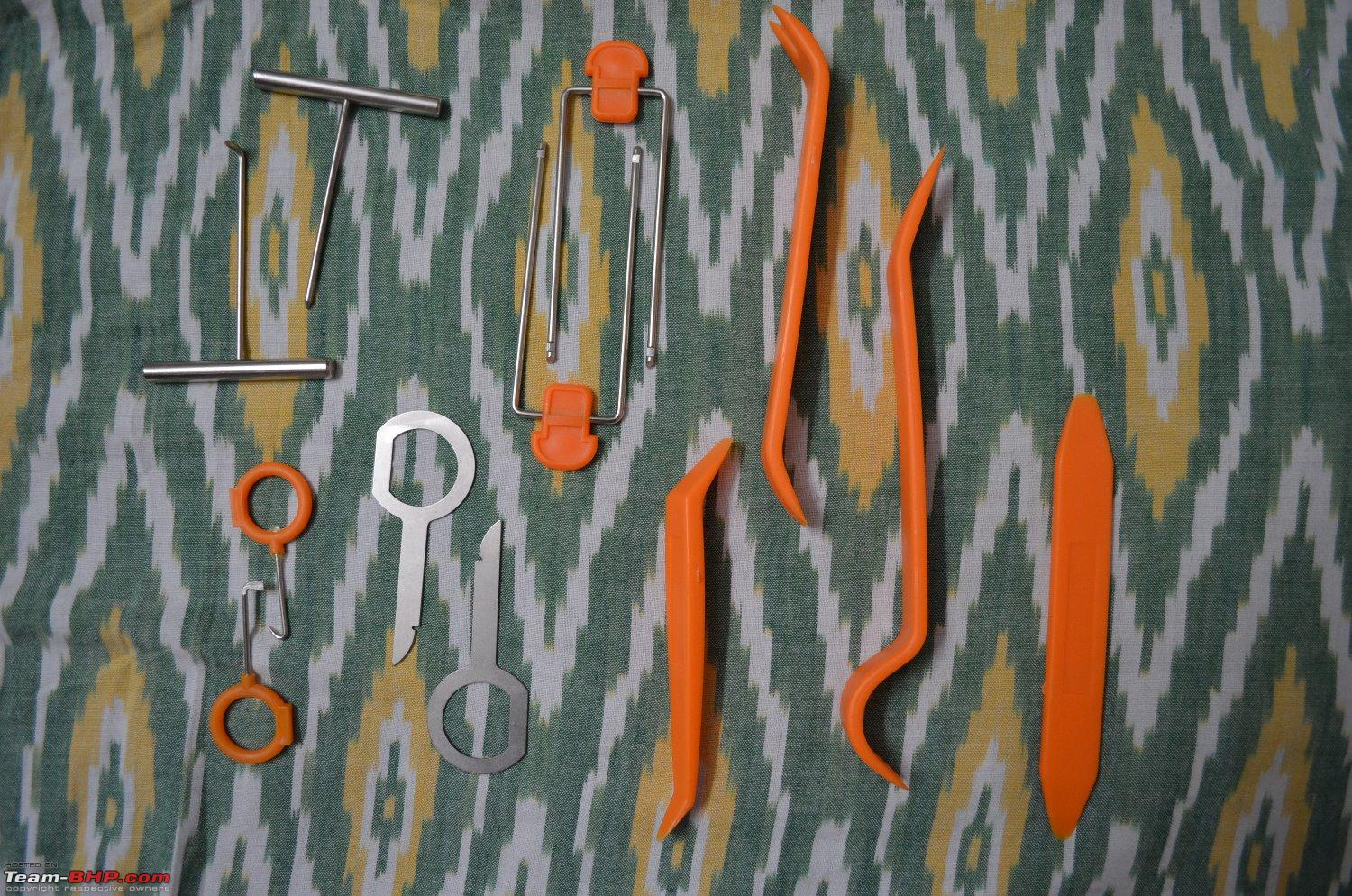

Car panel/trim removal set

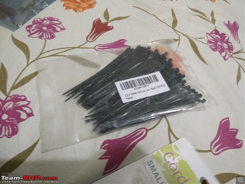

Zip ties

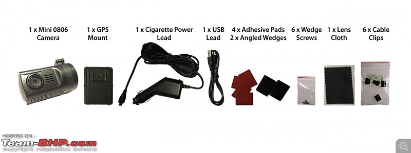

Contents of the Package

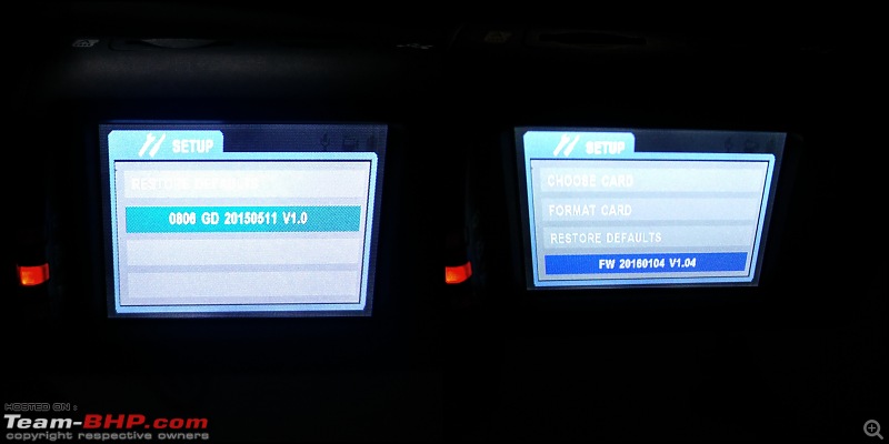

Firmware upgraded today evening - Old v/s New
DIY Install & Review - The Mini 0806 Dash Camera-firmware-version-old-vs-new.jpg

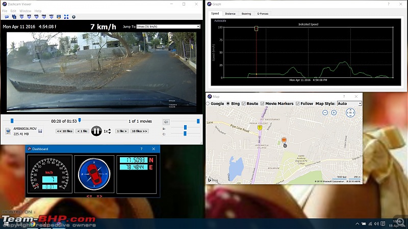

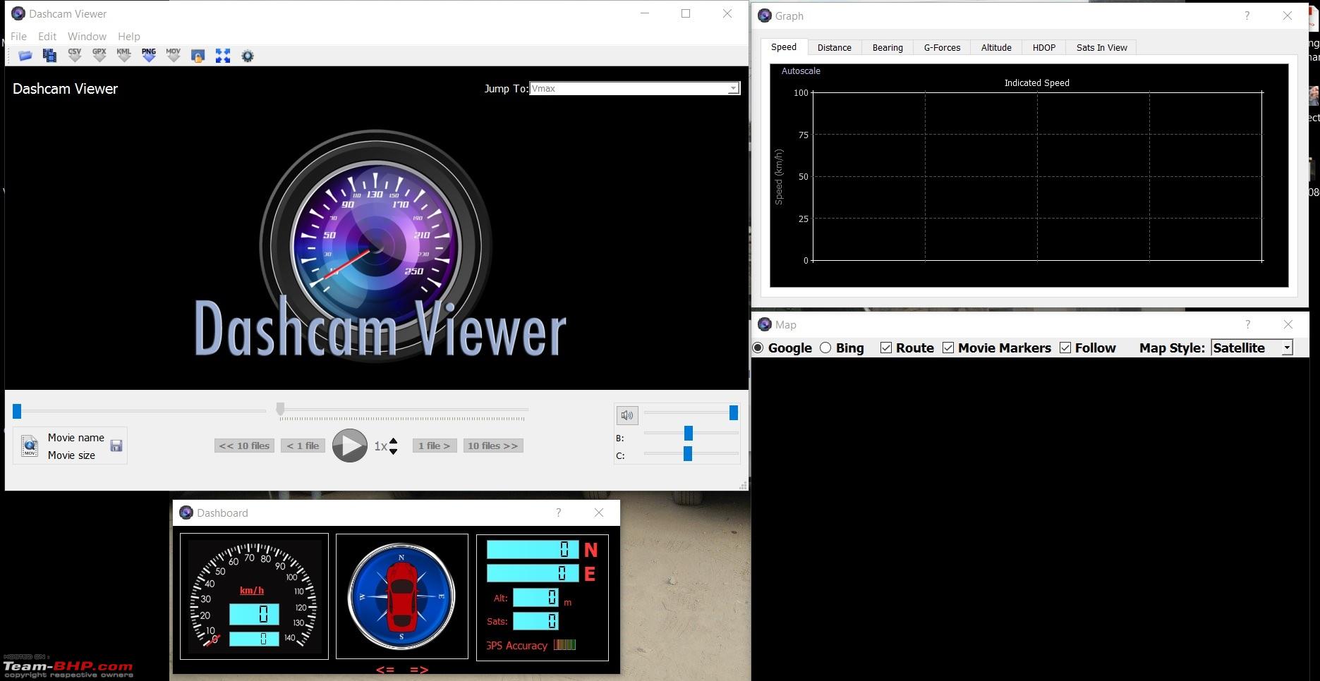

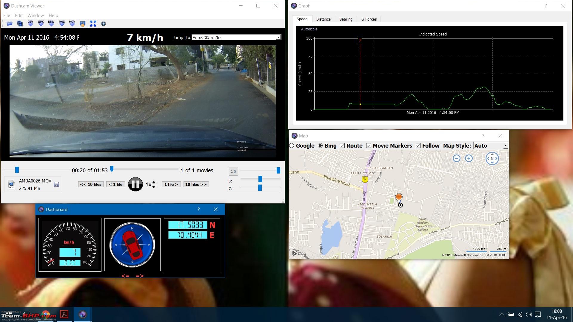

1) Video playback Software:
I use the software named 'Dashcam Viewer' which gives out data of GPS, speed, maps and video itself in 4 different windows. Since this is a paid software ($15), I am using VLC player currently.
What the Dashcam viewer offers me (Taken from Dashcam viewer website):
  • Speed, distance, and time display.
  • Compass heading,
  • Latitude and longitude.
  • The Map Window animates to show the current position of the vehicle against a map background. The route line is color-coded based on the vehicle's speed.
  • Plot Views show the time history of vehicle speed, distance, compass direction, and G-sensor (shock) data for all the files loaded.
Link to website: Dashcam Viewer
Dashcam Viewer Dashboard
DIY Install & Review - The Mini 0806 Dash Camera-dashcam-viewer-dashboard.jpg
Sample 1
Sample 2
Sample 3

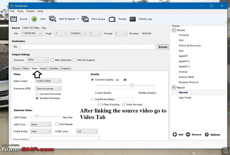

2) File Size Reduction Software
With file sizes ranging from 200MB to 500MB, uploading videos on YouTube becomes a pain so a file size reducer software is a MUST. Moreover the slow internet speed at home doesn't help matters either so I chose this after reading reviews online.
Handbrake is the name of the software which I am using to reduce file sizes drastically without affecting video quality to a large extent.
Link to website: Handbrake Software
Handbrake Dashboard
Process to reduce size:
DIY Install & Review - The Mini 0806 Dash Camera-after-upload-go-video-tab.jpg
Next step
Before vs After - File Size reduction process

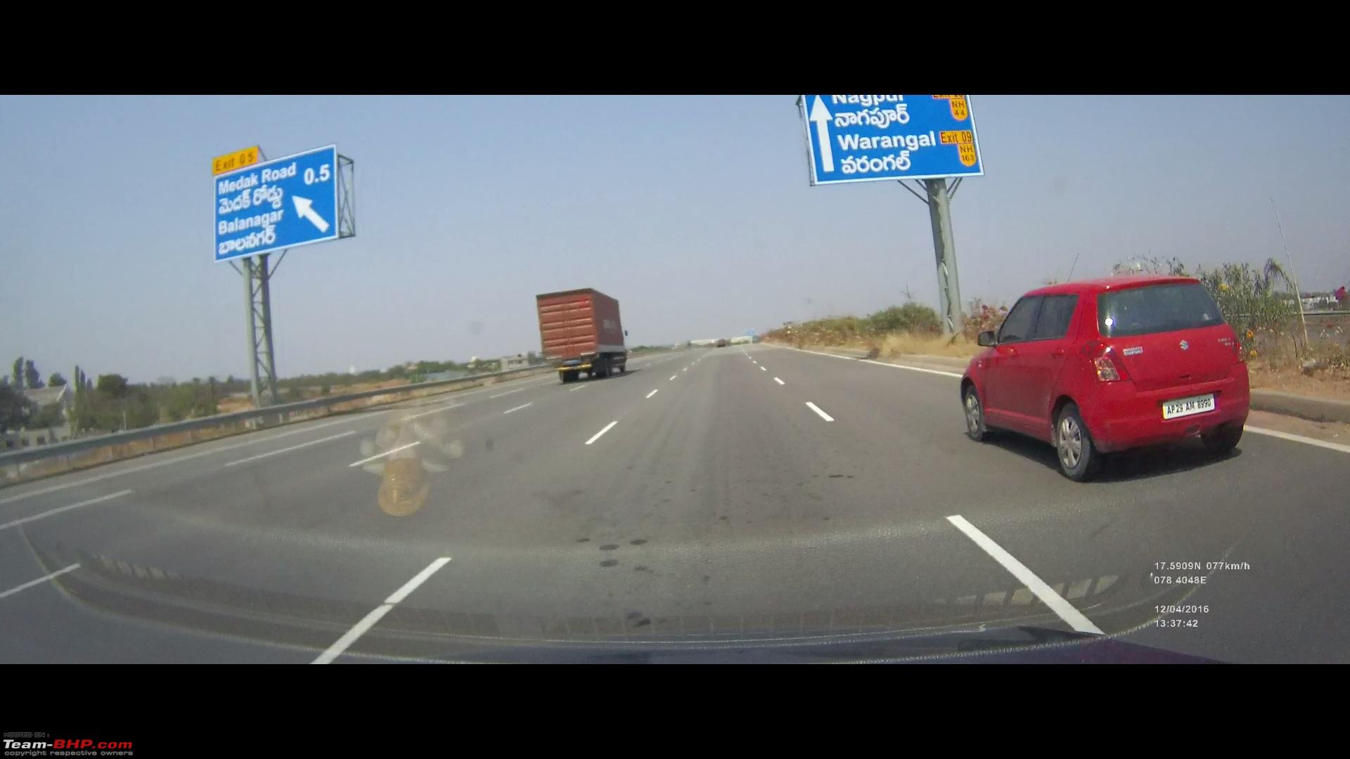

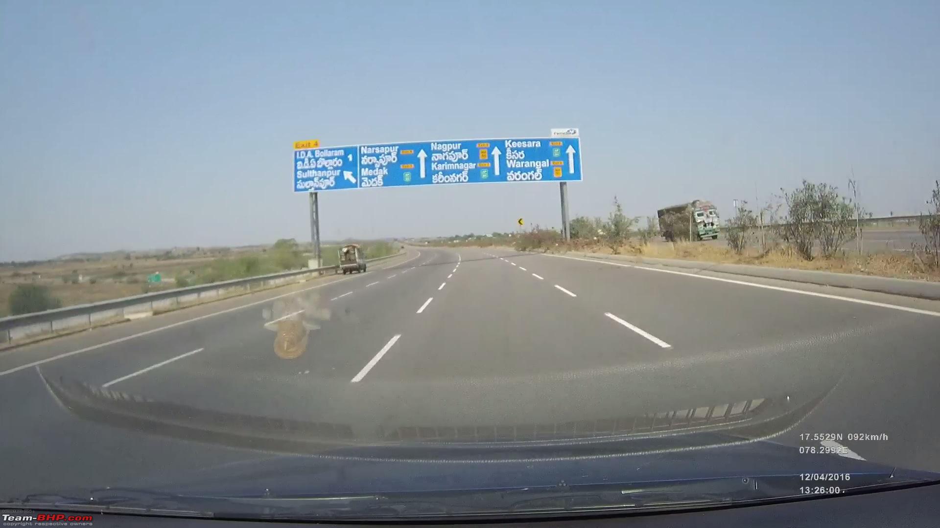

Here are a few image screenshots from the videos describing the read-ability of number plates.
Afternoon time

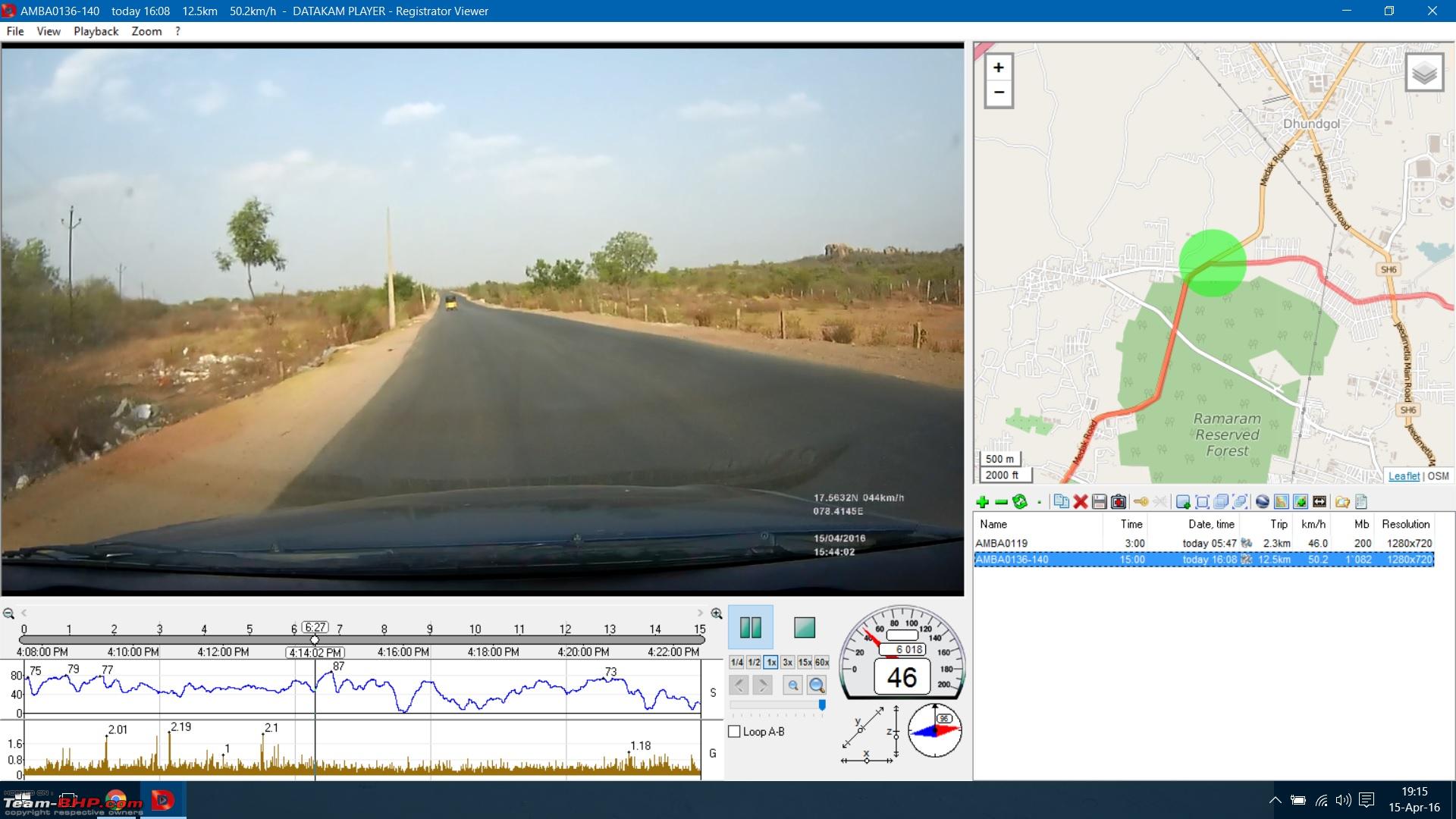

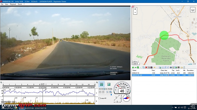

Originally Posted by rkg View Post
Yeah. Registrator viewer only
Hello buddy,
I did try the Registrator Viewer and it is good.
Thanks buddy.

Its Ok. The beauty of this SW is it automatically adds up all continuous files in to one single file and plays it. If you have 3 minutes clips each for 2 hours, it makes it a single file of 2 hours and plays it.
I have read in some forum ( may be dash cam talk) that the author has died in a road accident. He is from soviet block
